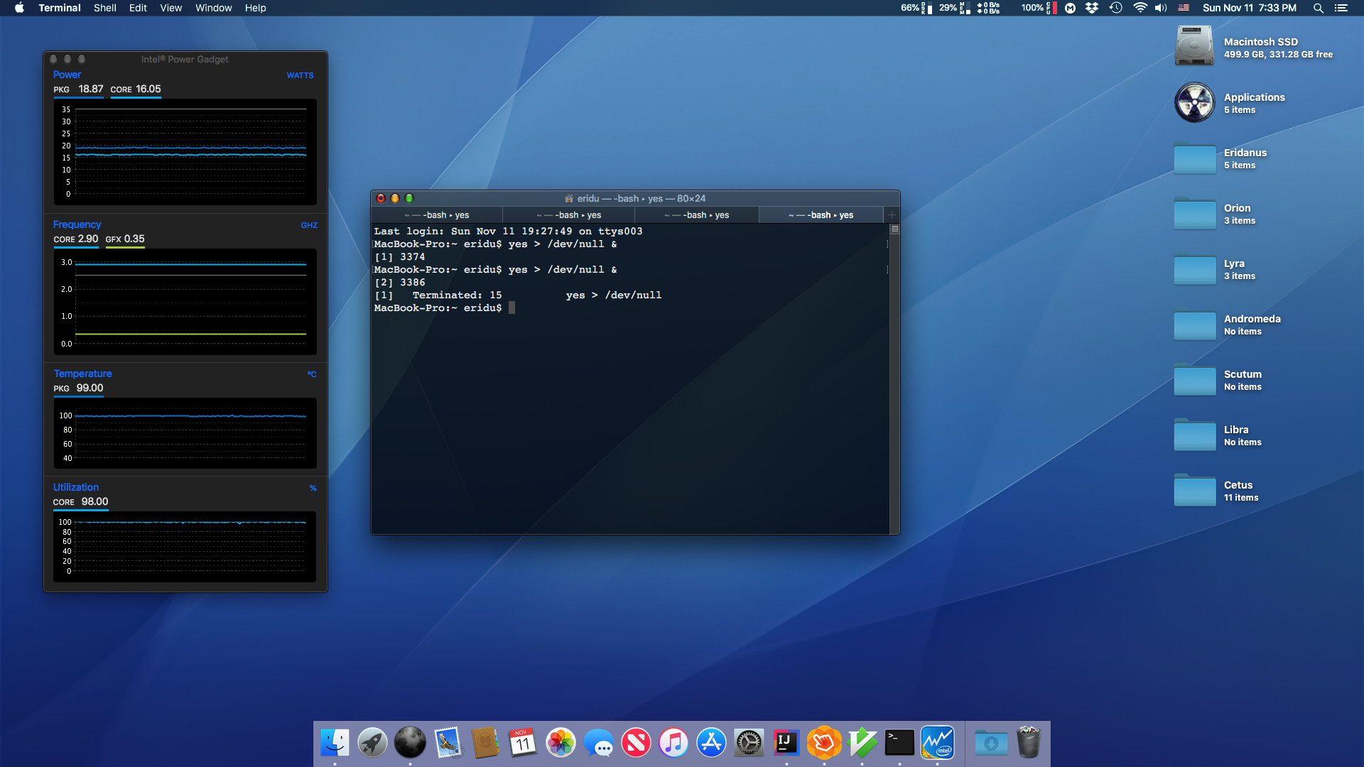

Anyone has tested turboboost frequency when 2/3 cores are under load?
I7
Utilization - Temperatur - Frequency
99.50 - 97.00 - 3.70
66.10 - 96.70 - 3.80
49.50 - 97.80 - 4.00
33.10 - 98.50 - 4.30
3.0 - 44.80 - 1.40

But if I’m reading that right that could be all cores at 99-66-50-33% utilization.
Also are thise using igpu or egpu? I just found out that igpu alone should be 15w TDP, a nice reliefe for the cpu.

Id like to point out the temps are very close between the i5 and i7. So everyone who says i7s run hot.. well there you go.
