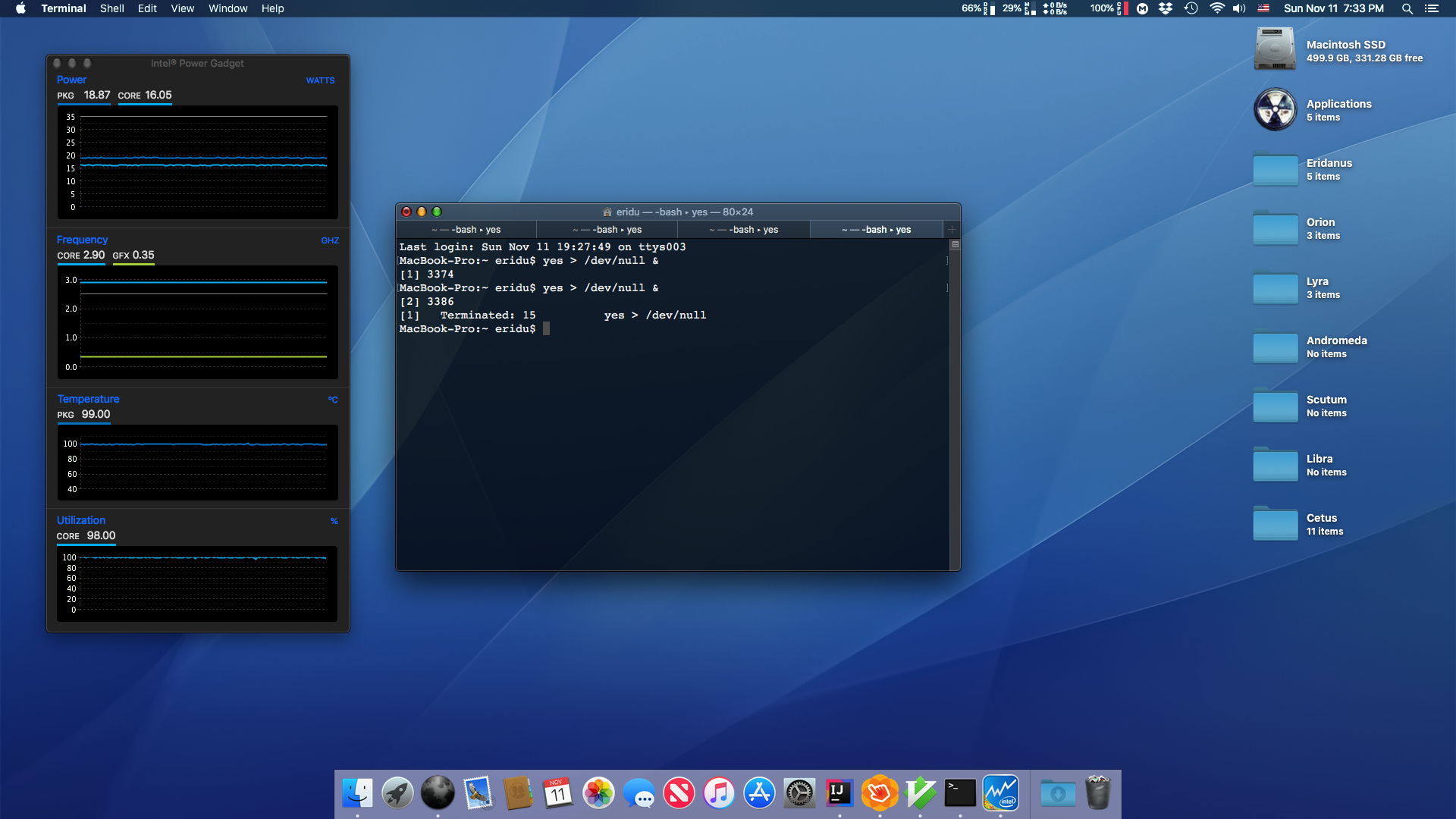

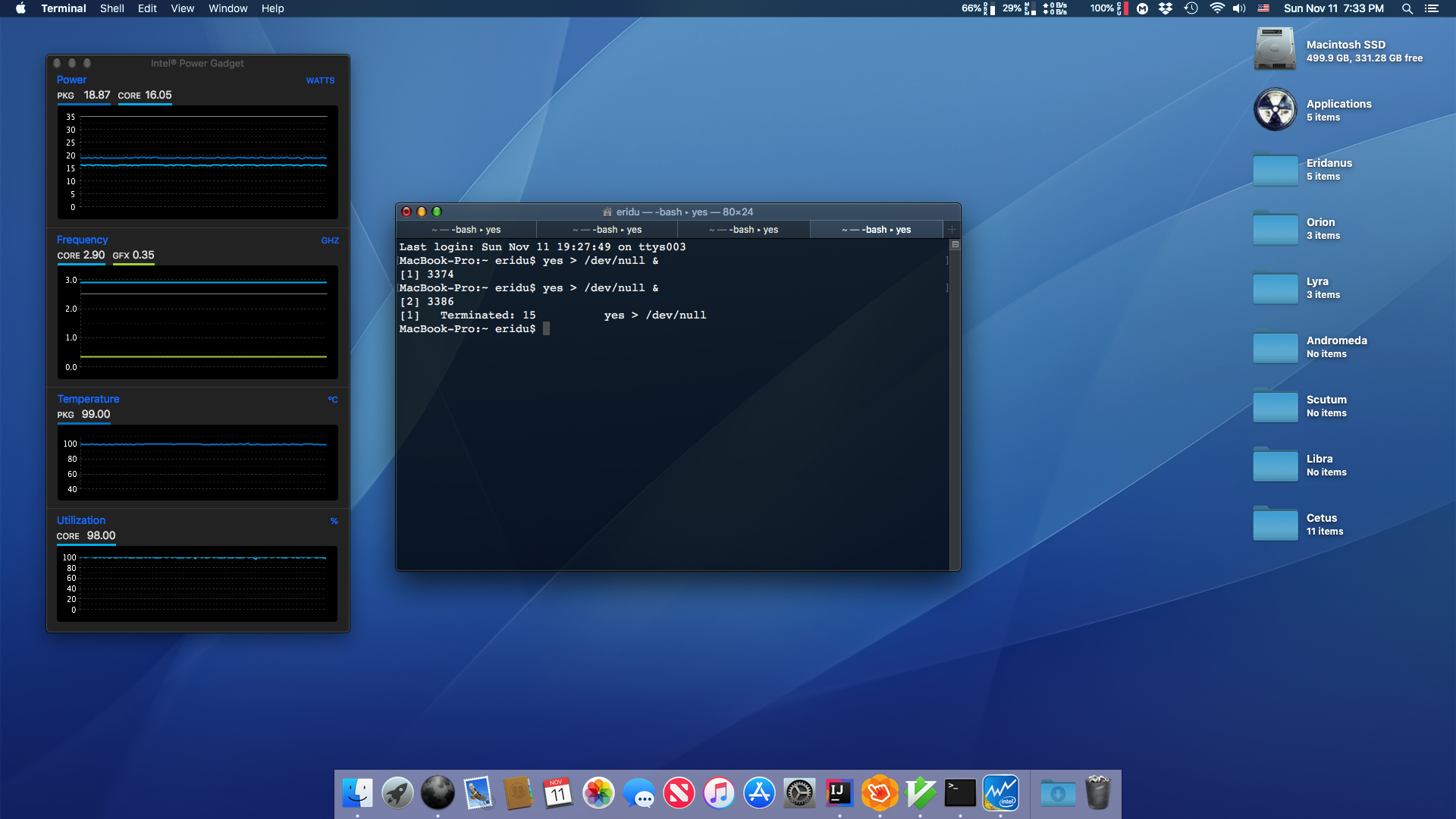

Since when is the Intel implementing thermal throttling? I just played a little bit on my ancient machine (mid 2012 i5 MBP), I tried to artificially stress it as much as possible using good old yes command. Although the temperature is even surpassing 100 degrees Celsius, the CPU refuses to reduce clock speed to protect itself. It stays firmly above base clock speed, and refuses to slow down. Are older Intel CPUs incapable of throttling?
EDIT: Mea culpa! The T junction temps for i5-3210M is 105 degrees Celsius, not 100.
