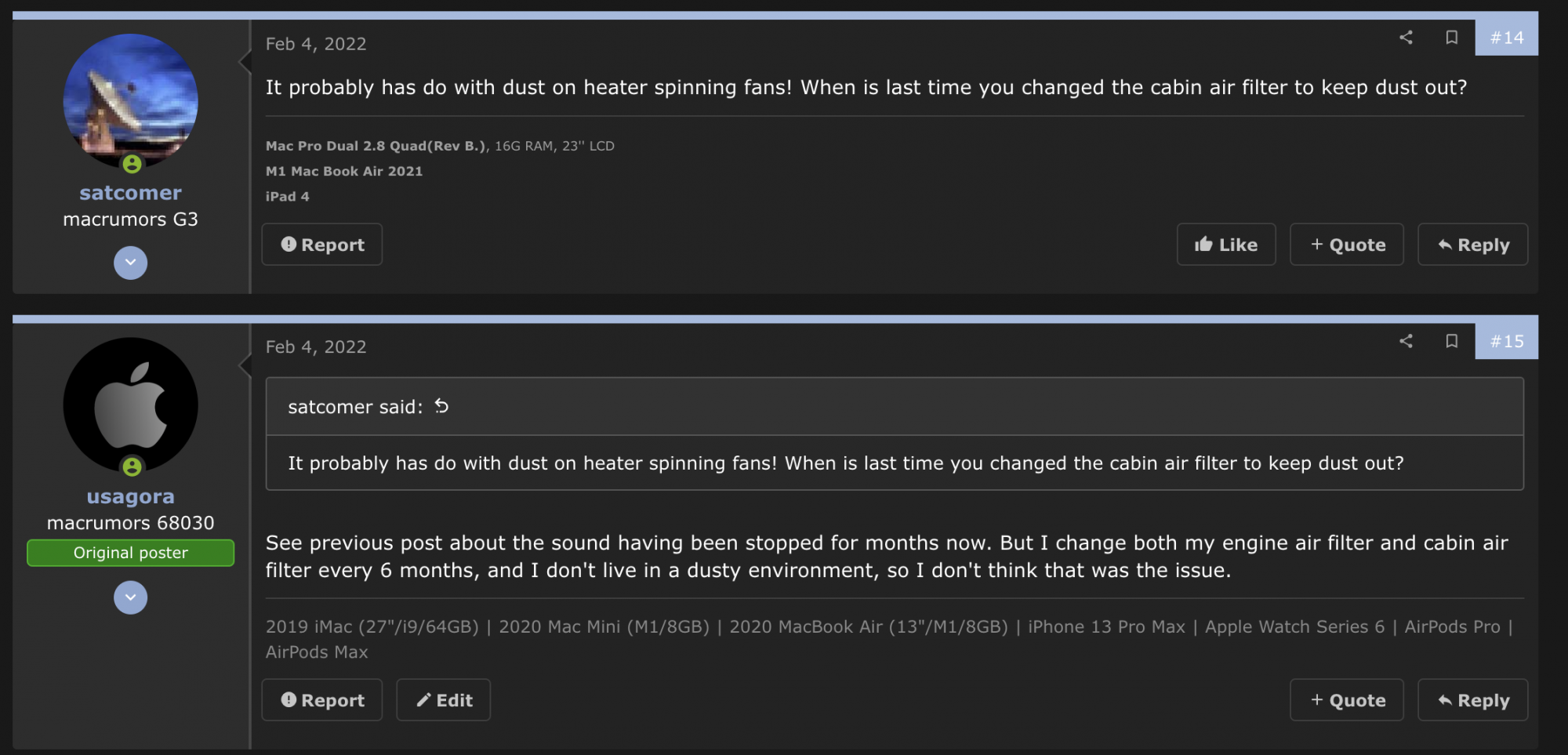

It probably has do with dust on heater spinning fans! When is last time you changed the cabin air filter to keep dust out?
See previous post about the sound having been stopped for months now. But I change both my engine air filter and cabin air filter every 6 months, and I don't live in a dusty environment, so I don't think that was the issue.
