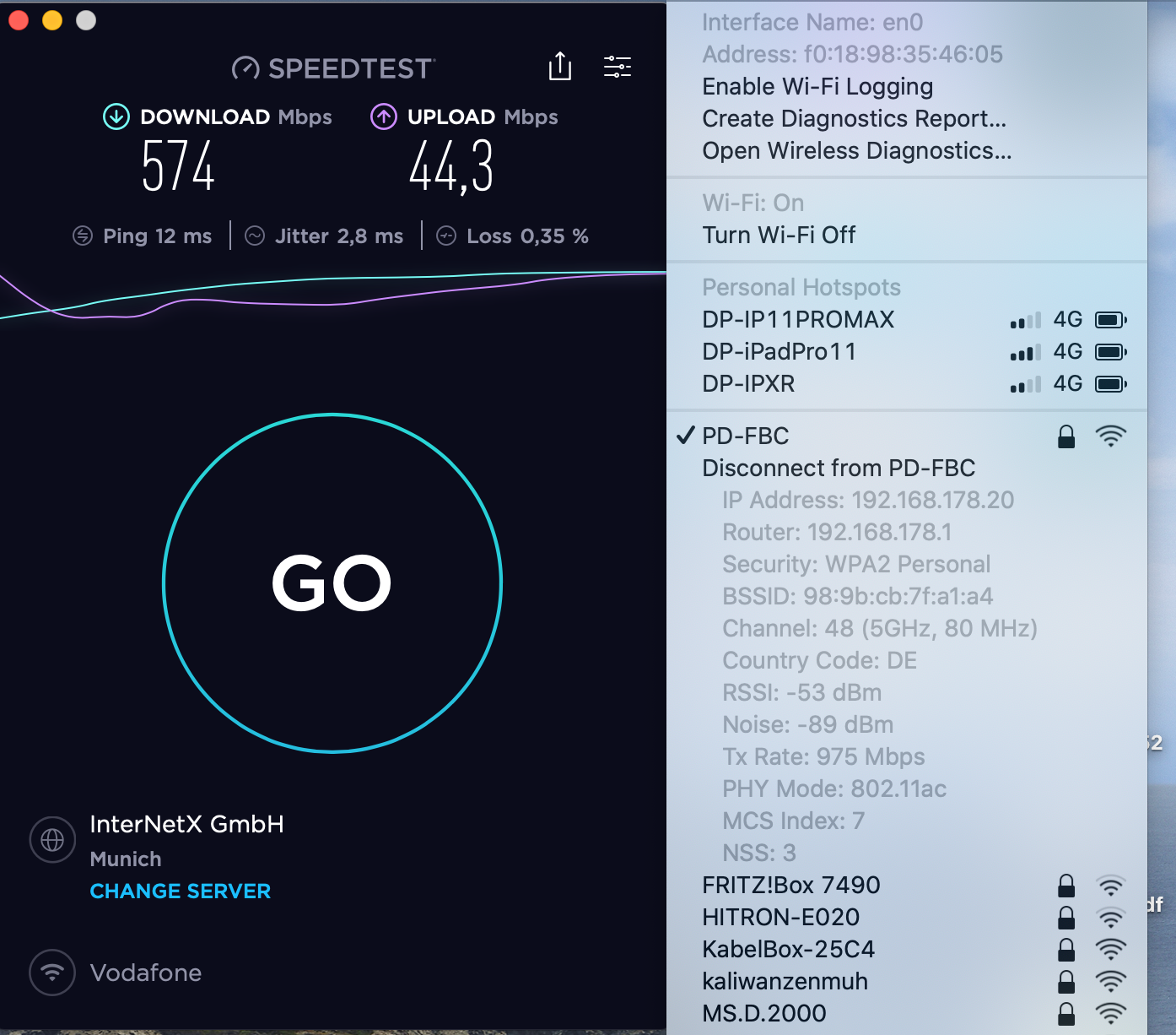

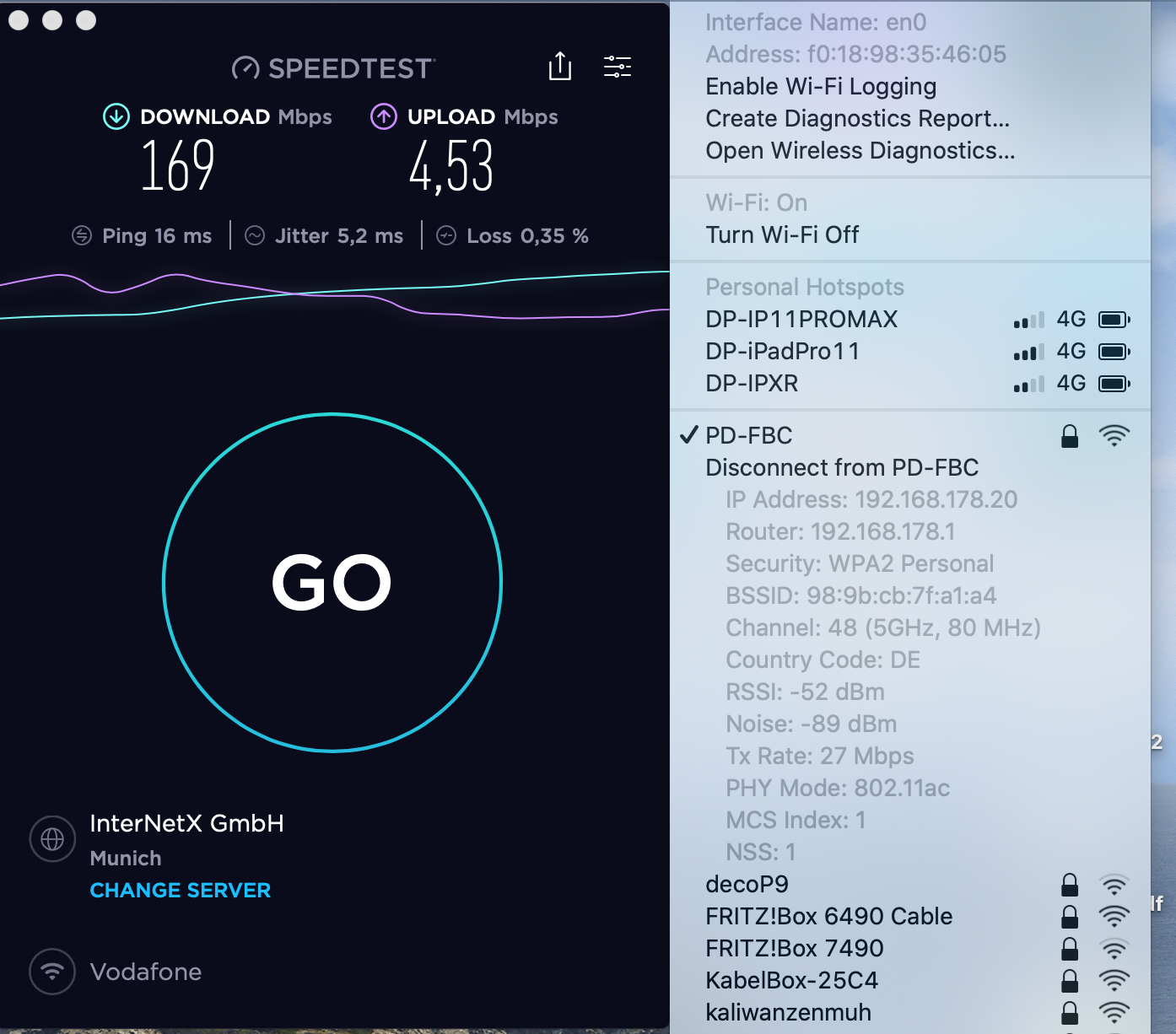

It's a difference between the TX Rate and the actual rate... i have exactly the same behaviour with the current OS. I have a 1Gbit connection and it will slow down from 600 to 150 but additionally everything seems to be slower e.g. open a youtube video (it can even buffer). The Problem will not occur immediately after activating apple watch unlock - sometimes its 30 Minutes sometimes a few hours. So this make it very hard to demonstrate it in a genius bar.
Usually if the problem occurs the tx rate shows weird numbers like 17 or 27 (just press option and click on wifi symbol).... (in the screenshots there are just some seconds between - same wifi, same signal)

Thank you, I've been able to reproduce similar results to what you post above.
