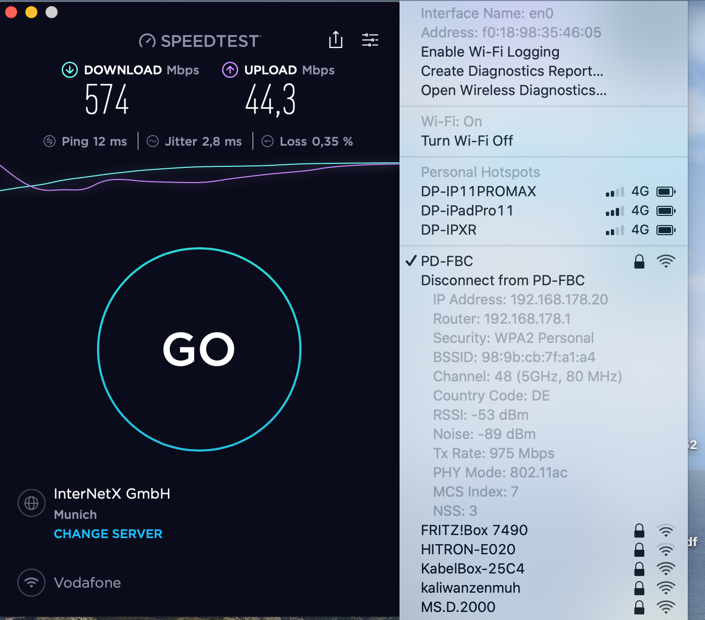

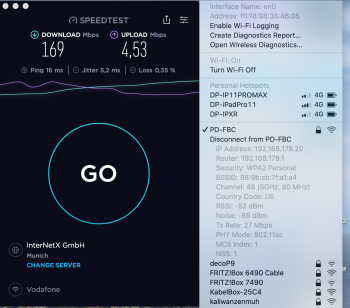

You can get details by pressing the option key if you click on your wireless:
As you can see there is no signal problem. But the tx rate is locked in this case to 27Mbps. Sometimes it shows 13 or 14Mbps.
And even if the tx rate can change for a few seconds it will always fall down to this number a few seconds later.
After turning off and on the wifi you can see the tx rate is back to 975Mbs and speed is back to normal.
