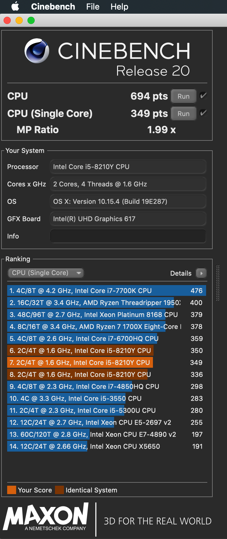

Guys final conclusions of the 2019 MBA:
The best solution is to add those copper plates to better dissipate the heat to the refrigerator and cover all the holes where the air can escape. It is not worth transmitting heat to the back plate, nothing is gained and it gets hot. The last thing I have done has been a rubber semicircle around the turbine so that no air passes behind the fan.
Now seriously it goes fast of noses! not only because the performance tests say so, but also because it works cooler with all applications. Right now without a fan and writing this marks me 38º, I just finished seeing 90º or 100º ...
I think that more can not be removed at least without breaking something and losing the warranty.
I leave you the last test.
A hug to all! and lots of health !!!
PS: you can compare the data that it gives of origin since I don't have it.

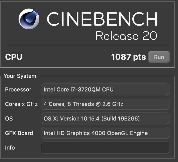

OTOH, here's my 8 year 2012 rMBP 15 that's still chugging along...
The 2020 MBA i5/i7 is basically neck and neck vs. my ancient MacBook Pro while weighing almost 40% less and superior battery life. Even the GPU is superior as I had to hack the rMBP 15 to disable the defective Nvidia dGPU as it's no longer working...

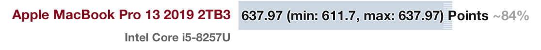

See here for notebookcheck.net's Cinebench 15 results:
I had that MBA and it was awesome. Within 10% of the MBP while being lighter and much cheaper

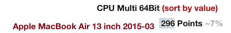

Compare to 2020 MBA vs 2019 MBP 13
A whopping 40% slower when pushed. (I'm comparing 363 vs 611.7 when the MBA is heat soaked from it's less than adequate cooling system
I have the i7 2020 MBA and it's only barely 7% faster than the i5 in Cinebench. Not even close...
