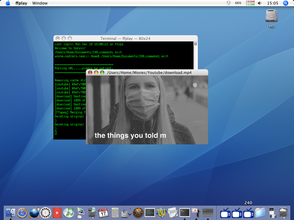

The 3 scripts offer playback at 144P, 240P and 144P without framedropping which is a more pleasant quality.
After searching for your video in Choob, press shift-cmd-u to copy the video url, then click your desired script shortcut in the Dock.
Youtube-dl within PPCMC will then download both the video and audio, then 'splice' these together before opening in ffplay - this is much quicker than converting the files to another format (especially on a G3.)
After playing the video is deleted.
A word of warning - not every video on Youtube will be available in the formats this utility employs, so there may be errors but as you can see in the screenshots, 66% CPU on a 500Mhz G3 iMac for 240P video with high quality m4a audio isn't too shabby!

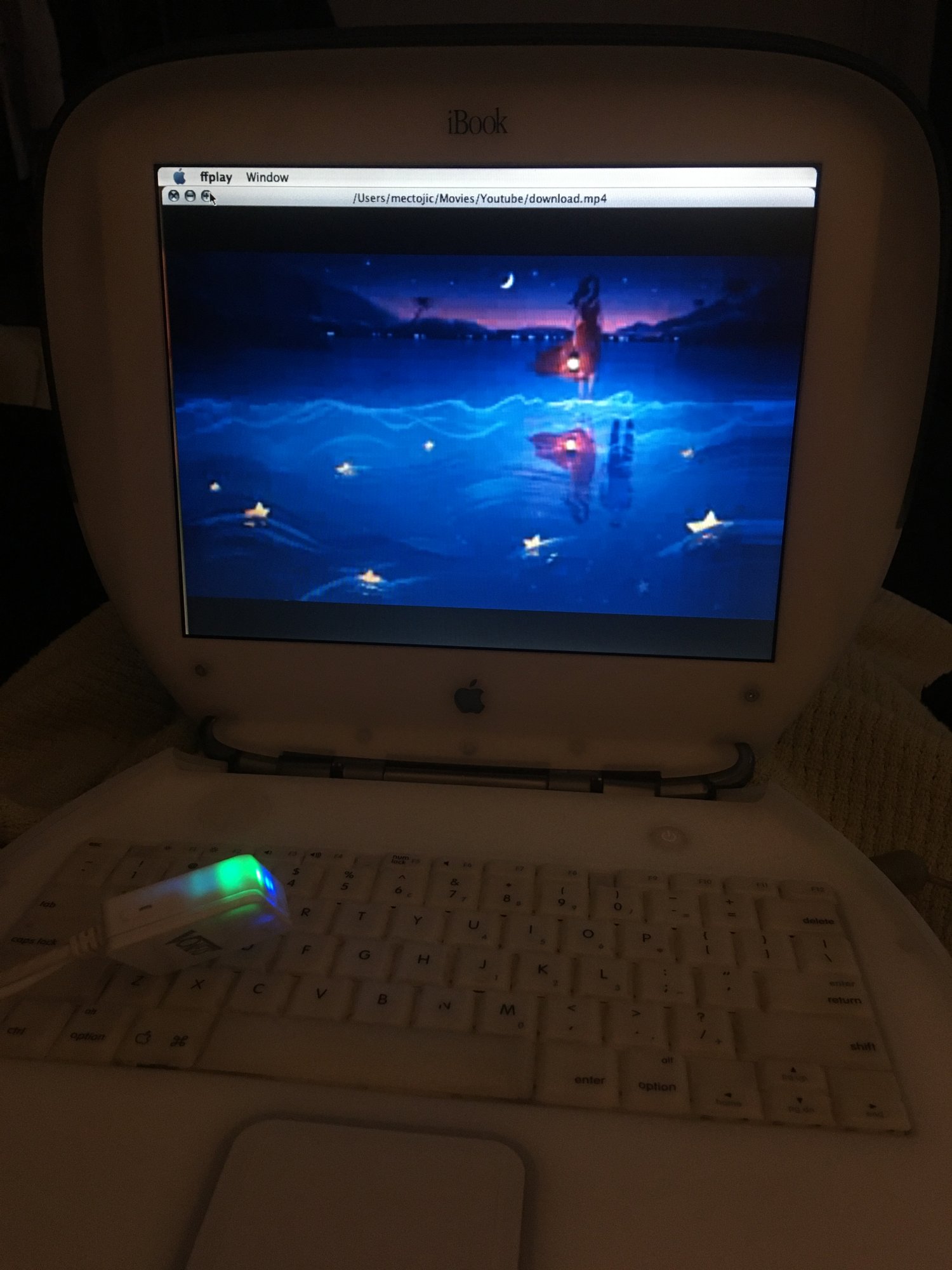

As a new member to these forums, I was keeping a low profile and getting frustrated trying to follow all the different procedures on here from years ago. I had suspected they would not work, but I kept trying anyway.
Thanks so much for sharing a working method. It was easy to use and simple. This is on my 466 Mhz iBook Clamshell with 576 mb ram, and I can confirm it will run fullscreen, framerate a little low @240p. I'm determined to do as much as possible on this laptop, and you've just added a ton of functionality.
Here's an example, playing some music on Youtube. Nice and atmospheric! Playing @144p only requires 30% CPU, so I can smoothly do anything else on the laptop.

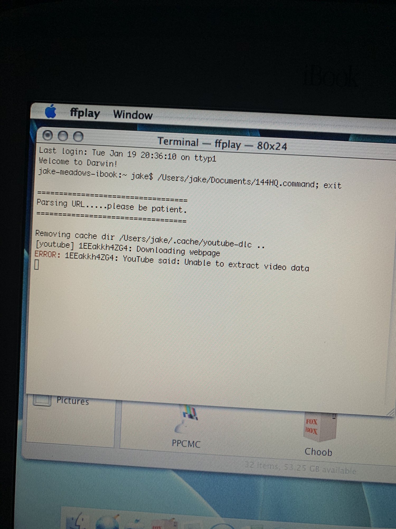

help! followed instructions... everything seems to work until the very end, i get this error and the terminal closes.
ERROR: YouTube said: Unable to extract video data
on an iBook G3 300mhz running Tiger (Trimcelerated)
Am I missing something here?
