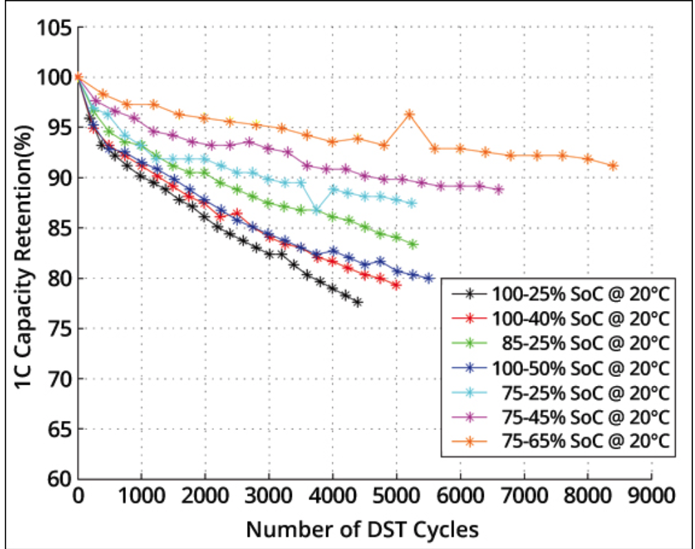

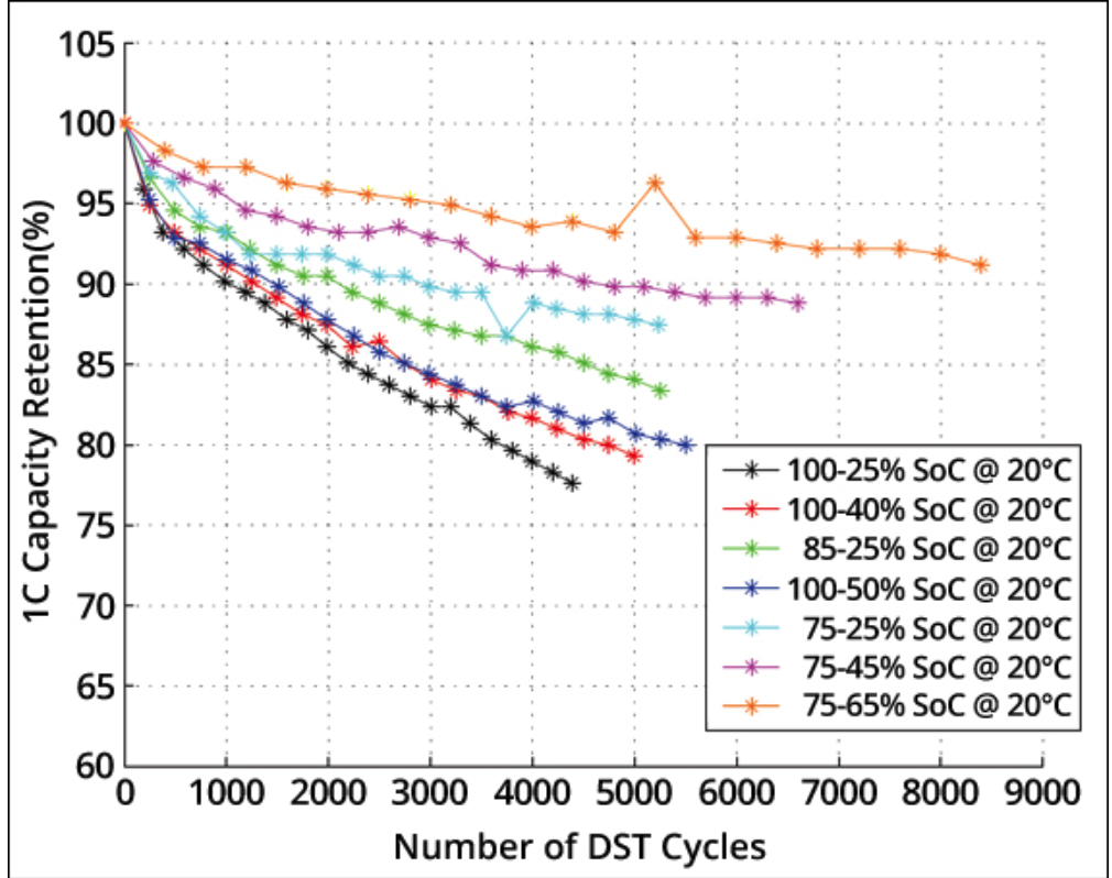

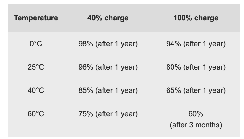

You probably won't see the difference between a 5w charger and a 20w charger in a 1-2 year timeframe.
Better for your battery is to keep your charge level between 80% and 40%. Going above 80% and below 40% has far worse detrimental effects.
(Battery University) ---75-65% is even better (as well as 75-45%).

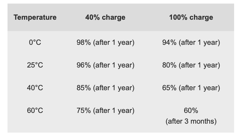

Yes, cooking your phone in the sun will harm the battery more but charging at 20w vs 5w won't have much of a difference over a 1 year to 2 year timeframe.
My battery, charging on a 100w charger (USB C to Lightning via MacBook Pro) right now is at 23.2C.
Note that while charging, your battery is only at these elevated temperatures for short periods of time - the above graph is constantly kept at said temperature for the life of the battery. The diff between 0C and 25C is negligible (14%) - and that's a constant temperature. In real life, you're not going to see much of a difference unless you keep your phone for 3+ years.
View attachment 1706062 (Battery University) ---75-65% is even better (as well as 75-45%).
View attachment 1706057 (Battery University)
Indeed, it’s about duration with some exceptions e.g. a battery at 450°F/232°C or a true 0% charge will incur severe damage, perhaps to the point of unusable. Always at 50% is optimal.
Basically, the bigger deviation, lower or higher, from 50% charge and ~55°F/12°C at longer and longer durations the greater the cell degradation. Essentially, what’s depicted in the table.
