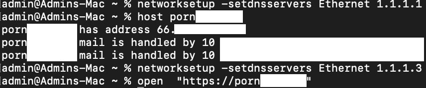

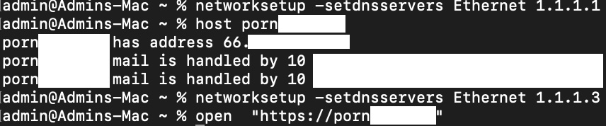

1.1.1.1 is the main Cloudflare DNS server, 1.1.1.3 is the one that blocks malware and adult content. You will figure out the rest 🙂
thanks a ton!
so will that -setdnsservers, which i guess will be the same as if i did change the DNS in the macOS network settings, completely override the DNS server settings of my router?
thanks, i was using ping and traceroute, but in the end, if i'm not feeling laggier connections i'm fine with it.
before this query, i was using my ISP router's default DNS, now i've set that to Quad9 for the moment, but it's nice to know that you can easily change that with a simple change of your network location👍

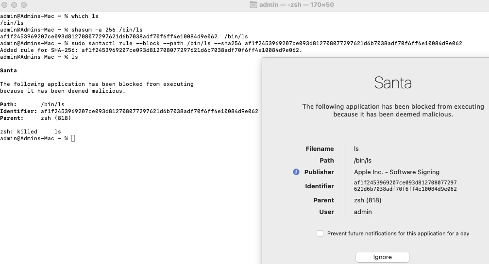

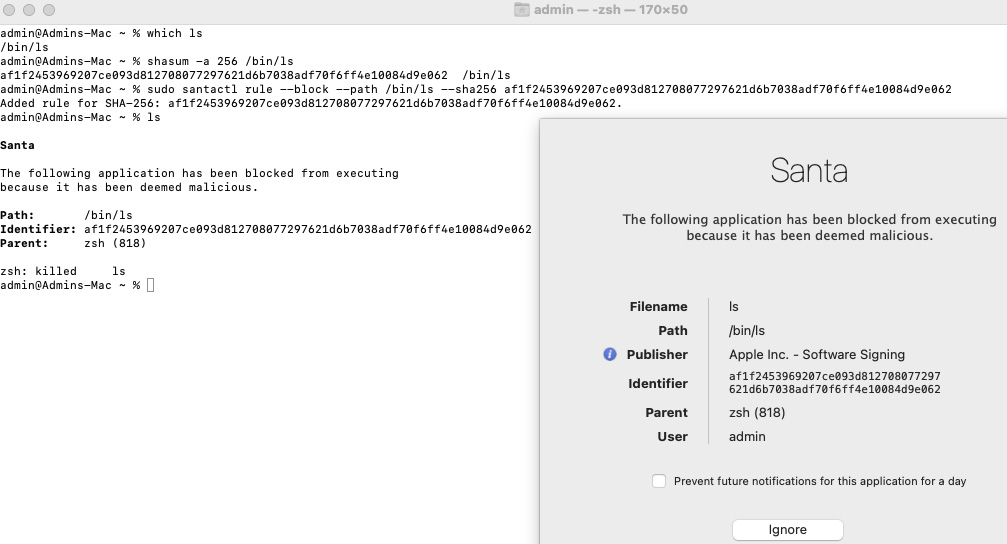

Blocking ls from executing
Code:
which ls
shasum -a 256 /bin/ls
sudo santactl rule --block --path /bin/ls --sha256 af1f2453969207ce093d812708077297621d6b7038adf70f6ff4e10084d9e062
sudo santactl rule --remove --path /bin/ls --sha256 af1f2453969207ce093d812708077297621d6b7038adf70f6ff4e10084d9e062

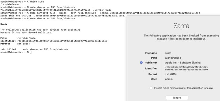

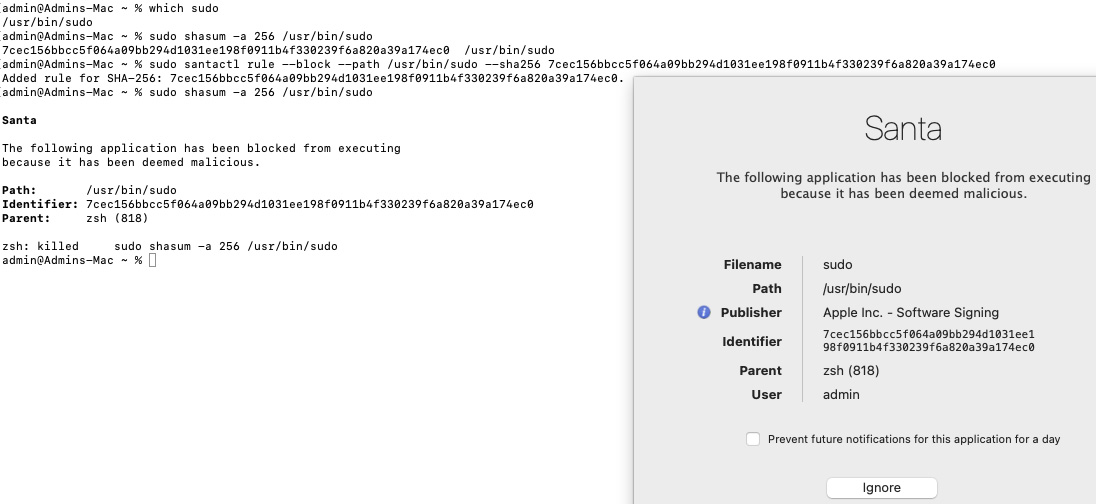

Blocking sudo
The rule for sudo can be removed from Script Editor with
Code:
do shell script "/usr/local/bin/santactl rule --remove --path /usr/bin/sudo --sha256 7cec156bbcc5f064a09bb294d1031ee198f0911b4f330239f6a820a39a174ec0" with administrator privileges
