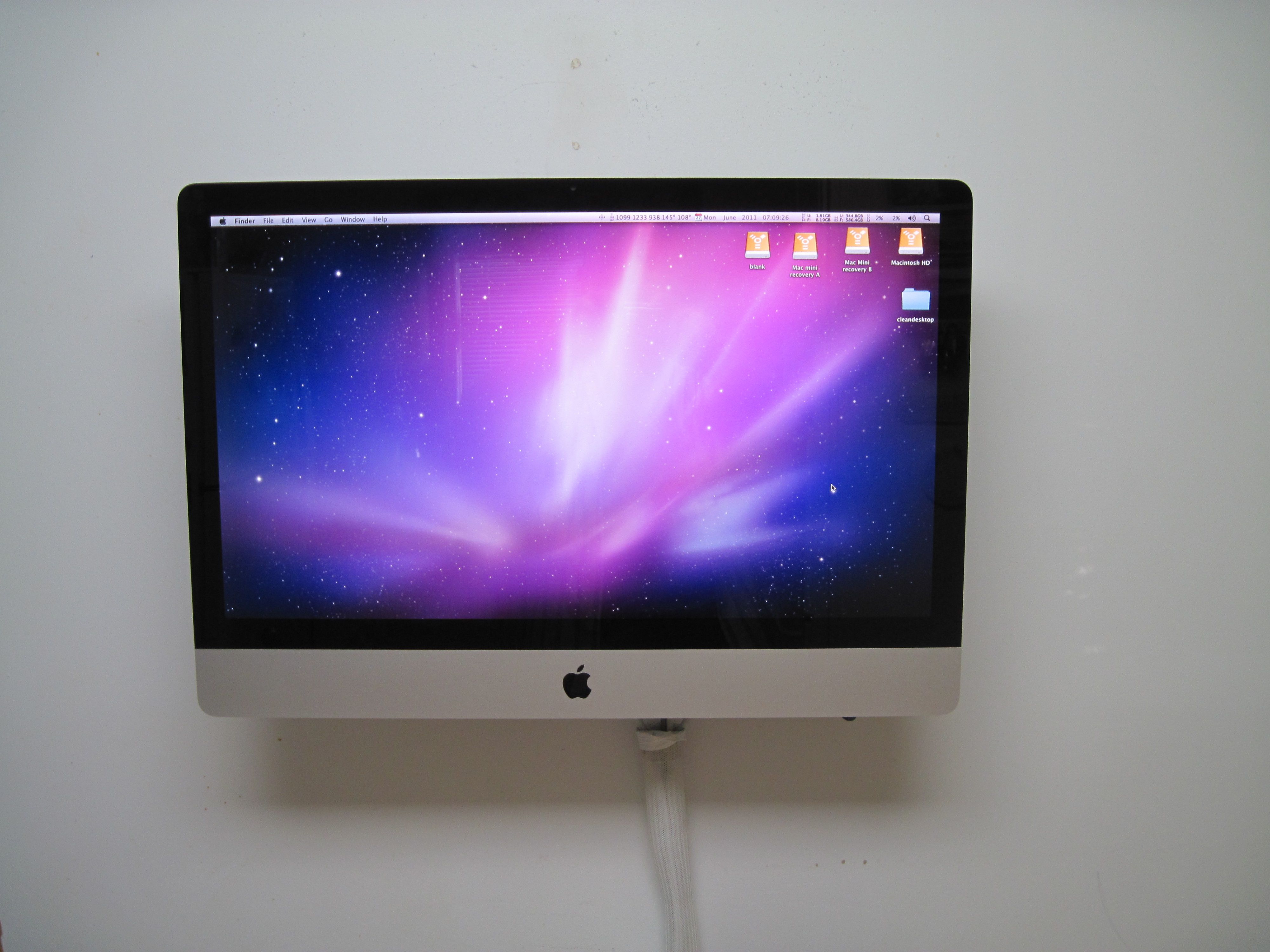

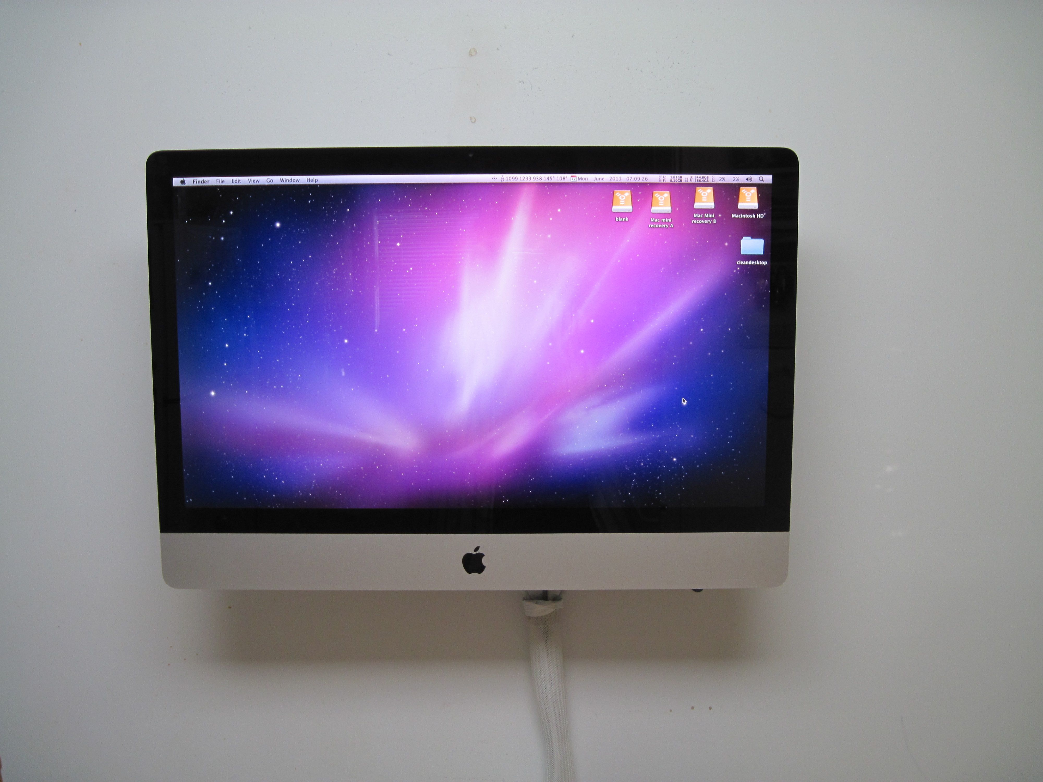

16 bucks to help protect a 2000 pice of equipment makes sense to me. if you wall mount your iMac you get nice air flow bottom to top. just keep the iMac at least 2 feet under the ceiling.
