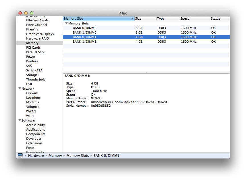

Not to beat a dead horse here, but I've seen conflicting info across the web on how to arrange a ram upgrade on the 27." I purchased 16 GB of Crucial ram, removed the stock ram, inserted the crucial ram in its place, and then installed the stock ram (in what were originally empty slots).
Can anyone knowledgeable please confirm that the resulting config is correct for max 24 GB performance?:
Do an Xbench memory test with your system. Then rearrange the memory, so the 8GB sticks are in the same lowest bank and the 4GB in the highest bank.
Like this:
Bank 0/dimm0 8 GB
Bank 1/dimm0 4 GB
Bank 0/dimm1 8 GB
Bank 1/dimm1 4 Gb
And do the test again. It should give faster results.

So in Apple terminology, which is correct?
Bank0/Dimm0 - 4gb
Bank0/Dimm1 - 8gb
Bank1/Dimm0 - 4gb
Bank1/Dimm1 - 8gb
Or
Bank0/Dimm0 - 4gb
Bank0/Dimm1 - 4gb
Bank1/Dimm0 - 8gb
Bank1/Dimm1 - 8gb
Referring to Apple's definition of "Bank", the first configuration would be the best, especially if the 4GB and 8GB are from different manufacturers. It's the same as a standard motherboard DIMM layout. It seems Apple uses "Bank" to refer to the channel, and "Dimm" to refer to the bank. I guess the two channels, ("Banks"), make a single DIMM. This is borne out by my 2010 15" MBP that only has a single dual channel pair labelled as follows:
BANK0/DIMM0
BANK1/DIMM0
If all RAM is fully compatible, the worst that would happen with 4GB and 8GB mixed in the same pair, is that the first 8GB used would be dual channel, the next 4GB would be single channel, followed by another 8GB of dual channel, and a final 4GB of single channel. Any perfomance hit would only be seen in benchmarks, and not in normal use. You'll probably be in the dual channel lower 8GB most of the time.
As a matter of interest, Kingston KTA-MB1600/4G 4GB SODIMMs and KTA-MB1600/8G 8GB SODIMMs most likely use the same Hynix chips as Apple's SODIMMs, and could be rebadged Hynix DIMMs. When I used the Apple compatible Kingston RAM to upgrade my 2010 15" MBP to 8GB, the manufacturer code in System Profiler didn't change - Hynix to Hynix.

I appreciate the feedback, Gogol. Your response seemingly contradicts a few others in this thread, so I'm not entirely certain who to believe at this point (see below).
I'm guessing xbench should confirm your response, but does xbench even run on Mountain Lion?
Xbench 1.3 runs on Mountain Lion, just don't do the thread test.
I have tested with original 8GB RAM and two 8GB sticks Kingston KTA in the empty slots. After that i rearranged the memory as in my post and it was 10% faster. People have to test for themselves, but this was my experience.

Your suggestion to make sure to keep the RAM in both channels the same leads me to believe that you feel that 12G in Channel 0 and 12G in Channel 1 would allow the PC to Dual Channel 12G of memory. This is incorrect and a flawed understanding (again, no offence intended). Only the RAM within a given channel can be accessed in parallel, thus the 2x4 in a Channel and 2x8 in another Channel is the right configuration, not 8+4 in Channel 0 and 8+4 in Channel 1.
--Illydth
You are confused because Apple displays the memory config rather badly in System Profiler. It is true that Intel has had the same memory config since P4. So the easiest way I can convince you is to pull up a motherboard manual.
http://vfiles.cizgi.com.tr/cizgi/pms_dosya/153/p5wdhdeluxe_en.pdf
Page 2-14.
This is just one I know on top of my head is very clear about memory installation. You can check other motherboard manuals as well and they will be the same.
Now what Apple did was rearrange the order the slots are displayed in System Profiler. To give you an example 16GB of RAM in a 4 slot system will be seen like this:
bank 0/dimm0 - 8GB
bank 1/dimm0 - 8GB
bank 0/dimm1 - empty
bank 1/dimm1 - empty
In reality on a 2012 iMac the slots are 8/_/8/_ if you are to look at how the memory is installed. That is where the confusion lies.
