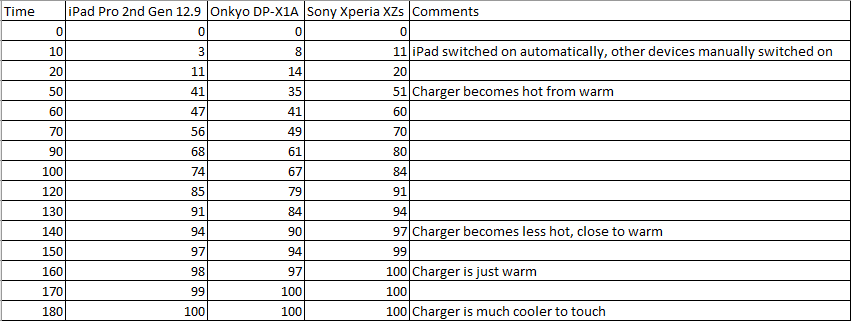

Ok, I have tested it! Drained all three devices to 0% and charged them and an Apple Pencil all at once. All charging cables used are official, the XZs is using a Super Charge cable from Sony while the iPad is using Apple's USB C to Lightning cable.
Time in minutes, the rest in %
Quite close to Apple's charger, money well spent here!

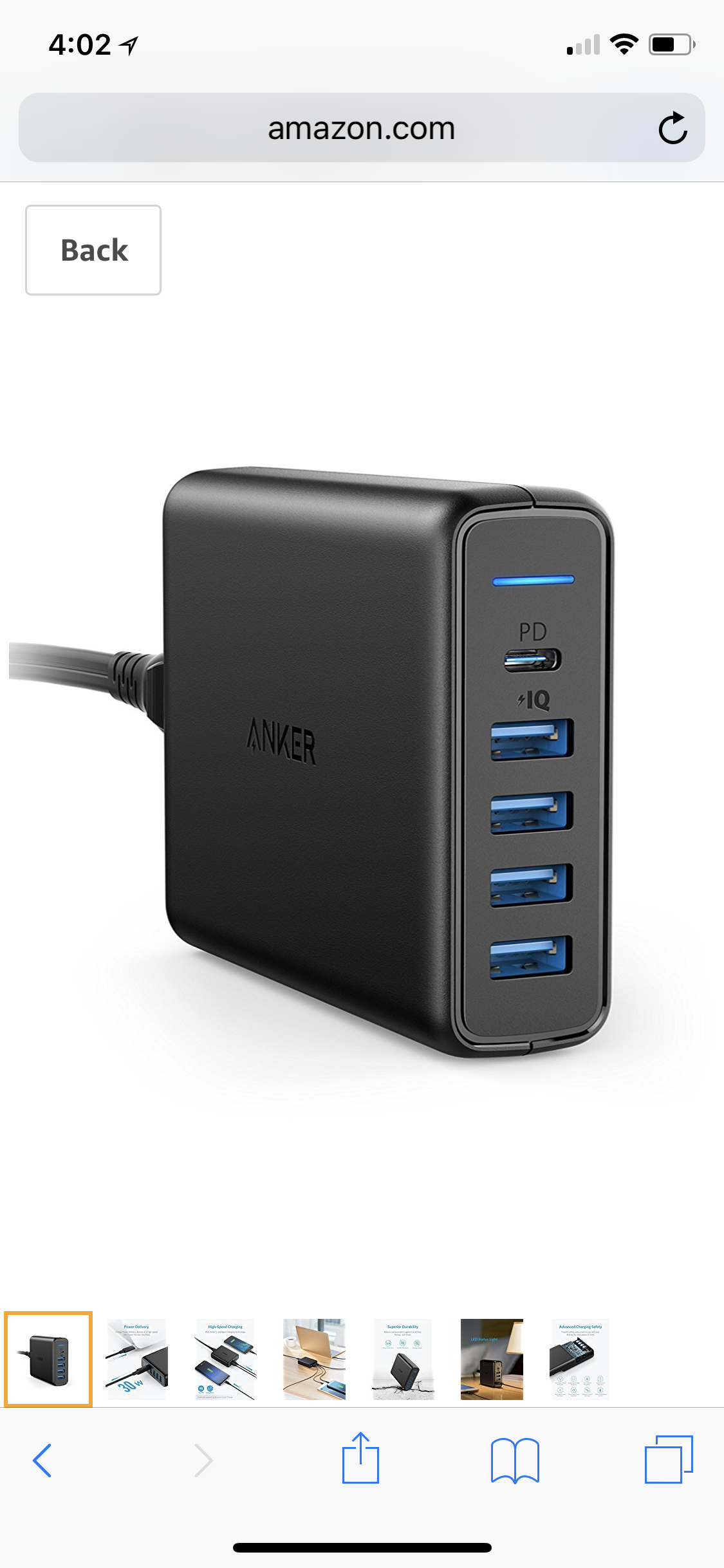

Does anyone have this latest version from Anker? Seems to be slightly smaller than the one mentioned in this thread, 1 x USB C PD + 4 USB A. Does this fast charge an iPhone X, iPhone 8, and the iPad Pro 10.5” if I use the Apple USB C to Lightning Cable?
https://www.amazon.com/gp/aw/d/B072K5ZJXF
Anker responded to one of the reviews that had this question. Their reply:
"Regarding this charger, it meets the USB-C PD specification for both performance and safety, ..."
Same reviewer indicated that he was seeing fast charge times.
I have the latest Uk version on amazon and it fast charges the iPad Pro fine as confirmed with my usb c voltmeter 1.84A @ 15v
