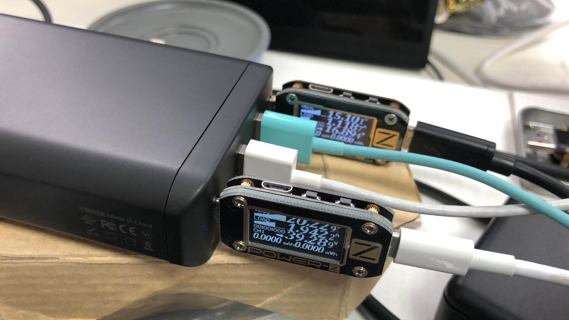

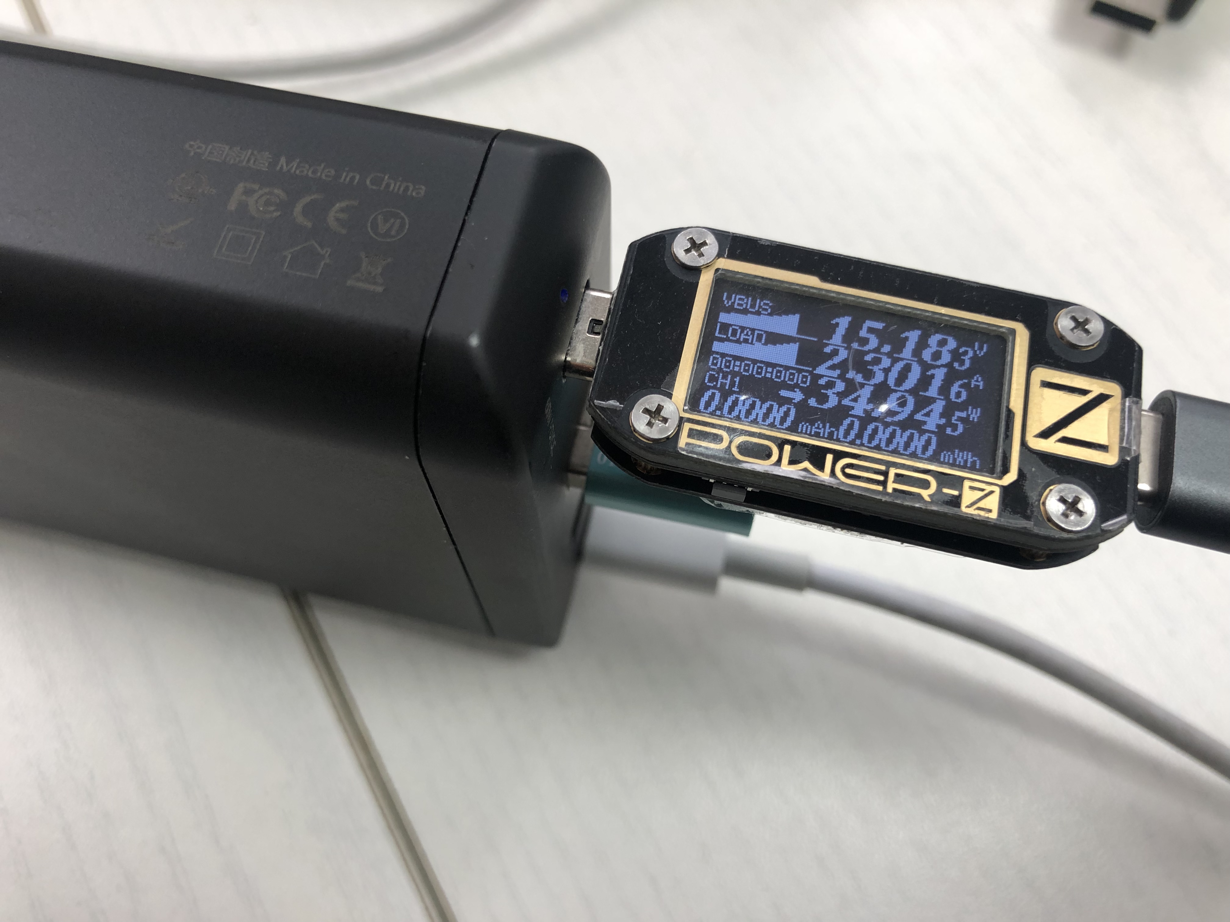

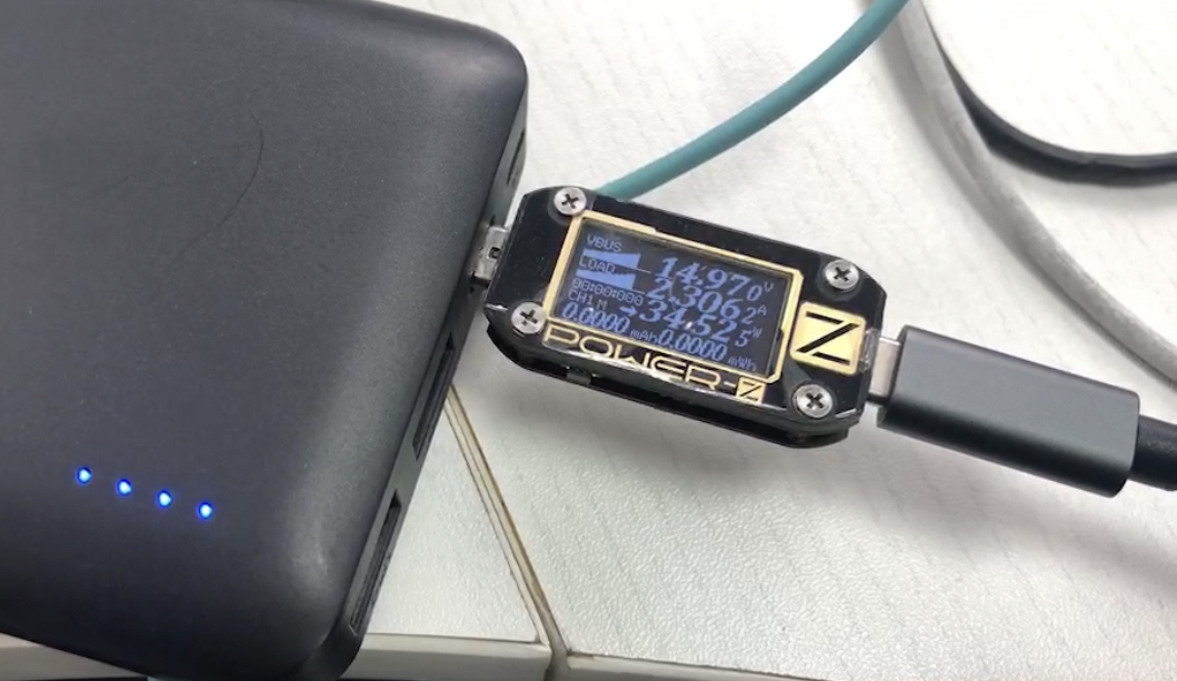

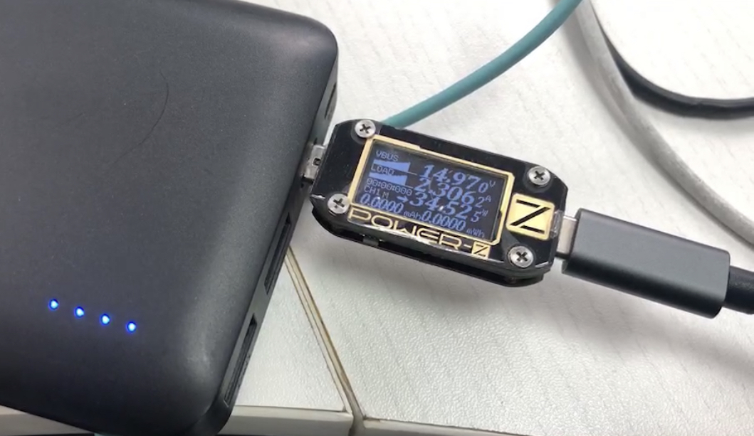

The new iPad Pro quick charge should be around 36w max, we have tested with our PD power bank, PD car charger, and PD desktop charger and they all give a similar figure.
Nice! You have the Power Z meter - I ordered the same off eBay, waiting for it to arrive.
I can corroborate the same, based on some quick findings:

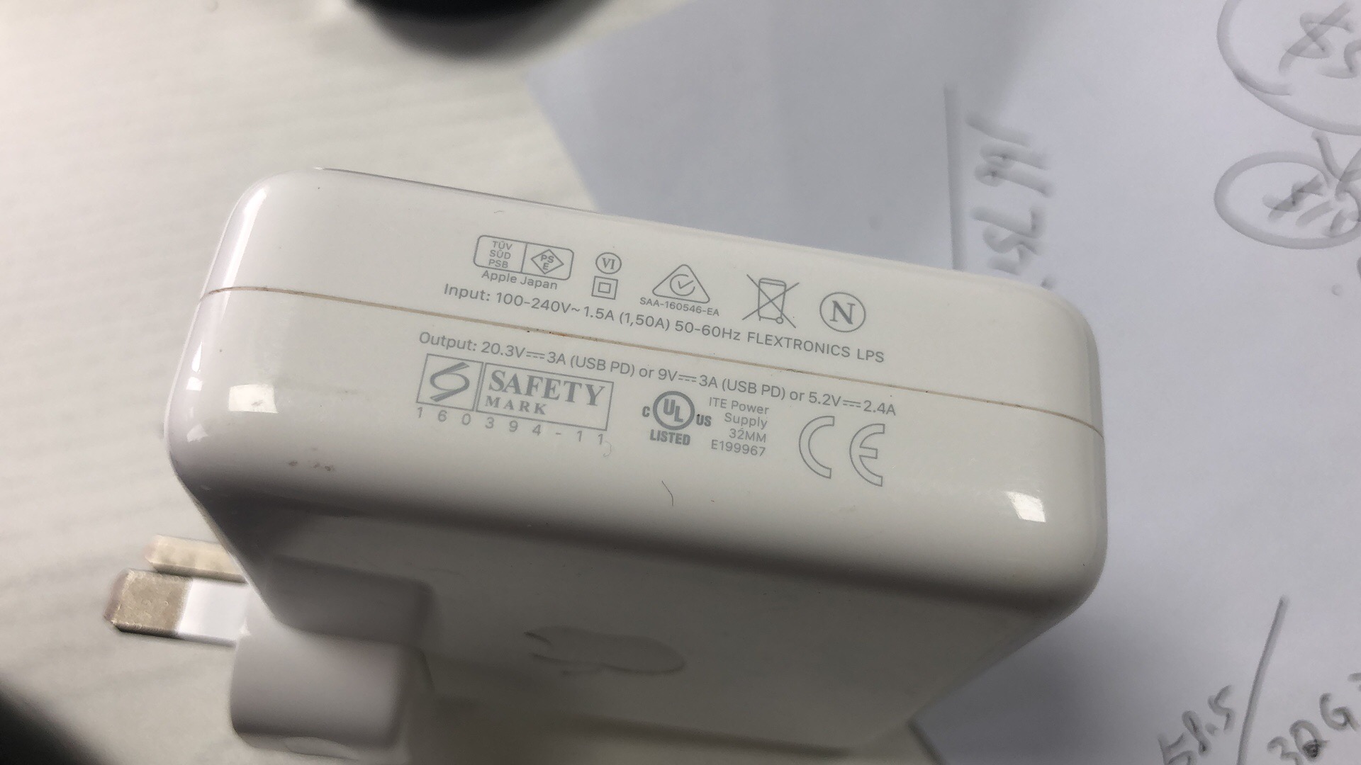

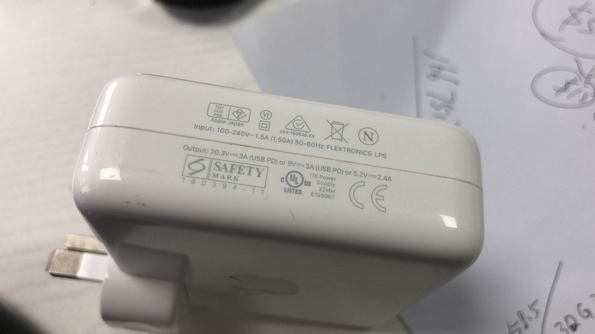

The Apple 60W charger is not faster because it doesn’t have 15V output.
Now, I am totally confused! The 30W has 15V, but the 60W does not?

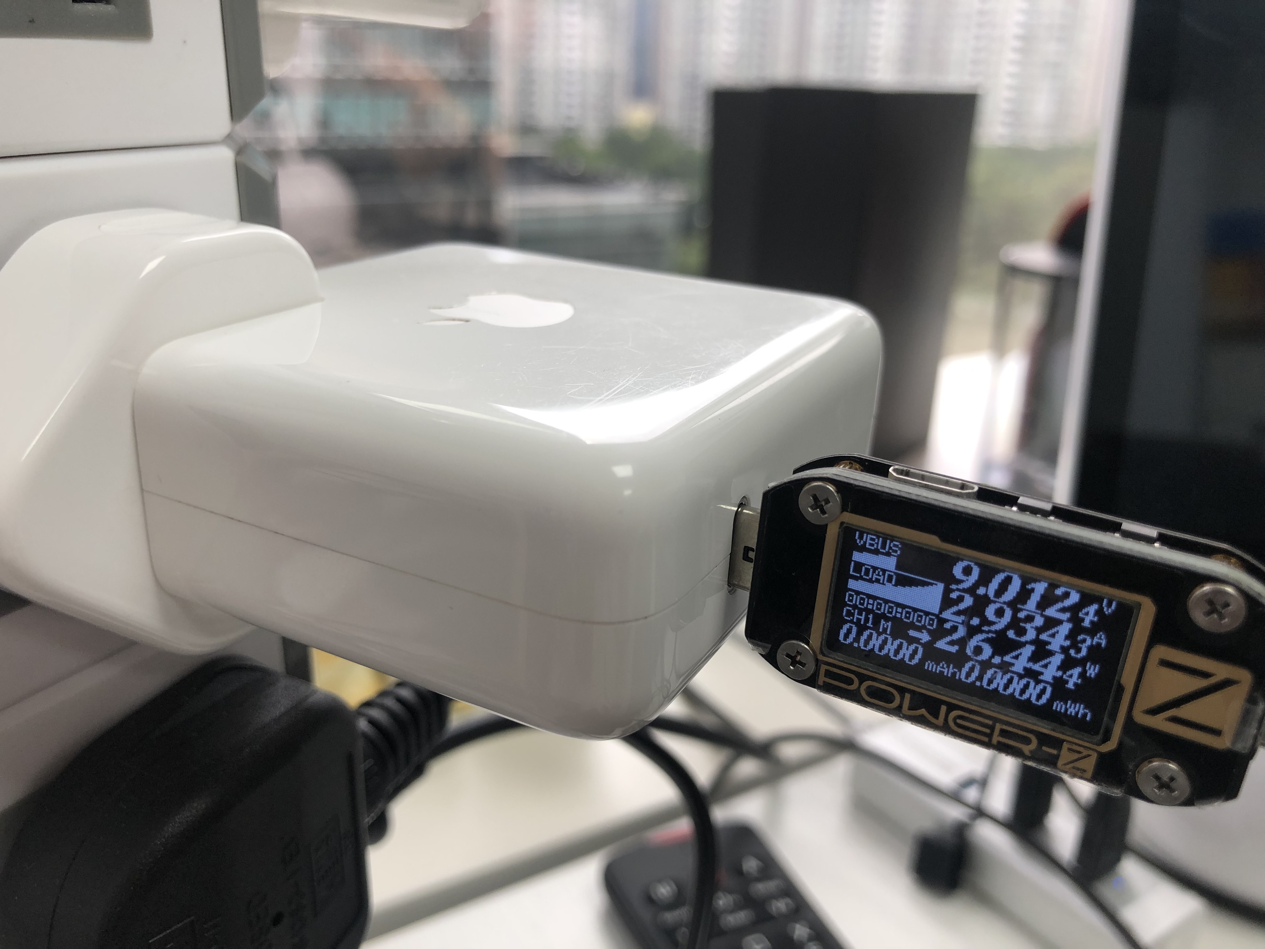

It doesn’t have 15V profile, so 9V/3A max for the 61W adapter, by the way our power bank can do about 36W as well as I’ve tested it personally!
[doublepost=1542562492][/doublepost]15V/4A isn’t a “legal” PD profile.
It should be 15V/3A or 20V/3A, according to USB-IF’s definition.

Ok, I understand. The Apple 60W adapter do not support 15V, but the Apple 30W Adapter and some devices from other manufacturers do. And why do you get only 36W when your powerbank should spend 45 W to the iPad Pro?
The voltage is fixed, but the current is not. So at 15V, it sends up to 3A, but not necessarily always 3A. When the iPad Pro battery is at a high percentage, for example, the current goes down, and hence the power delivered. However, the iPad Pro even at 0% will not take more than 36W, or 15V @ 2.4A
