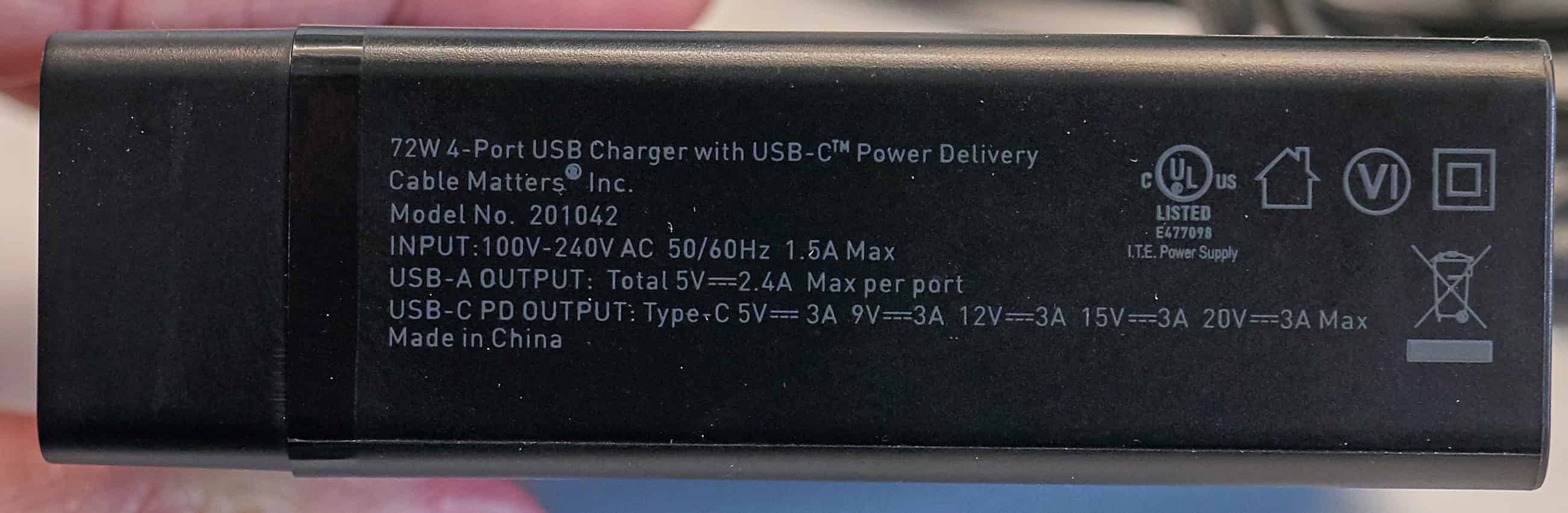

I wanted to get an adapter that had both USB-C and regular USB-A ports, which is a nicer all-in-one solution, and after looking around I found this which seemed reasonably priced and had the right specs:
Cable Matters 72W 4-Port USB-C Charger - https://www.amazon.com/dp/B01MS9CTB7/ - $27 at time of purchase
5V x 3A, 9V x 3A, 12V x 3A, 15V x 3A, 20V x 3A
It has a nice array of electrical outputs, and it looks like it could theoretically charge the 13" MacBook Pro at almost full speed. One thing to note is that it is less convenient that the other chargers I've tested, as it has a cable that connects to the adapter instead of having it built it. It's also generally much larger.

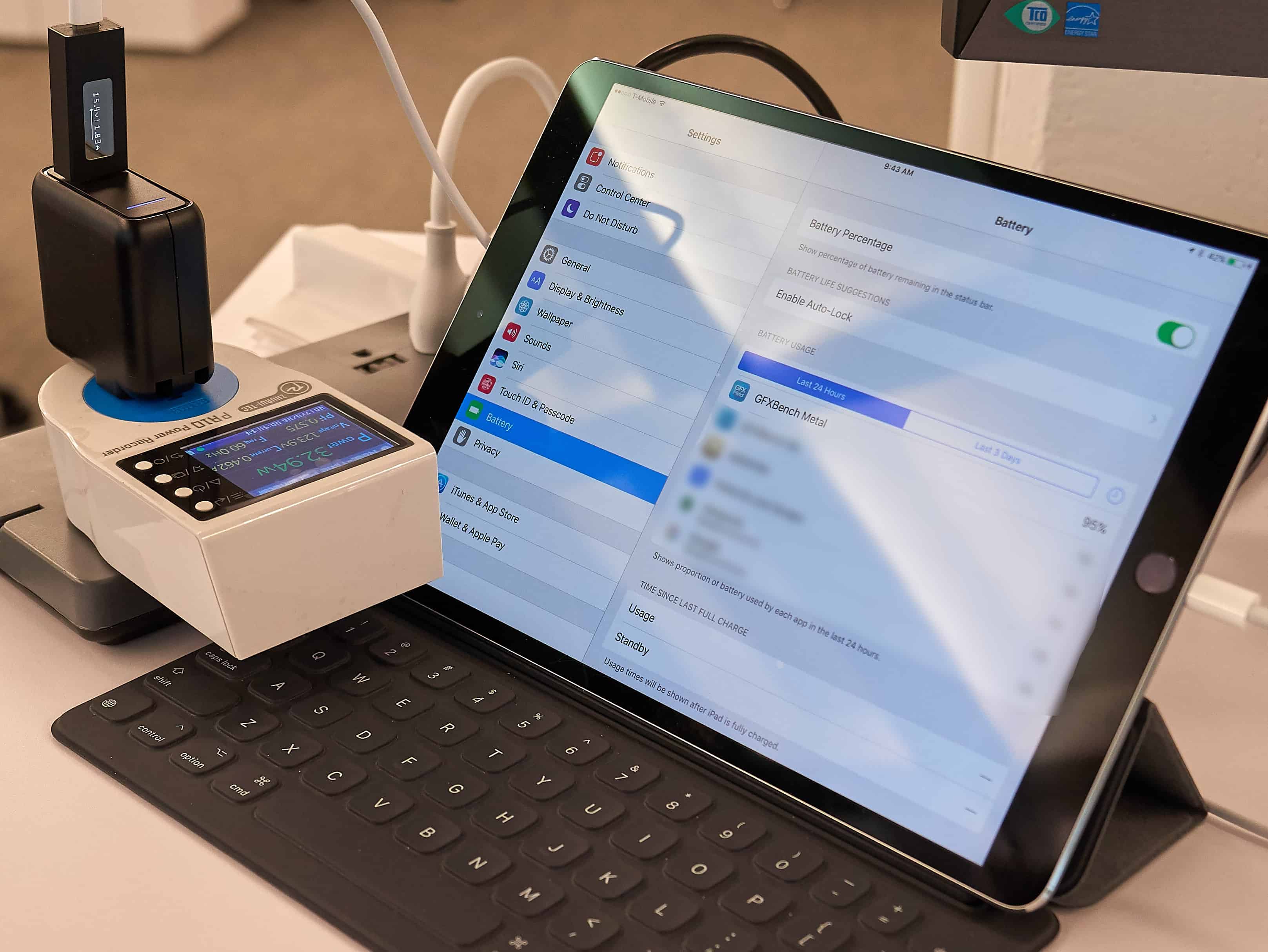

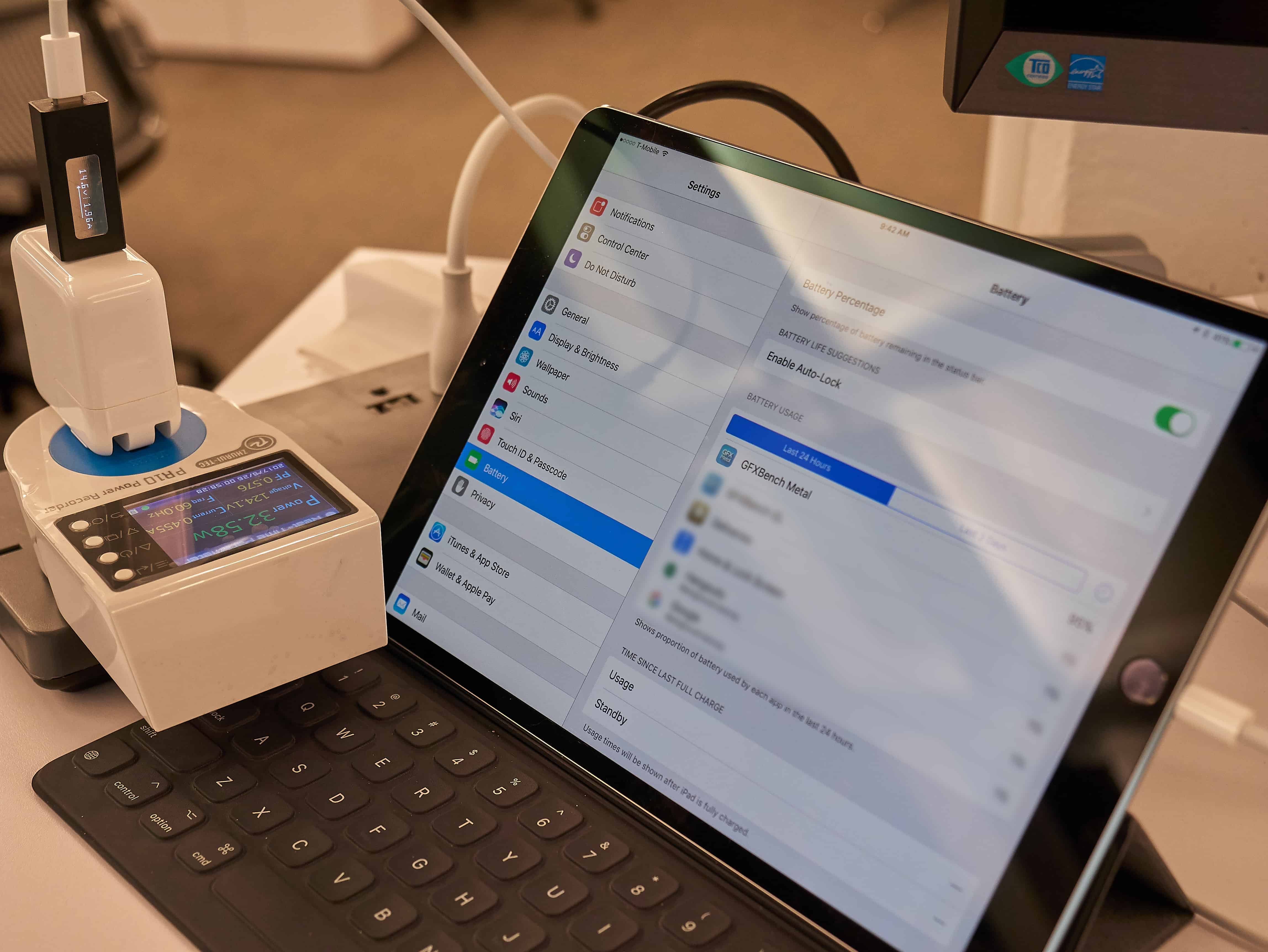

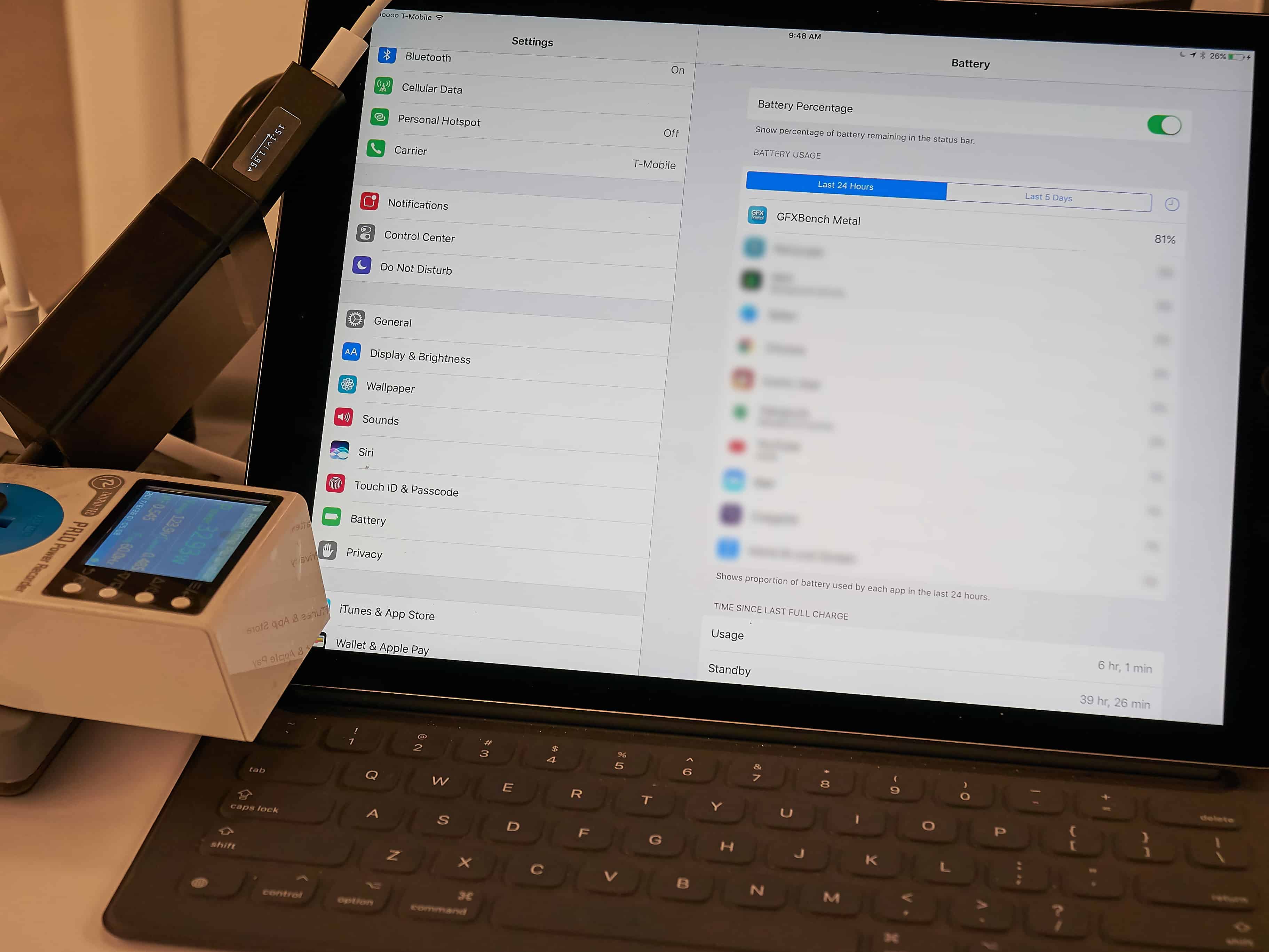

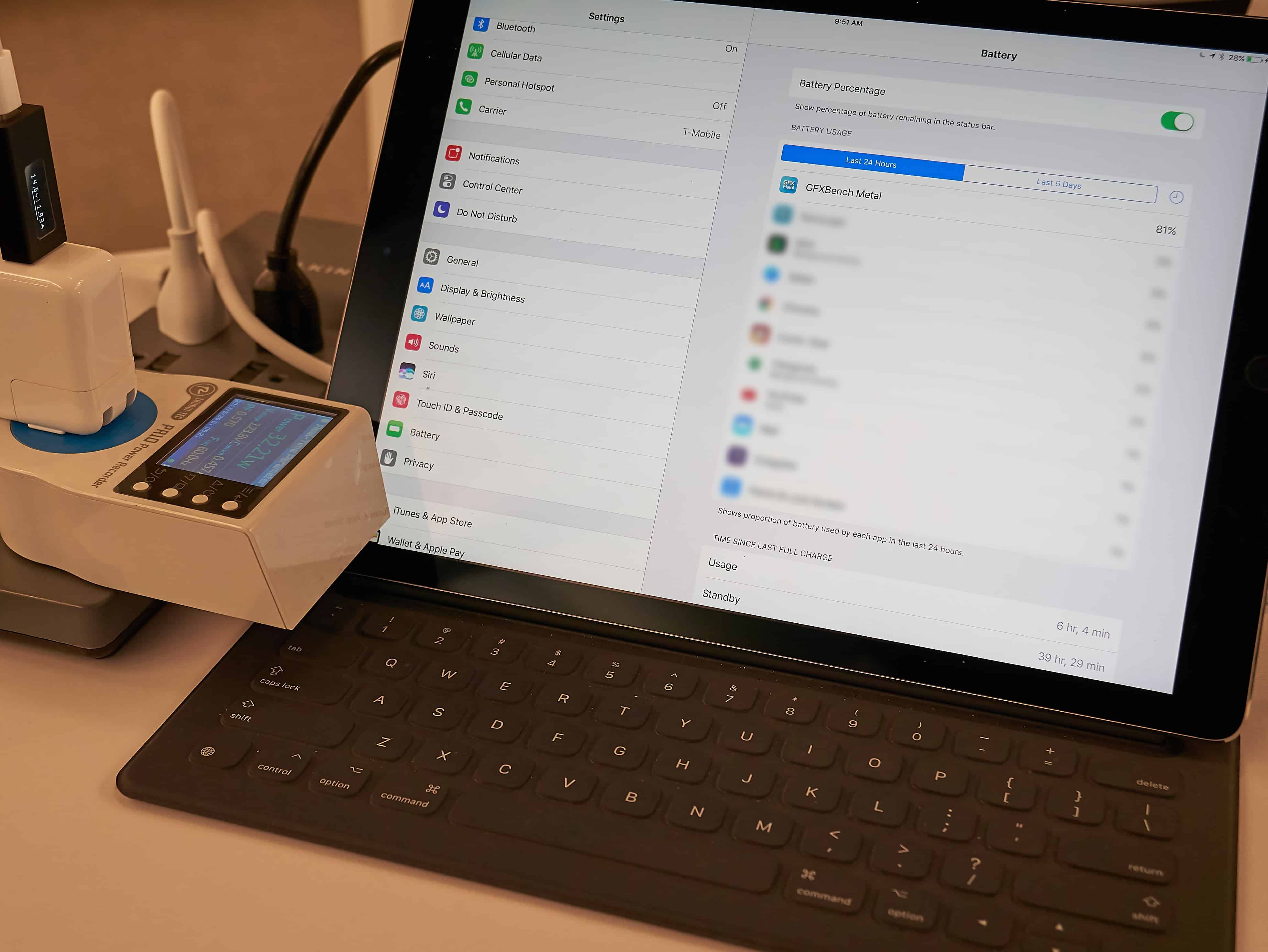

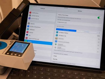

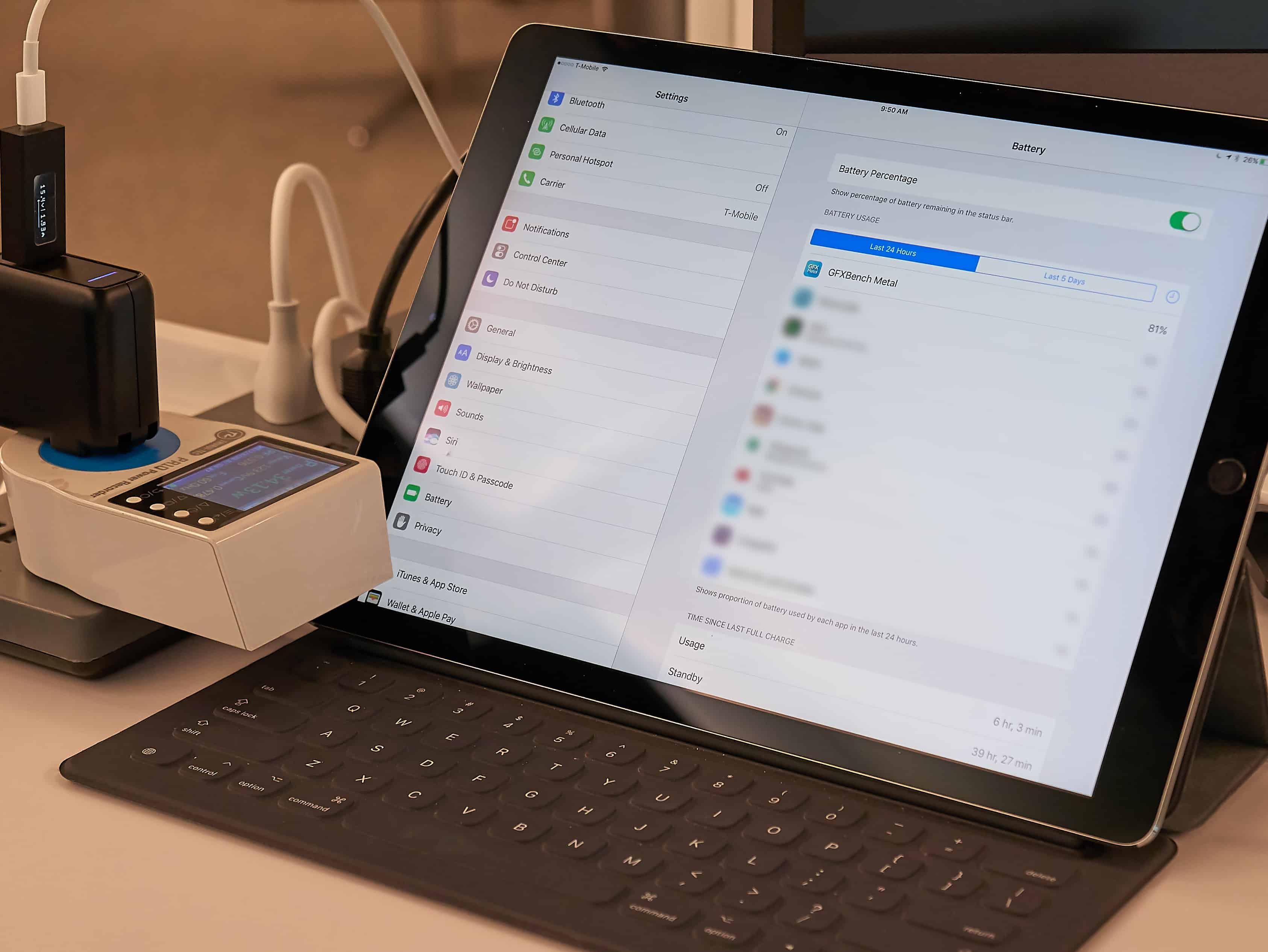

I also purchased a Plugable USB-C power meter for a better idea of the actual current and voltages. Here are the results:
Code:
            Anker            Apple             Cable Matters
|10.5" |   15.4V/1.83A    |  14.6V/1.96A     | 15.3V/1.80A      |
|      | 32.94W (total)   | 32.58W (total)   | 31.57W (total)   |
|      | 28.18W (to iPad) | 28.62W (to iPad) | 27.54W (to iPad) |
|12.9" |   15.4V/1.93A    |  14.5V/1.93A     | 15.1V/1.96A      |
|      | 34.13W (total)   | 32.31W (total)   | 32.93W (total)   |
|      | 29.72W (to iPad) | 27.99W (to iPad) | 29.60W (to IPad) |
tldr; They all support 29W fast charging, which is great! Interestingly as @Krevnik observed, the non-Apple chargers output 15V and are supported by both iPad Pros, whereas the Apple charger remains at 14.5V.
I've taken individual photos of each result for reference.
10.5" w/Apple
10.5" w/Anker
10.5" w/Cable Matters
12.9" w/Apple
12.9" w/Anker
12.9" w/Cable Matters

So I'm trying to determine the rule of thumb for a potentially compatible charger. Can I conclude that it needs to be Type-C, have Power Delivery and the voltage*ampère should be around 30W in any combination? Would this powerbank work for example: https://www.ravpower.com/20100mah-external-battery-charger-QC2.0-type-c.html
I'm eager to get a solution that charges both my MacBook Pro and iPad Pro 10.5 at max speed and is reasonably portable. Perhaps it better to wait till the dust settles and the market for IPP2017 matures right?
@masotime Slightly off topic, but do you have any recommendations for car chargers?
Yeah the key indicators would be "Power Delivery", "USB-C", and you'd be looking for 9V/2-3A and ~15V/2-3A outputs.
Awesome. I've also hooked up to the MacBook charger for comparisons and my results agree: 15V, up to 2A on the third party chargers that support it, 14.5V, up to 2A on the MacBook charger. Glad to know I'm not seeing things.
Interesting that the Anker reading is that high on the voltage though. Even accounting for error from the meter, that's a bit high.
