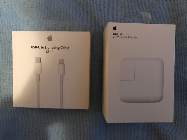

I just picked up both the 29W Power Supply and a USB-C to Lightning cable for a steal.
It's a must have for any Apple iOS user (let alone iPad Pro owners).
