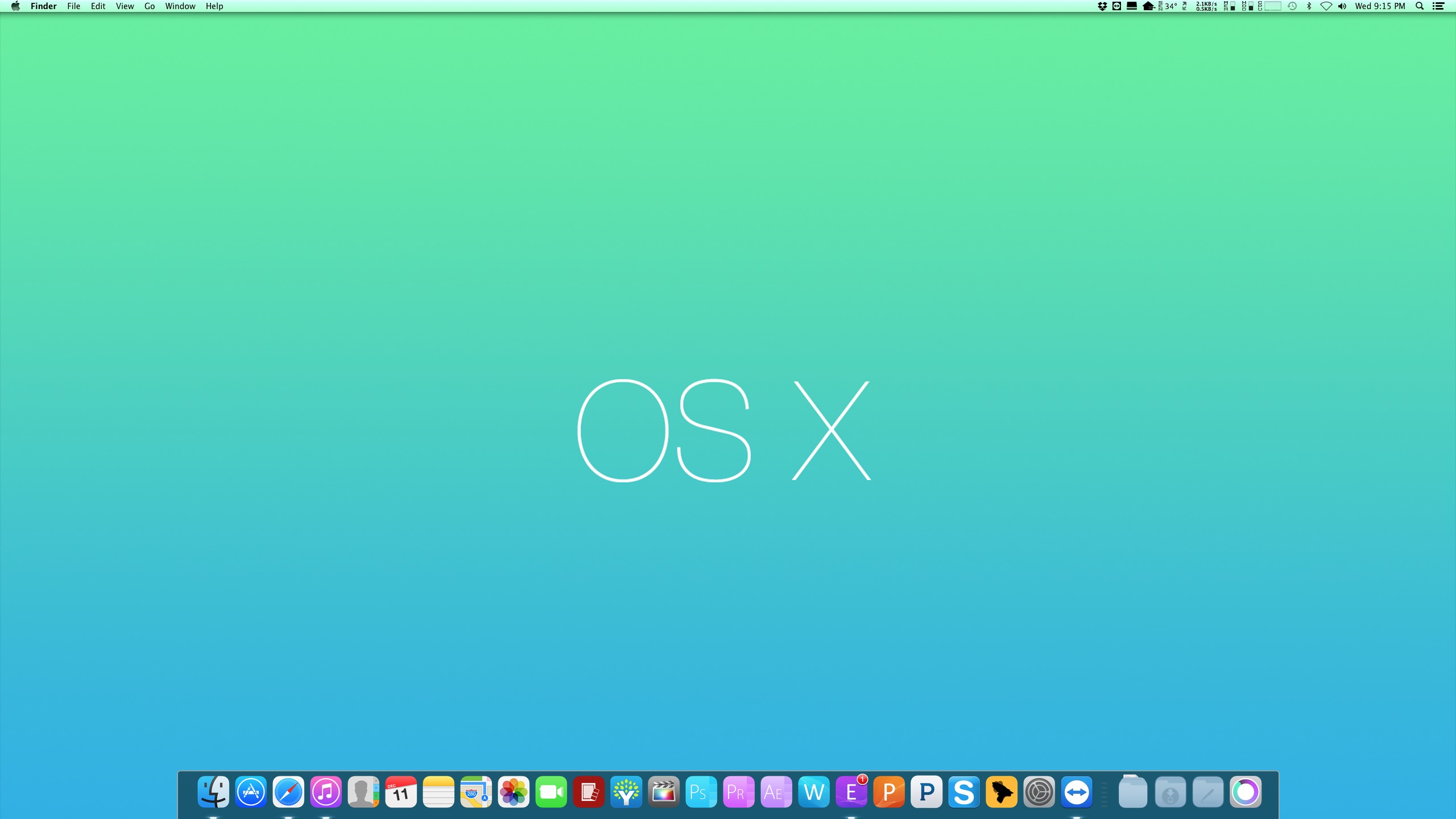

There is a way in this thread to get the old 2D dock on Mavericks.
https://forums.macrumors.com/threads/1681155/
Basically:
1) Install SIMBL
2) Download, extract and mount BlackDock0.8.0
3) Place BlackDock.bundle in /Library/Application\ Support/SIMBL/Plugins
4) Run InjectIntoDock
Result Image
Basically:
1) Install SIMBL
Result Image

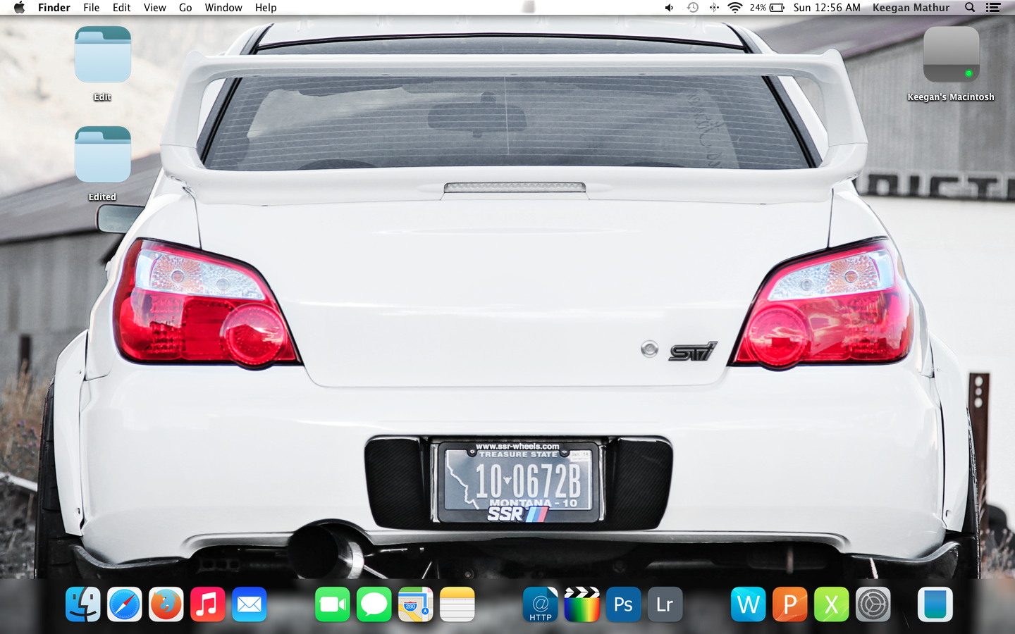

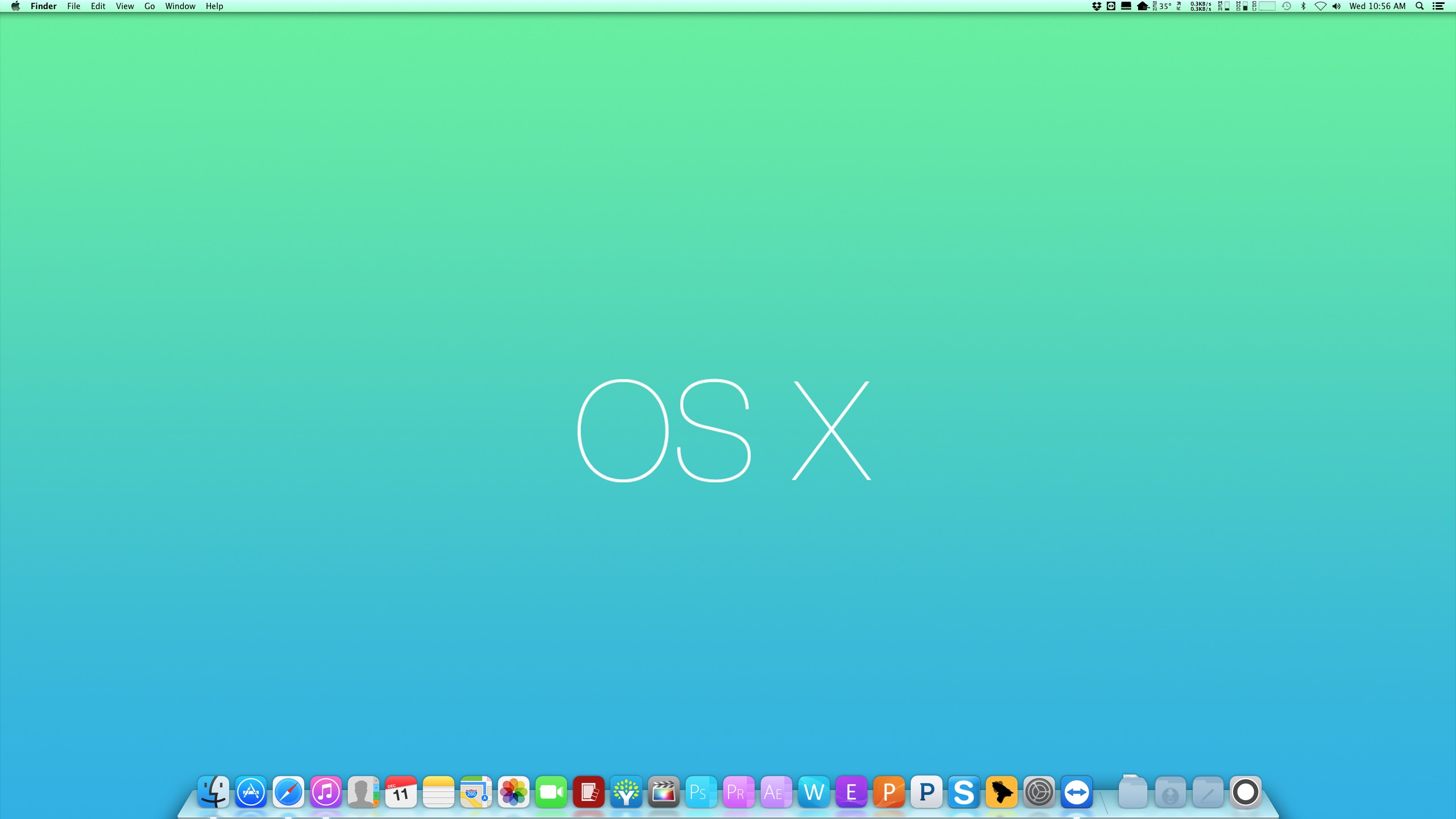

Yeah there is no way to change the color. I'm pretty sure it's just the same as the pre-Mavericks 2D dock. The link doesn't seem to want to work so I changed the link.
Alternate option is:
1) Buy dockmod (or use trial)
2) Make the dock transparent using dockmod
3) Install GeekTool
4) Make a background behind the dock
5) Adjust color and transparency as you please
Obvious the background wont hide when the dock does. (might be possible with a script if there is away to check if the dock is currently hidden or not)
You can also make the dock look really similar to iOS 7 using this method.
results will look like this:
https://forums.macrumors.com/attachment.php?attachmentid=447721&d=1384667876
or this:
Throw in Nocturne and you've basically got fully iOS7ified OSX Desktop
