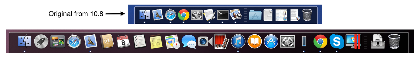

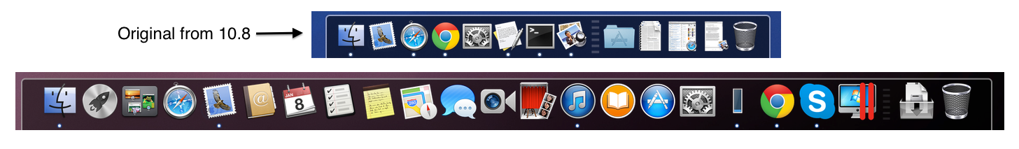

The spacing on the black dock in this thread is incorrect. Look at this comparison photo to see:
Code:
Yes. I noticed that too. I fixed it on my white dock. I guess it's like that because OS X draws the 3D dock in perspective, starting wider and tapering back, so it has to start wide so there's enough "floor" for the icons to be on when it gets to the back.

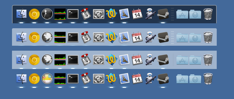

Here is the new installer which is now called cDock. I updated the readme and added screenshots of all 4 versions of the dock.
Download
It also doesn't require you to enter your password if you already have simbl installed now.

Thanks for making this!
However, I don't get a separator with the square dock 😕 It shows with the rest.
Any ideas?
