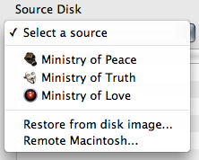

Yes, Carbon Copy Cloner has been able to perform block-level clones for a few years now, but it can still only clone one partition at a time. The two drives need not be the same size, either. A block-level clone can take place from a smaller drive to a larger one.
As you can see in the shot below, only partitions are listed, not drives.
