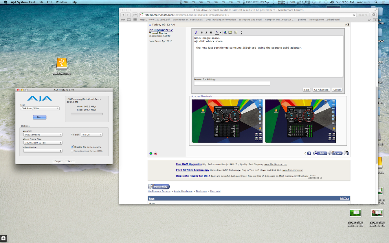

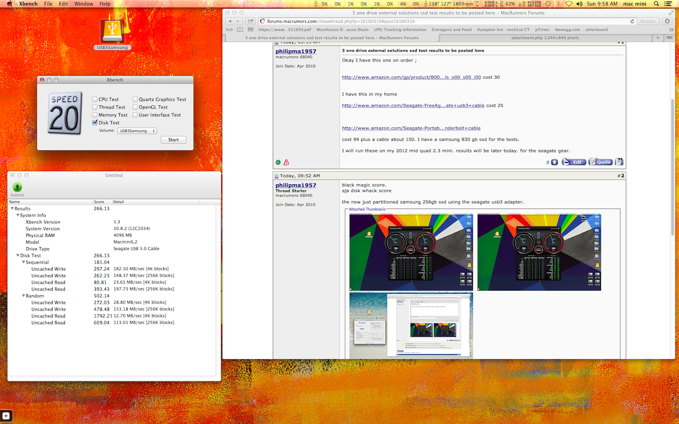

black magic score.
aja disk whack score
xbench disk score

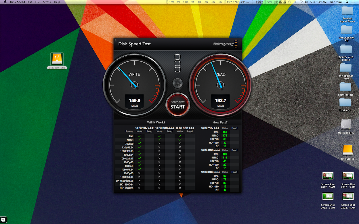

the new just partitioned samsung 256gb ssd using the seagate usb3 adapter.

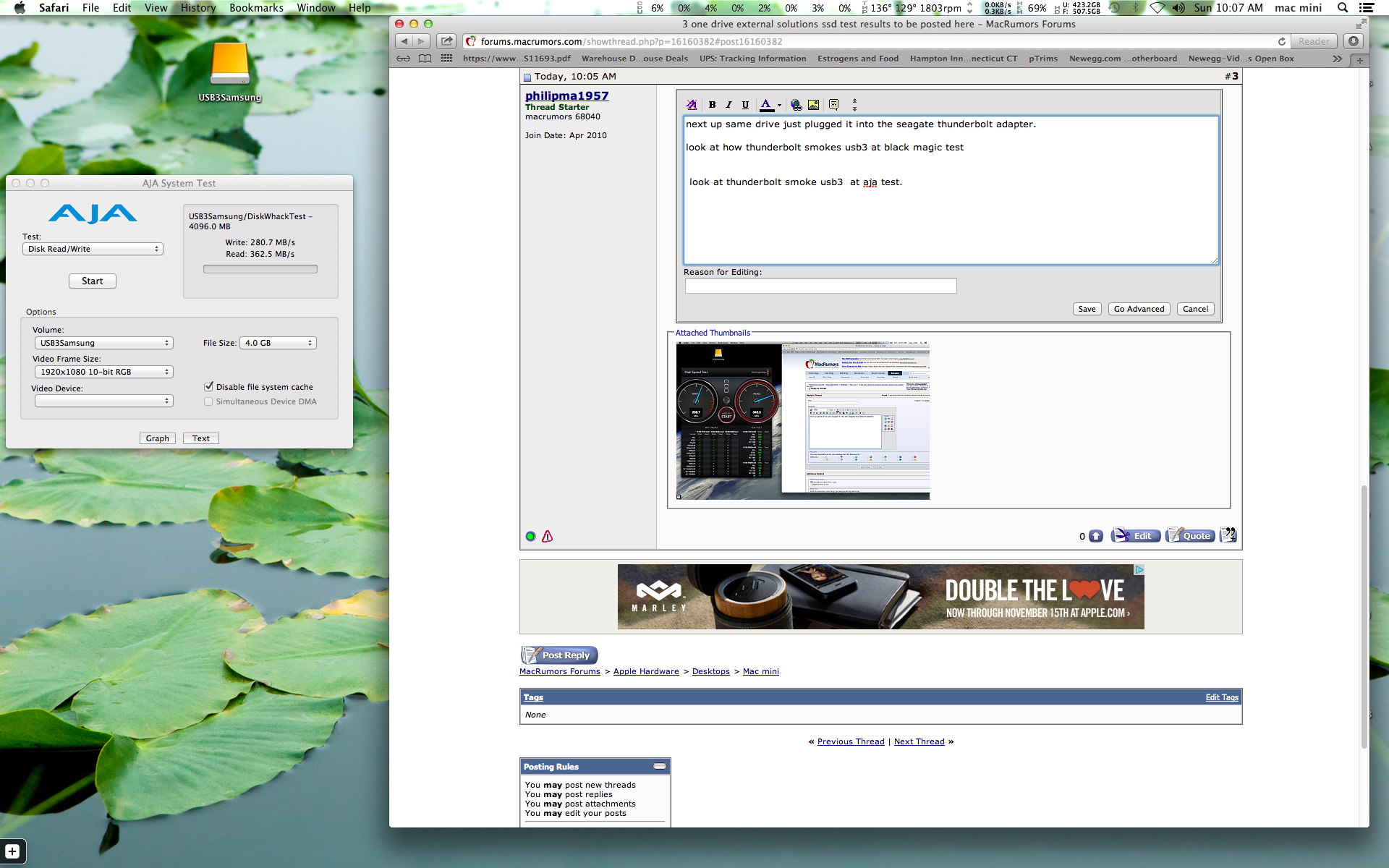

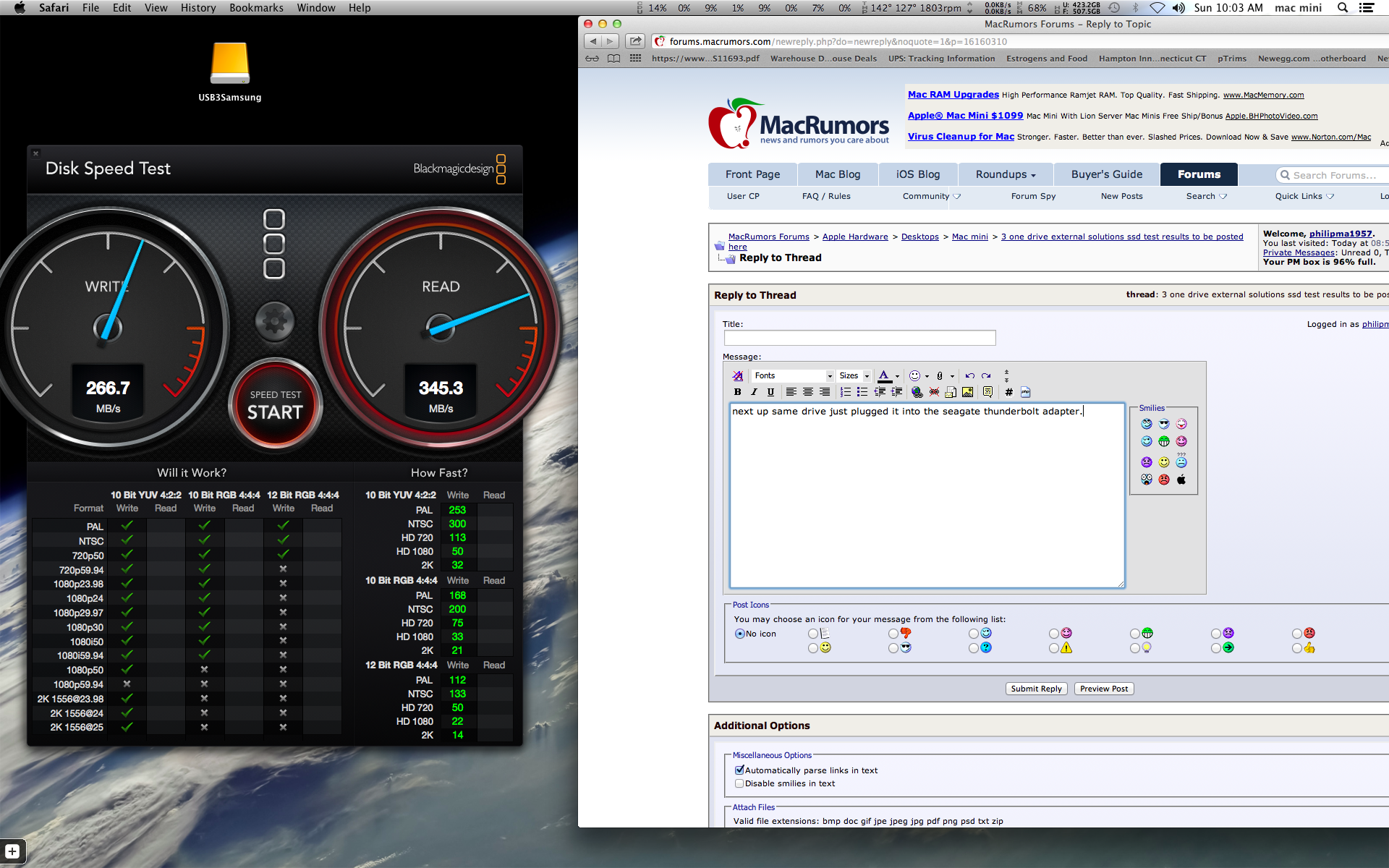

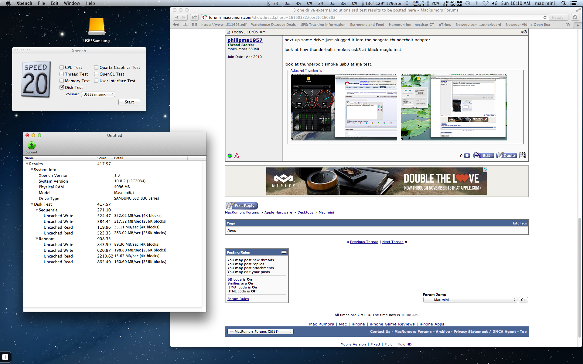

next up same drive just plugged it into the seagate thunderbolt adapter.
look at how thunderbolt smokes usb3 at black magic test
look at thunderbolt smoke usb3 at aja test.
look at thunderbolt win at xbench test .
Well in the case of seagates usb3 vs seagates thunderbolt adapter.
thunderbolt is far faster. cost is a lot more 150 vs 25.
I will wait for the third case from oyen it may be a better usb3 chip.
Still in a way this points to lacies $199 rugged thunderbolt/usb3 128gb ssd as a good deal.
You get both cables ssd and a case.
I wish I could dis usb3 people properly as it is clearly inferior to thunderbolt when using ssds. But hey live and let live.

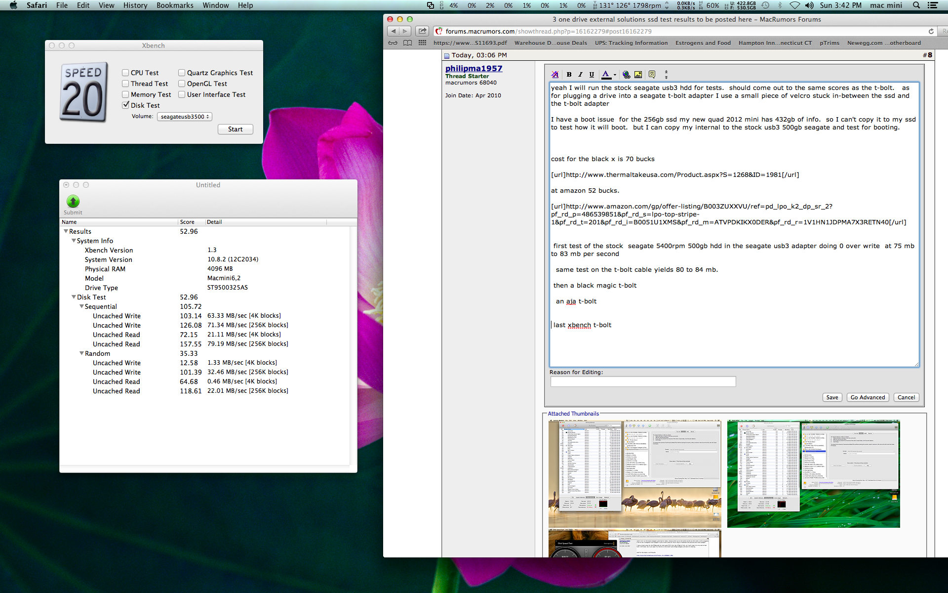

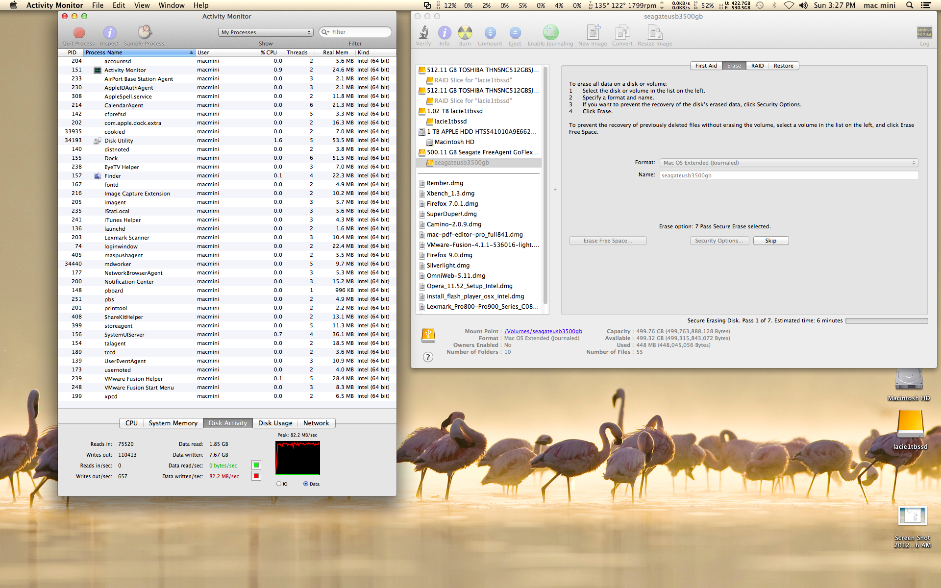

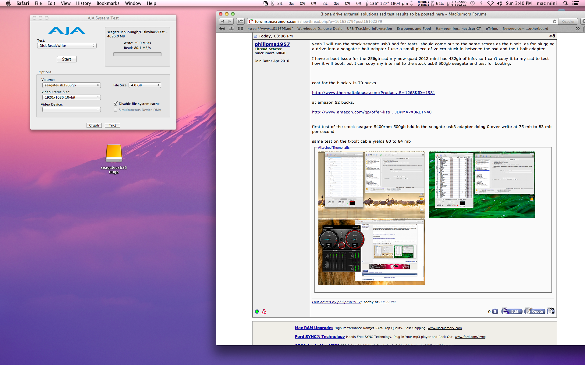

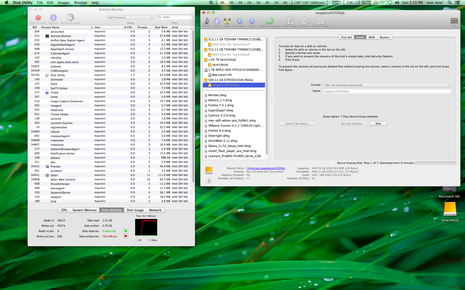

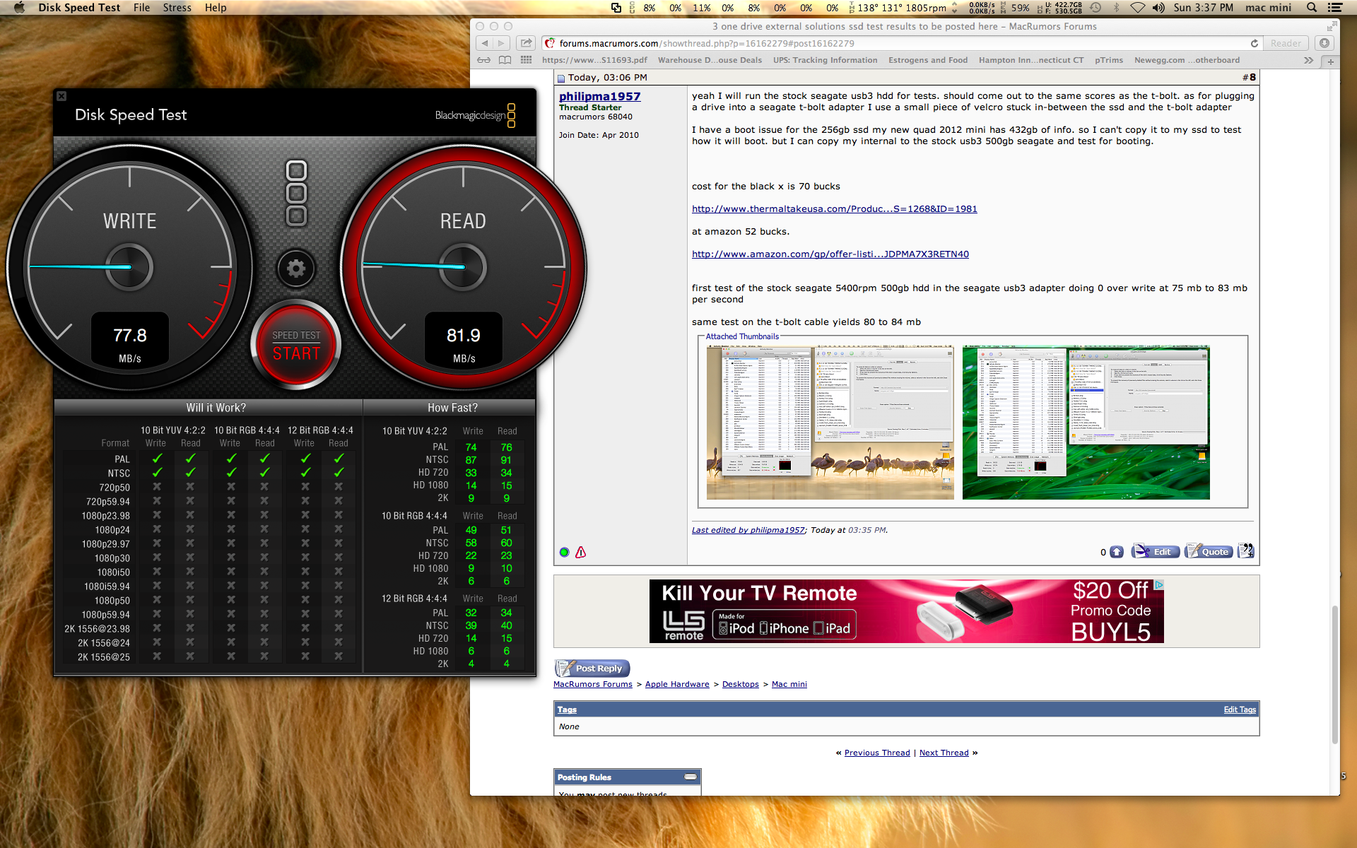

first test of the stock seagate 5400rpm 500gb hdd in the seagate usb3 adapter doing 0 over write at 75 mb to 83 mb per second
same test on the t-bolt cable yields 80 to 84 mb.
then a black magic t-bolt
an aja t-bolt
last xbench t-bolt.
so if you are tight cash and get a usb3 and a fast hdd you can help your mini at a low cost.

I am going to clone an osx to the external usb3 then use it to run os just to see if it is stable.

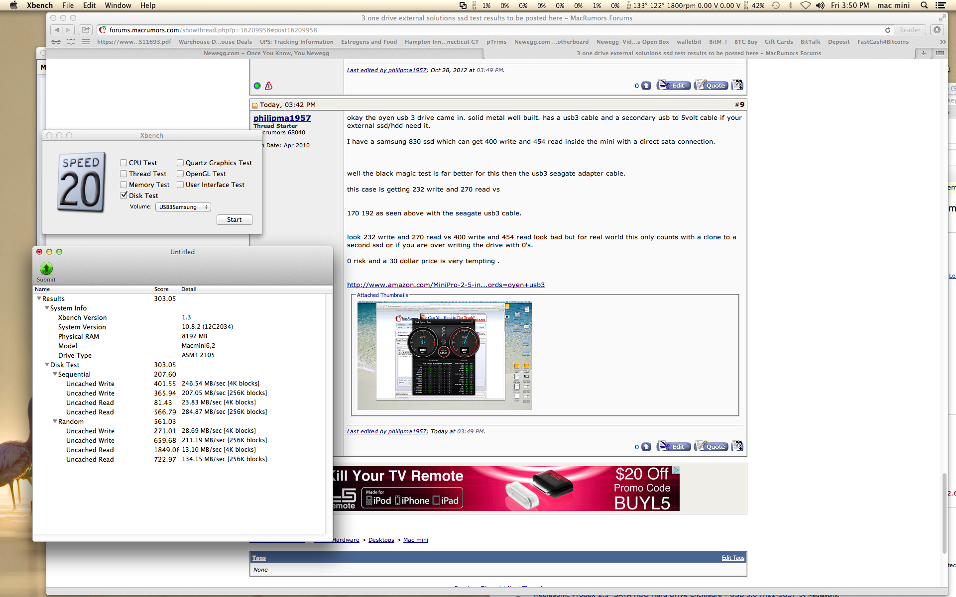

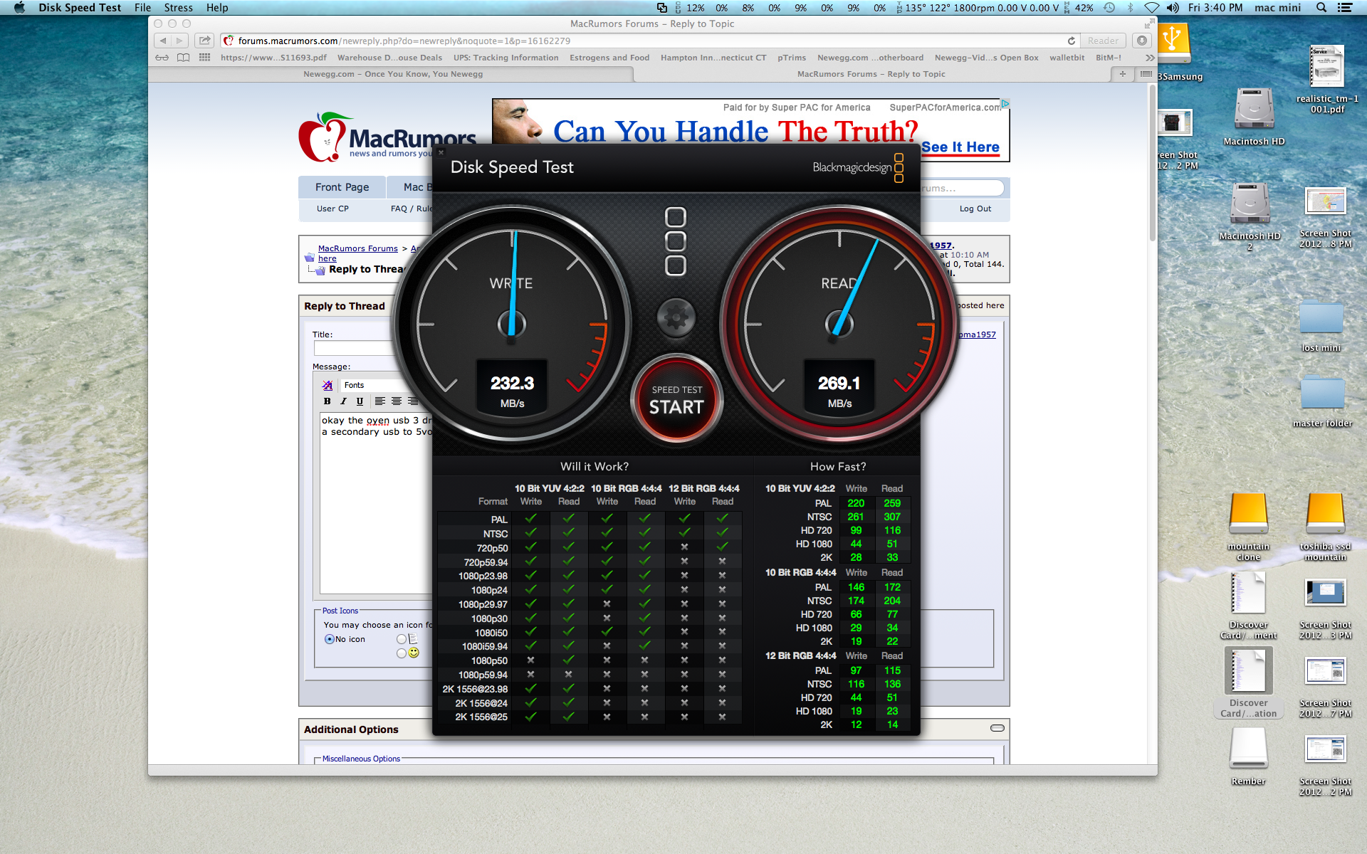

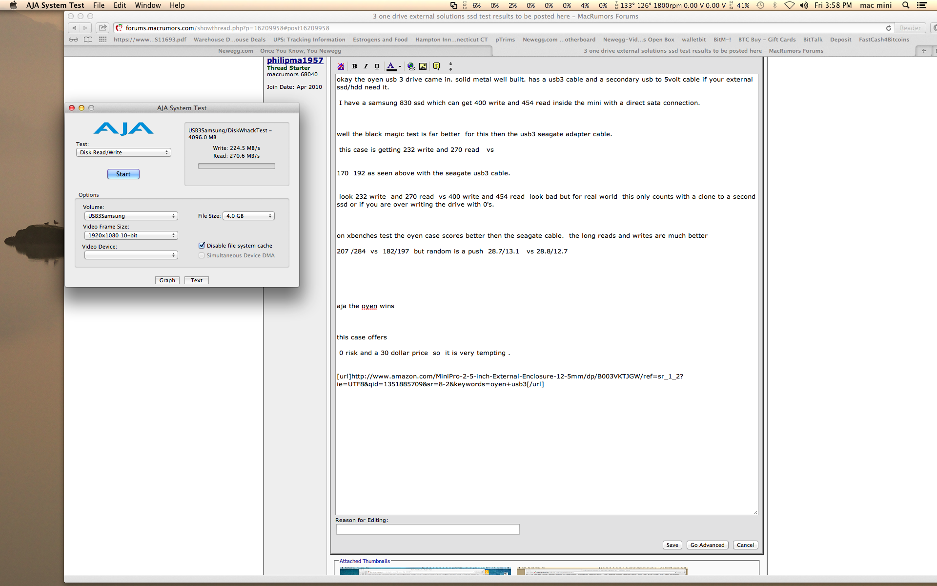

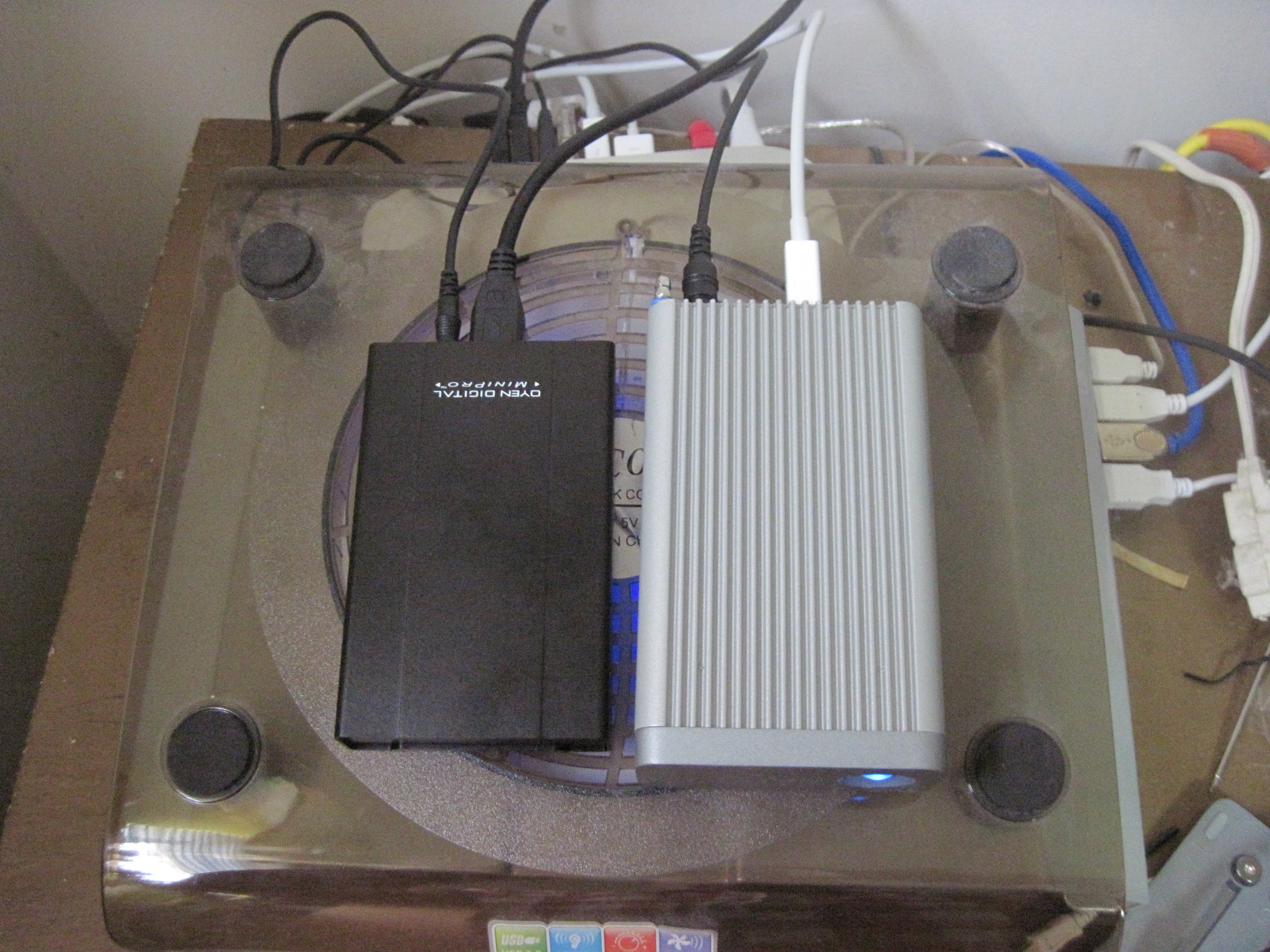

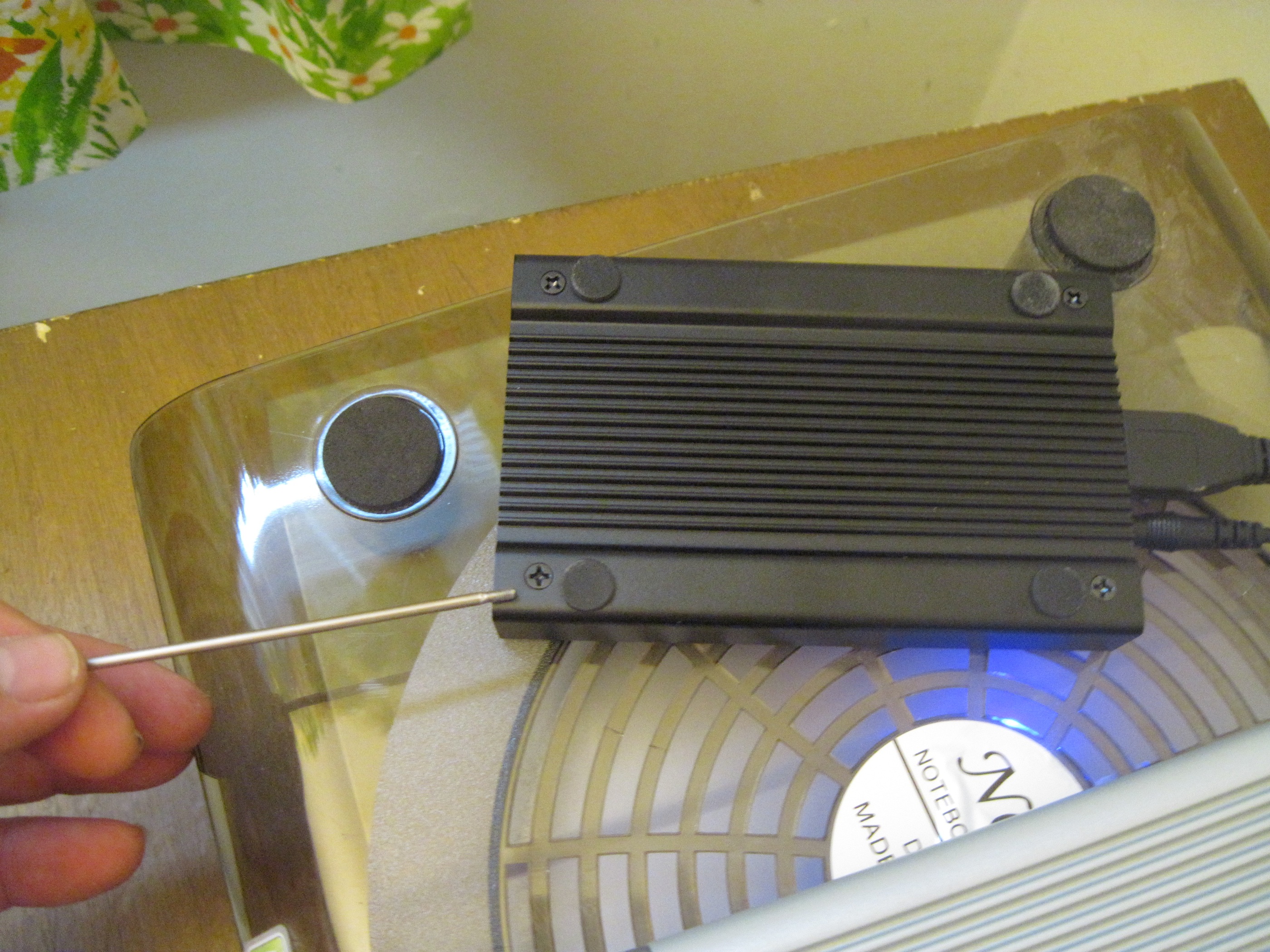

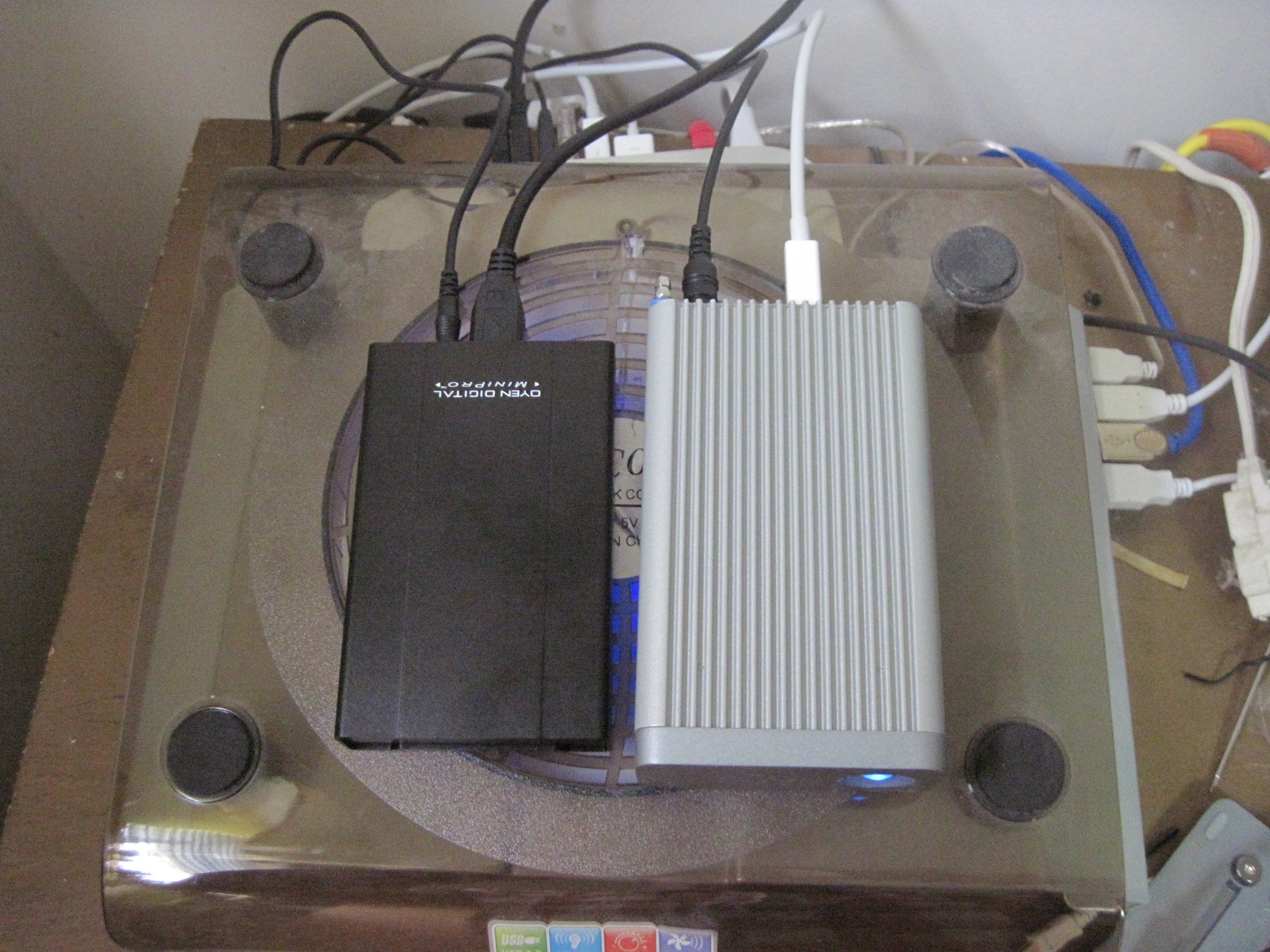

Okay the oyen usb 3 drive came in. solid metal well built. has a usb3 cable and a secondary usb to 5volt cable if your external ssd/hdd need it.
I have a samsung 830 ssd which can get 400 write and 454 read inside the mini with a direct sata connection.
well the black magic test is far better for this then the usb3 seagate adapter cable.
this case is getting 232 write and 270 read vs
170 192 as seen above with the seagate usb3 cable.
look 232 write and 270 read vs 400 write and 454 read look bad but for real world this only counts with a clone to a second ssd or if you are over writing the drive with 0's.
on xbenches test the oyen case scores better then the seagate cable. the long reads and writes are much better
207 /284 vs 182/197 but random is a push 28.7/13.1 vs 28.8/12.7
aja the oyen wins
224/270 vs 166/192
this case offers
0 risk and a 30 dollar price.
so it is very tempting .
http://www.amazon.com/MiniPro-2-5-i...UTF8&qid=1351885709&sr=8-2&keywords=oyen+usb3

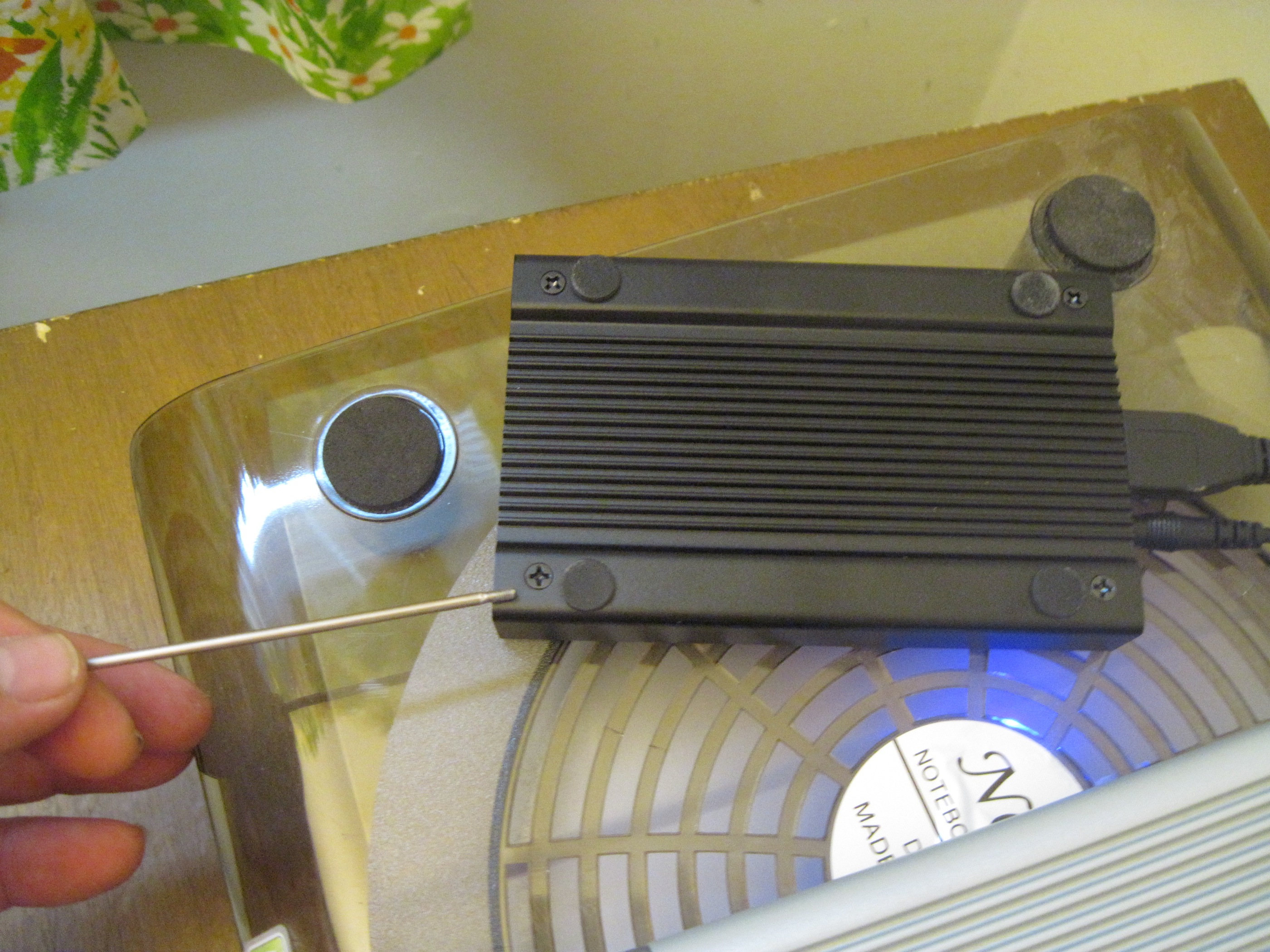

one last word this comes with 4 stick on rubber feet don't cover the screws when you attach the feet. you won't be able to swap the drive!
