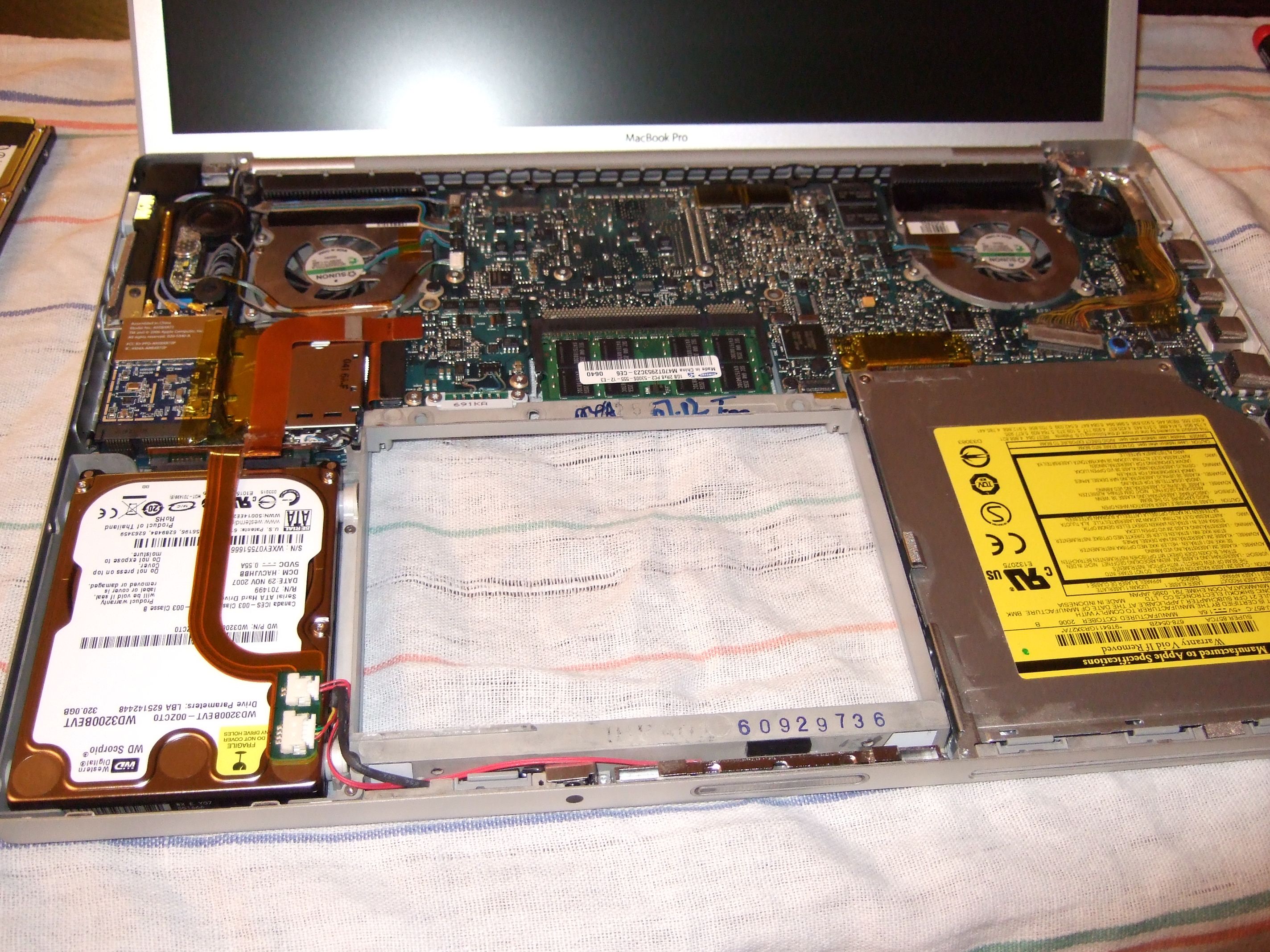

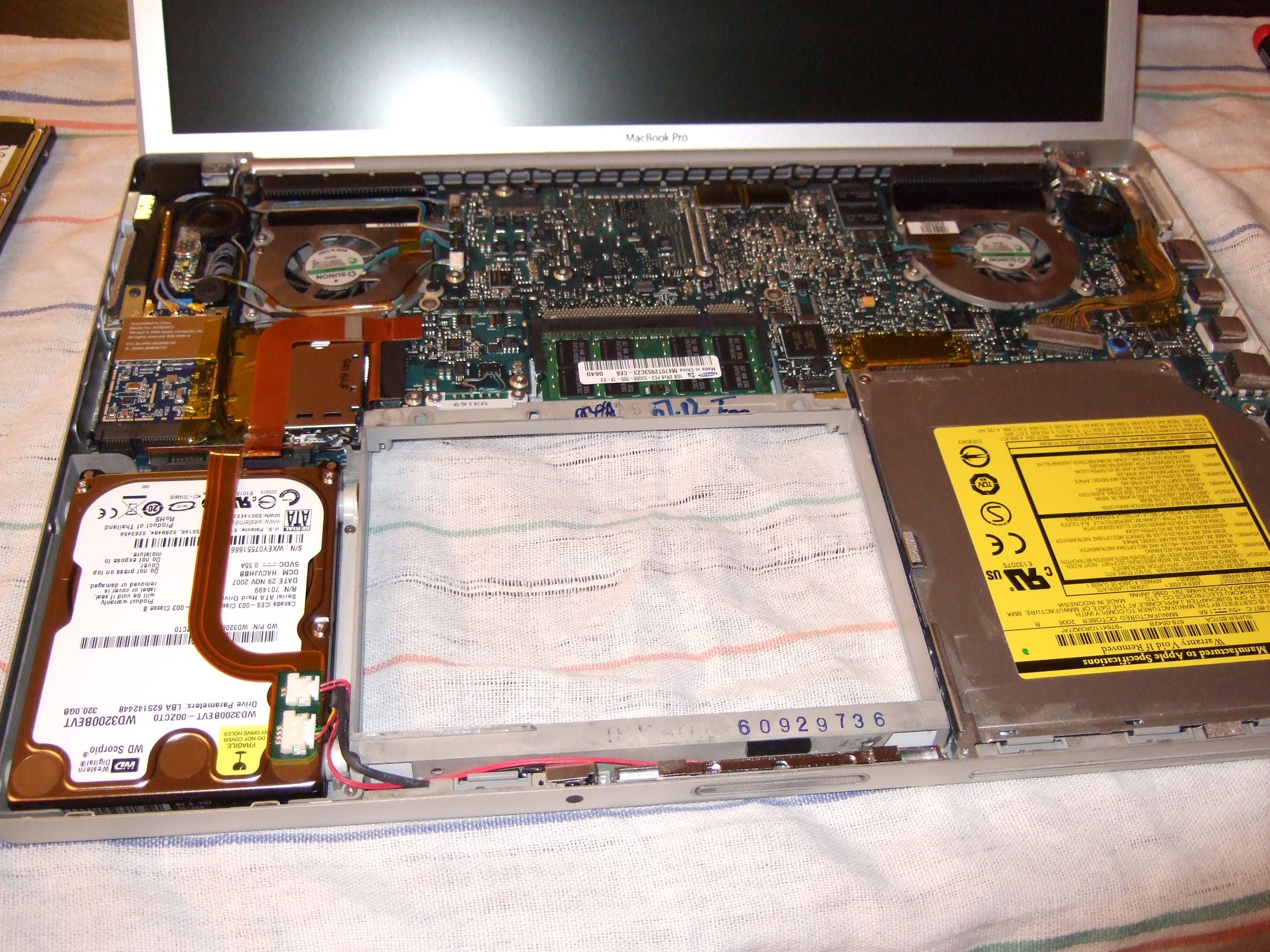

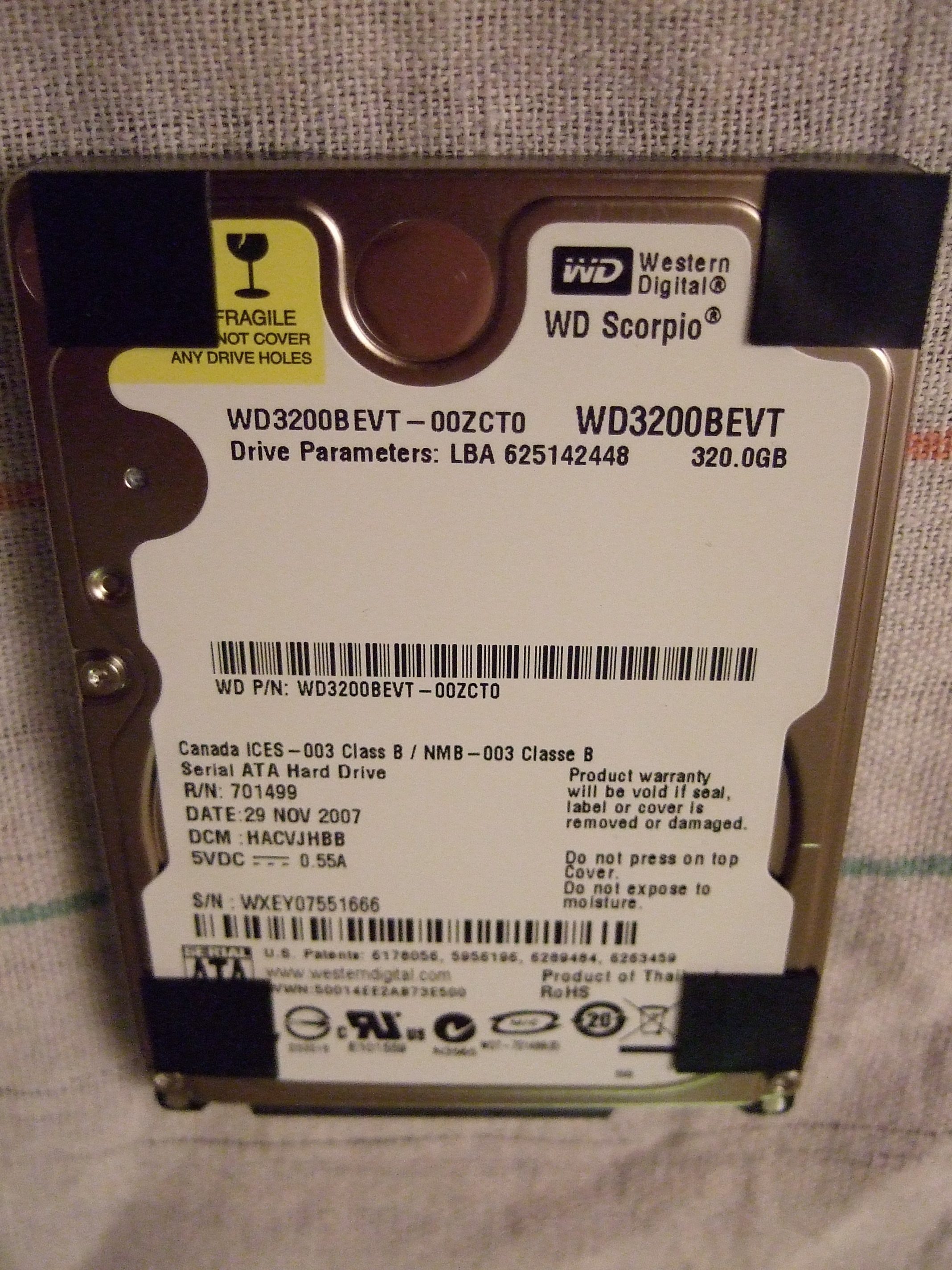

is where my MBPro is since yesterday 🙂 everything went well except a little fear when removing the upper case, it was stuck and suddenly snapped off, i thought i broke the ribbon connected to the mother board 😱 but all went fine 😉 here's a pic of the guilty one in its new home 😀

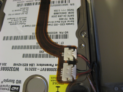

Hey deadpixels, the breathing hole on the hard drive is directly where you stuck the ribbon cable with the two white connectors, by covering it up you may be preventing air from entering and exiting the hard drive which could reduce its lifespan and cause the head to crash.
I would recommend you re-position that cable before permanent damage is done to your hard drive!
did you use any adhesive to lay that ribbon cable back down, or was it tacky enough to just re-stick. Have you noticed more noise, vibration or a decrease in battery life?

I just installed my new HD (same as the OP) yesterday, I love it, but I'm afraid that I actually may have positioned the cable over the breathing hole, just like you were saying.
Where exactly is this breathing spot for the HD? Can you copy the OP's image and re-post it with a circle around the spot I should avoid covering? I'm going to open my MBP up again and ensure that I positioned everything properly. I didn't know that I would be blocking any airway before replacing my HD 🙁
Where would you suggest repositioning the cable? It seem to be difficult to kep the breathing hole open without twisting the cable too much to the side.

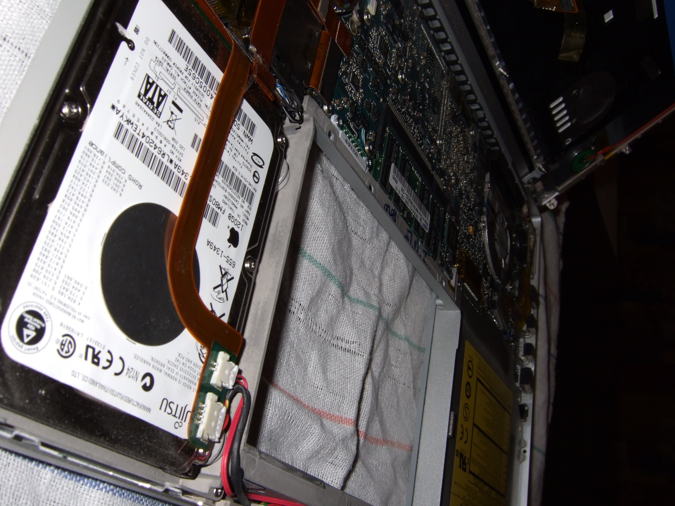

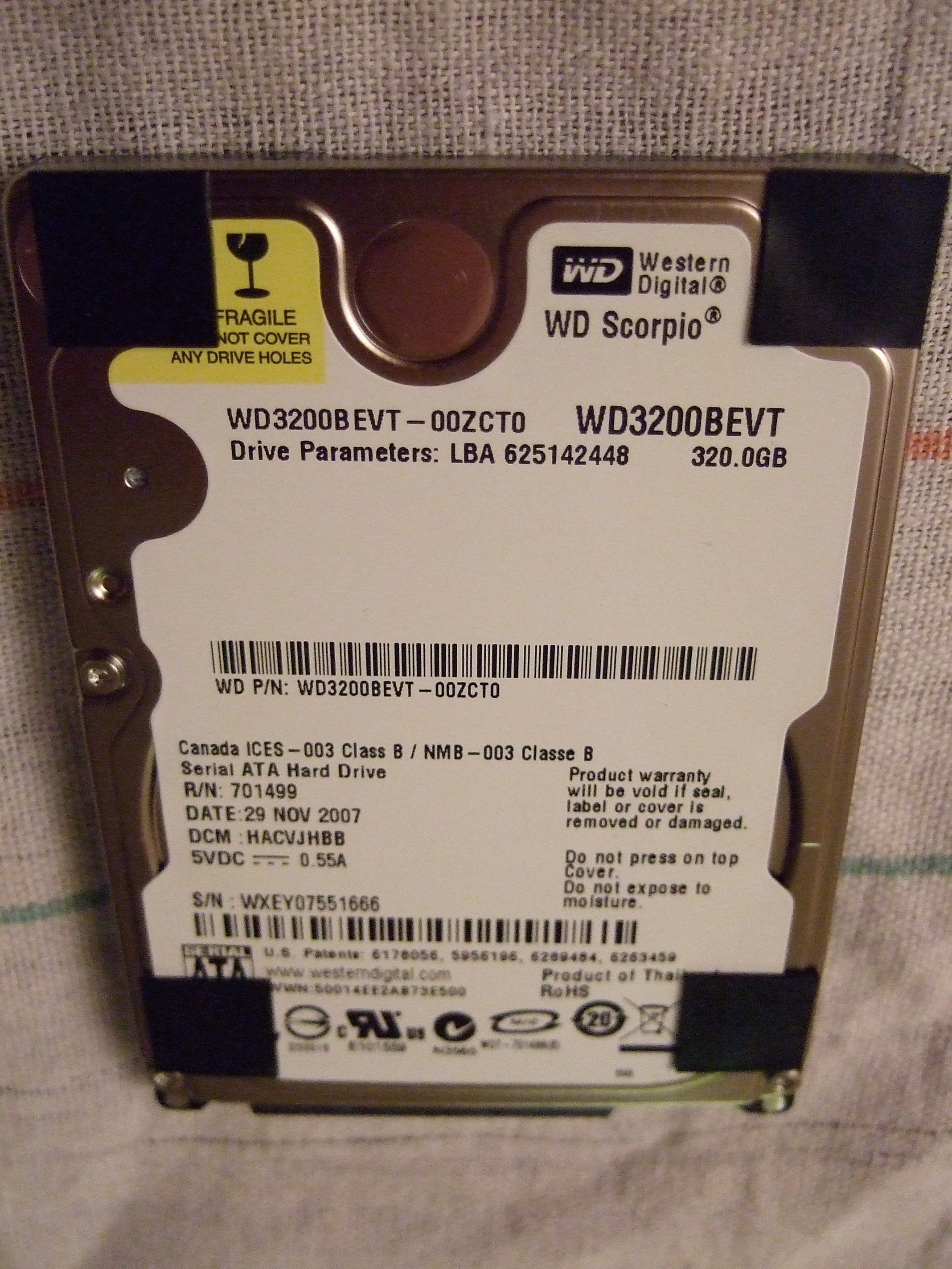

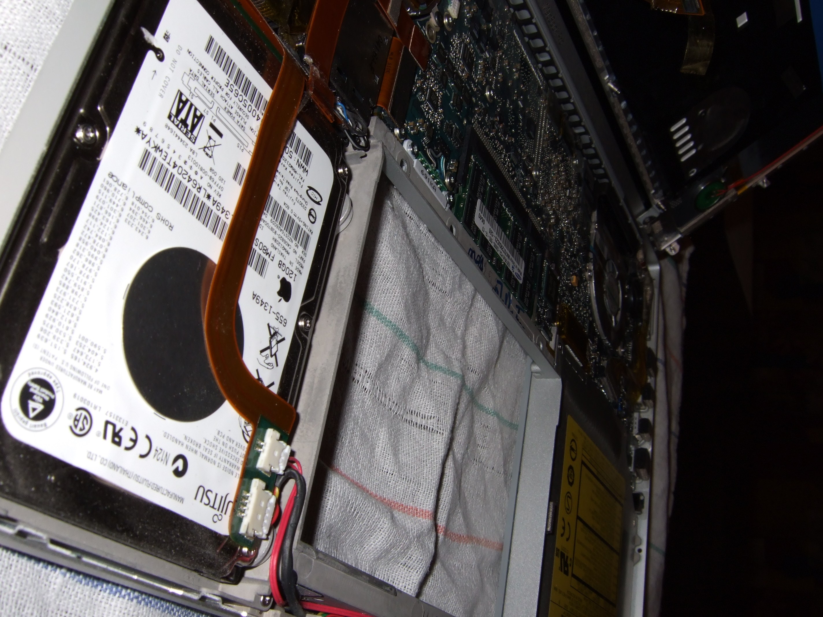

Actually the hole on the original Fujitsu drive is not covered as it is on the other side (see my pic). it seems DaLurker might be right as it looks like on my other pic that there is maybe two holes on the WD drive and they are right under the ribbon cable! but it seem there i no way to move the ribbon cable any other place without twisting it quite a lot (see my other pic). some have installed the same drive a while ago and i did not hear any problems due to that yet so i'm hoping it'll be fine. if someone come up and confirm it's risky i will open again and try to do something about it.

Parts of the drive are not pressure sealed, so these holes are basically eustachian tubes for the drive. So, as long as the hole is not sealed over, the air pressure can equilibrate. All you would need is the tiniest 1mm thick shim under the cable to create a gap that would maintain the very low equilibration air flow under altitude changes.

thanks, i found it using google too, since the glue was kinda weak where the ribbon cable passes over the holes, i suppose my hard drive will be fine, i don't feel like opening again just to check.

Yeah I'm not a fan of opening it up to check the computer. Actually I bent the cable a bit to avoid the breathing hole and it worked out well for me. I would still recommend you reposition the cable however it shouldn't be a problem since the ribbon on top should allow for some air flow, but thought I'd point it out to you guys anyways.
To answer a previous posters question re: Apple factory, like deadpixels said the Fujitsu drive's breathing whole is on the other side of the hard drive.

I repositioned the ribbon connector just off the breathing hole, keeping half of it covered. No problems with twisting whatsoever, it repositioned nicely.
