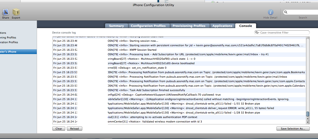

Broken Pipe....ATT??

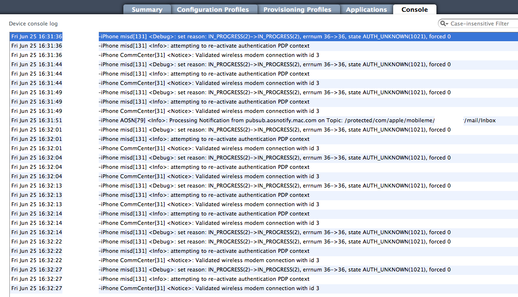

I keep seeing this "Broken Pipe" in the Apple Iphone config util.
