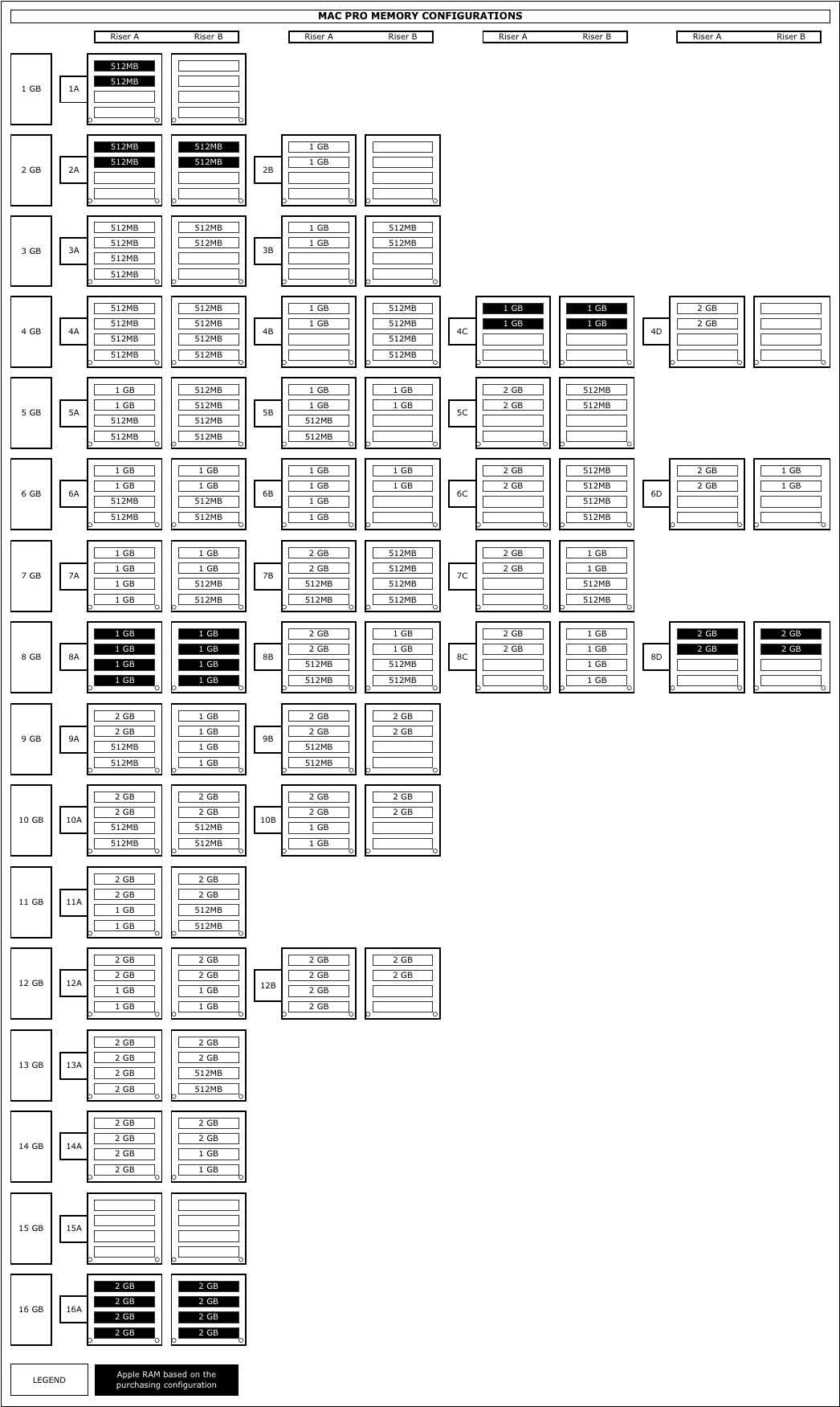

If I do the 8GIG addition, and place 2x2 in each upper and lower trays, should I leave the original RAM in, or not use it? If I use it, where would it ideally be placed?
For 12GIG - how to ideally place these? fil top tray first, then 2 in bottom tray? Then place the 1GIG RAM in lower tray as 3&4, or leave out?

... how to ideally place these? ...
Yes, this has been asked a lot but I can't remember the thread. I downloaded this schematic from the last one.

does that chart hold for the new model, though?
No idea, but I don't see why it wouldn't. Isn't the basic architecture the same?
The Mac Pro (Early 2008) manual states:
Two DIMMs (standard configuration): One on the top memory card and one on the bottom card
Four DIMMs: One pair on the top memory card and one pair on the bottom card
Six DIMMs: Two pairs on the top memory card and one pair on the bottom card
Eight DIMMs: Two pairs on the top memory card and two pairs on the bottom card
