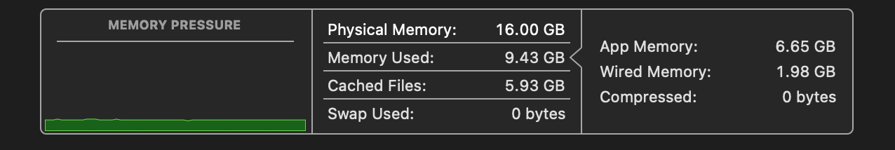

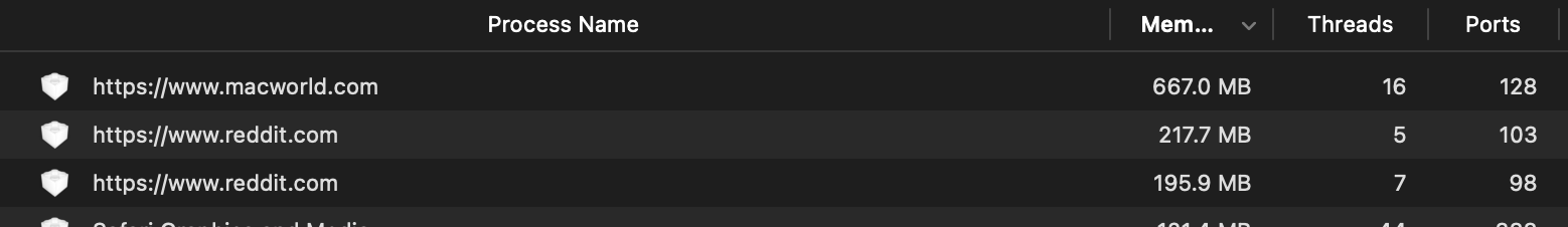

I can replicate this behaviour on an M1 pro 14 16Gb too..... intel beats it hands down for memory usage... is this big memory bug leak problem I get reading about??

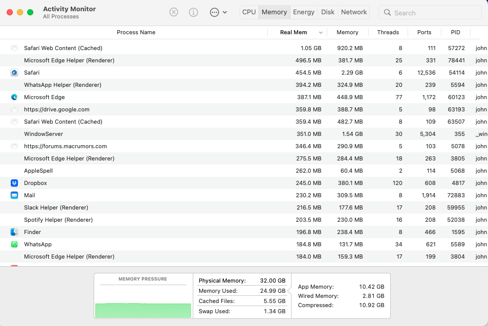

It's probably nothing to worry about. I use WhatsApp and would think that it could easily use 1GB if left open for days. I've just opened it, and here is the memory usage (showing both "real men" and "men" in Activity Monitor). You can see that WhatsApp has a helper (renderer) and the app itself.
I'm generally operating with 1-5GB of swap used, and it occasionally goes into the yellow pressure with 32GB. On my 16GB M1 Mini (and identical usage) I would spend most of the time in the yellow, and it still works fine. Memory mostly seems to be taken by web pages - MacRumors.com is often >1GB!
