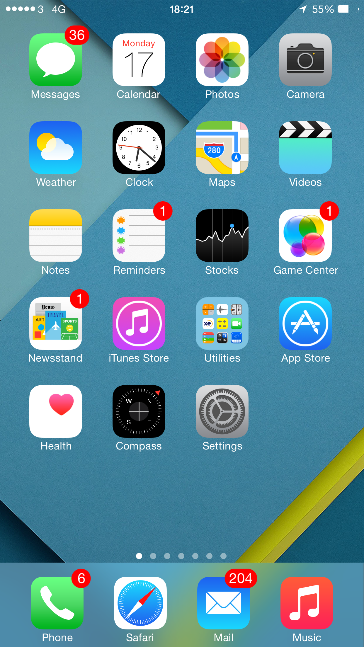

Also can you share wallpaper please 😉
Sure, it's the official Android 5.0 Lollipop wallpaper. Here's the cropped version I'm currently using: Link An alternative version (also cropped): Link
Be sure to zoom out when setting the wallpaper.
Cheers for wallpaper.

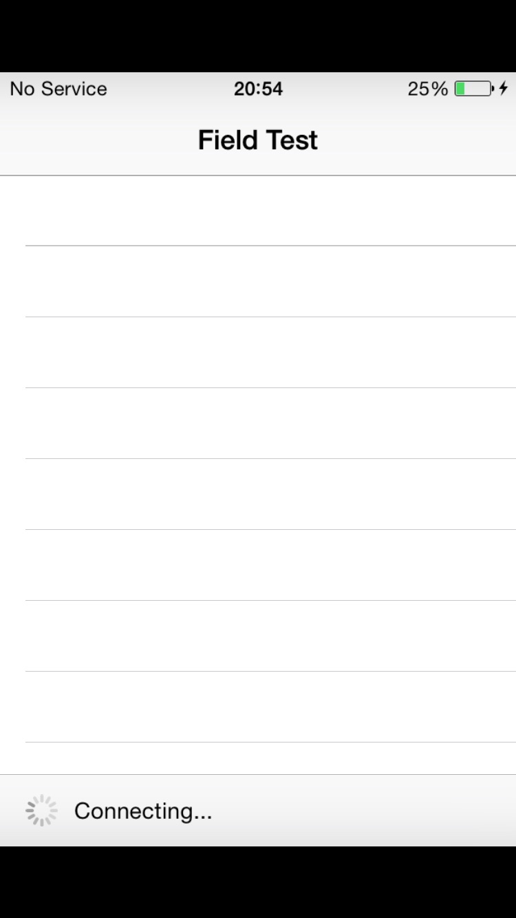

Also, try testing the signal in Field Test Mode. Open the Phone app, type *3001#12345#* and press the call button. What number are you seeing on the top left of the screen?

Installed latest update. No change. Tried resetting network multiple times. No good. Full restored iPhone twice.
This is screenshot of field test when 4G toggle on, in area with known strong 4G. Sutton, London.
