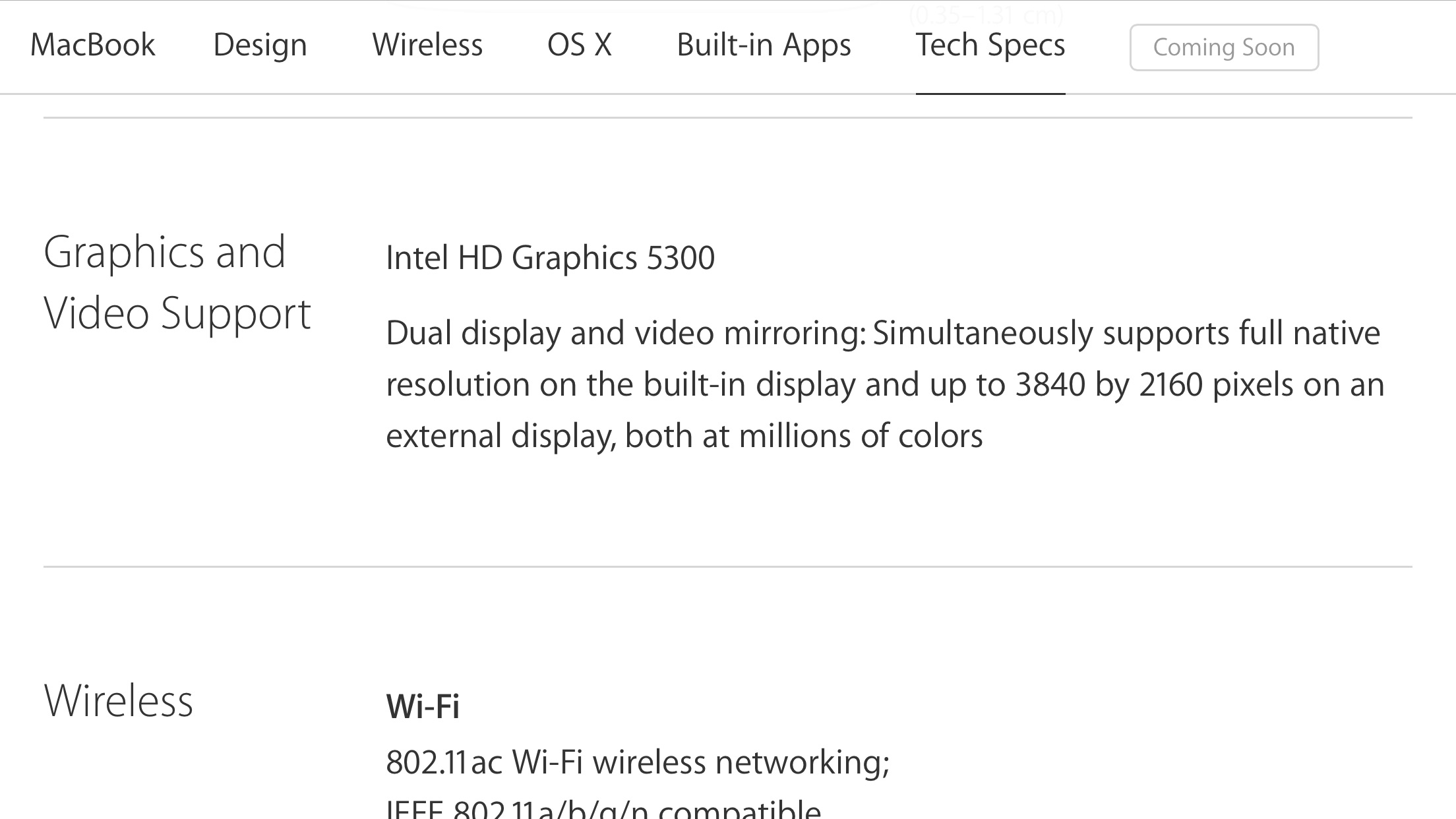

It can. Apple's product page tech specs list that resolution as its max "up to" for an external monitor. USB 3.1 does native mDP 1.2, so it is obviously technically possible. However, Apple curiously isn't providing a USB-C to mDP port option in their multi adapter offerings, just HDMI or VGA, neither of which are capable of the high resolution, so you're getting a max 1080p there.

Yup, it can, two external monitors simultaneously at up to 3840x2160 resolution while running its own at native retina resolution. Not "true" 4k, but close enough.

Apple wouldn't be listing 4K as supported external resolution in rMB specs, if it wasn't capable of it. Modern GPUs are surprisingly good even in ultra-portables.

rMB users will be able to use a 4K (3840x2160) secondary display, Apple is giving clear info on that. No debate.
