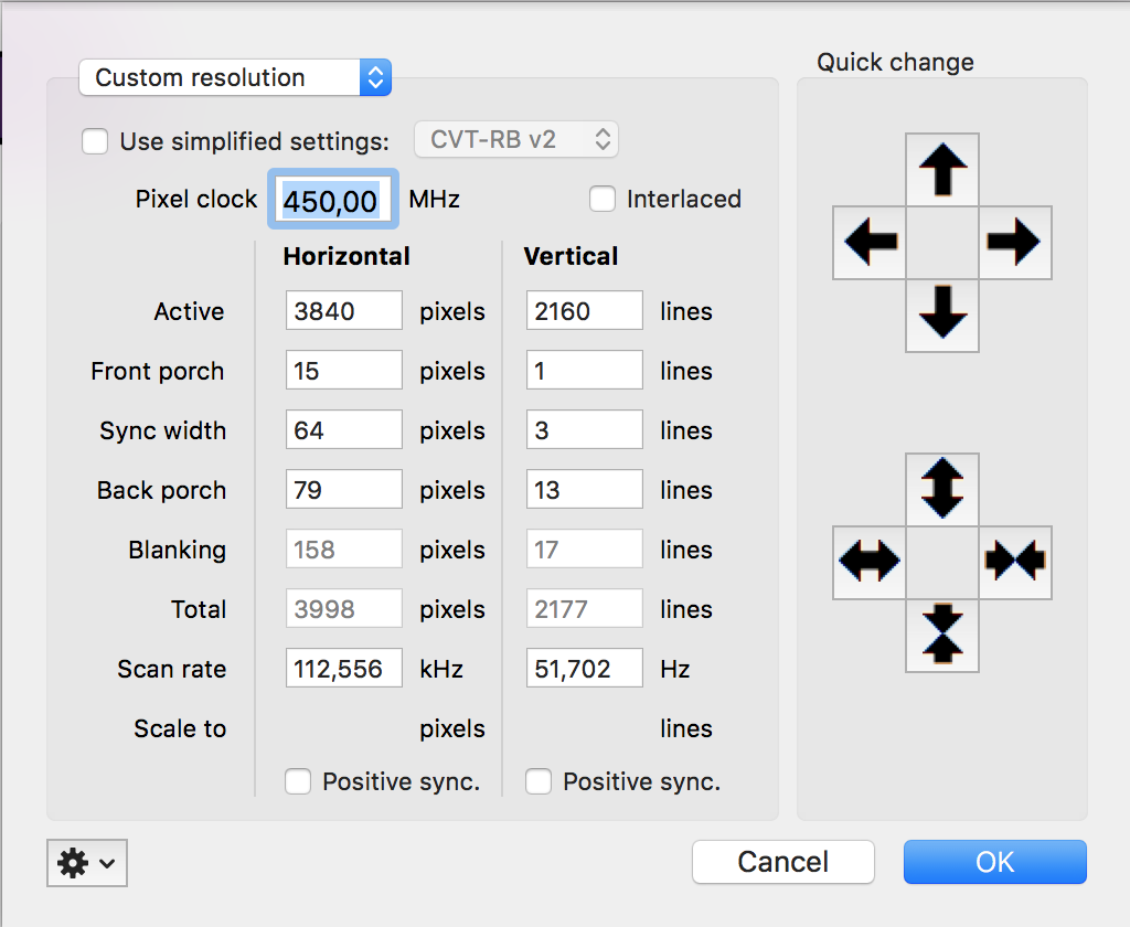

Hi,
With the 2013 13-inch Haswell rMBP it is possible to run at 3840x2160 or 1080P HiDPI over DisplayPort at 52Hz. This is because the max clock rate for the 13-inch over thunderbolt 2 is 450 MHz.
To get this resolution, use the settings in the screenshot I've made with switchresx (attached).

Hey guys, i set custom resolution on my macbook pro 13 mid 2014 like on this screenshot (attached) and i have freezes 🙁
My monitor - LG 27UD58-B (connected using DisplayPort).
Help me pls 🙂
