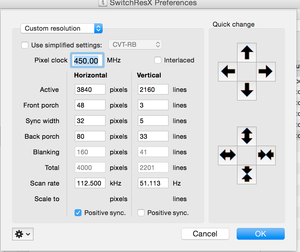

Just received my Dell 2415q 4k monitor. I plugged it in to my MBPr 13" Late 2013) using the supplied display port to mini display port cable via thunderbolt 2 port. Opened up Switch ResX and entered a custom resolution of 450 pixel clock, and set the resolution to 3840x2160. saved and rebooted. I'm pretty stoked that this worked, my little MBP is driving this new monitor at HDPI 1080p @ 51Mz.

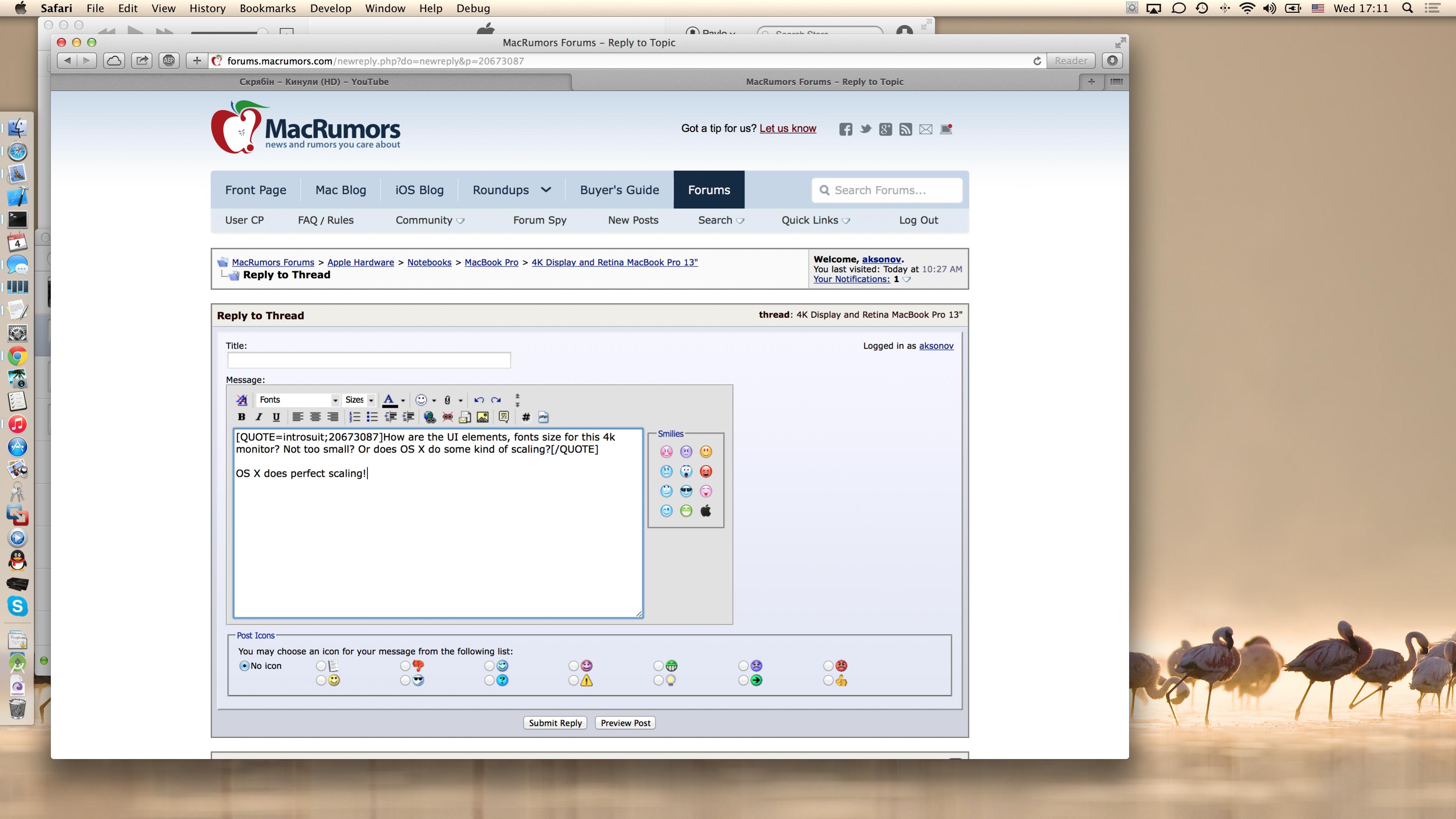

How are the UI elements, fonts size for this 4k monitor? Not too small? Or does OS X do some kind of scaling?
OS X does perfect scaling! I did screenshot, maybe it helps.
P. S. Update. Yosemite OS X works terrible with this monitor and SwitchResX - resolution is not stable and reset after each OS restart. Switched back to Mavericks.

Stempsons, I have the same MBPr & the same Dell 2415q, using the same cable. However, it goes black after choosing the custom resolution 3840x2160x450PixClock@51Hz. Works only at 1080p HiDPI and 30 Hz 🙁 .Could you, please, make the screenshots of settings in Switch ResX?
UPD. Solution: MST>Off
here's what i'm using with the mac mini i5 2.8
