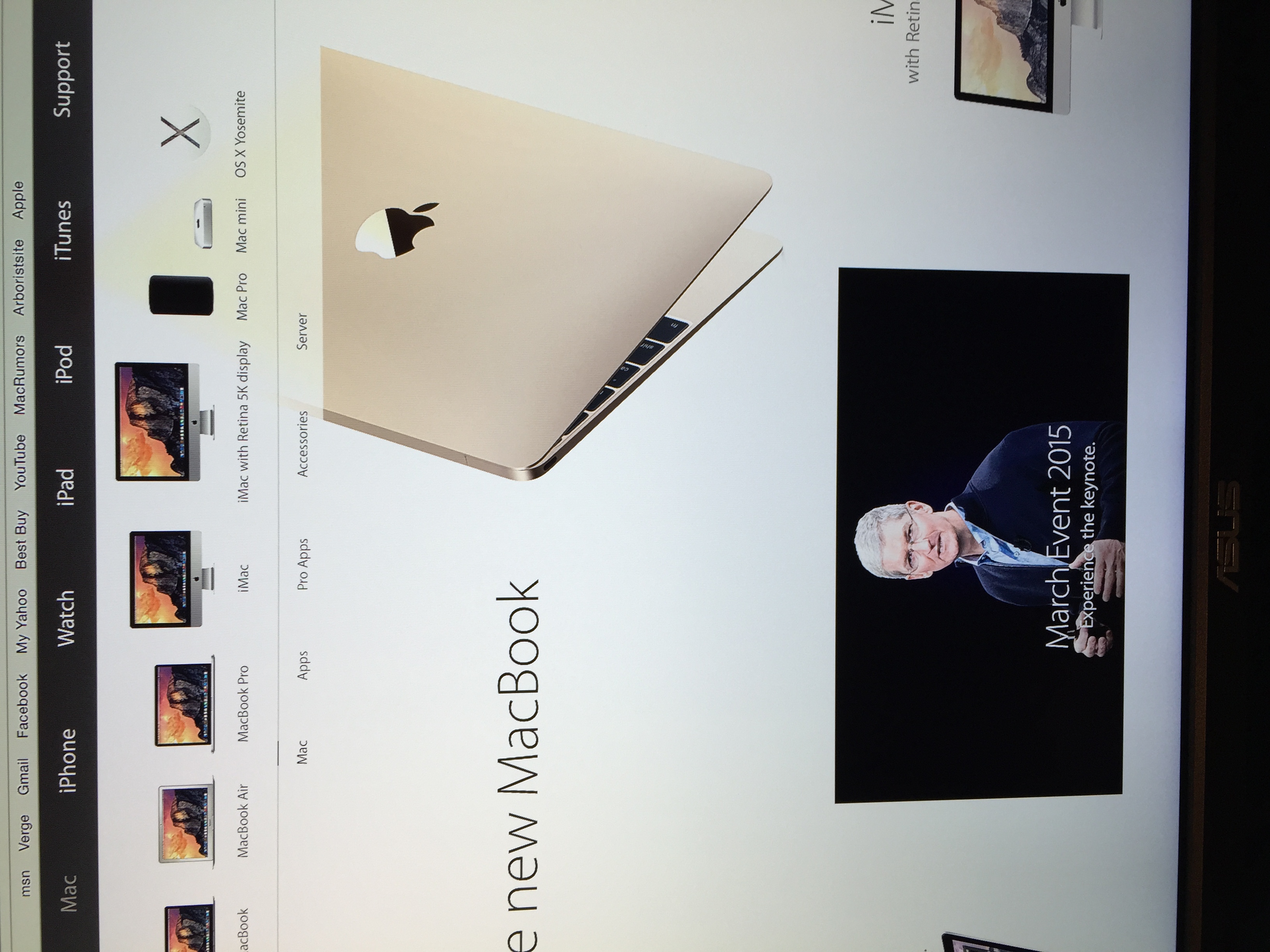

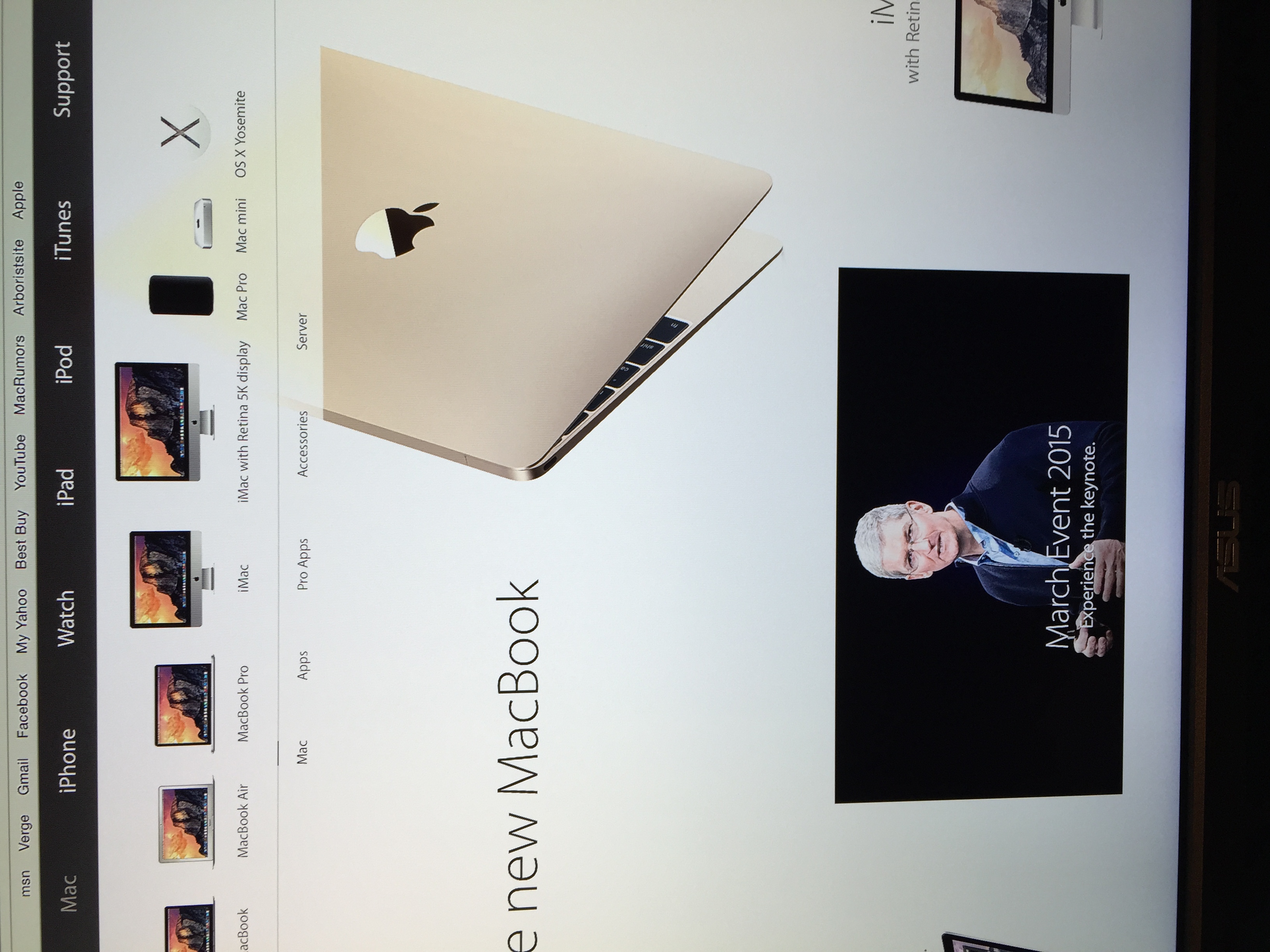

Here is my 2015 - 13" Macbook Pro running 1080p retina? This is on a ASUS pb287q and it looks really good. To me there is no more slow down or choppiness than when I'm running the Macbook Pro by itself. I'm running 60 Hz but I think the video is 30 Hz. I've enjoyed this setup and will keep it to do light photo editing in Pixelmator and general internet browsing. I am on a slow internet connection of 5mb so some of the web delay can be blamed on that.
https://youtu.be/1GHpbgHHbEk
And here is a picture taken with my iPhone to show that it looks better than the video can show. Actually it looks better than this picture can show but it is closer to what the ASUS really looks like.

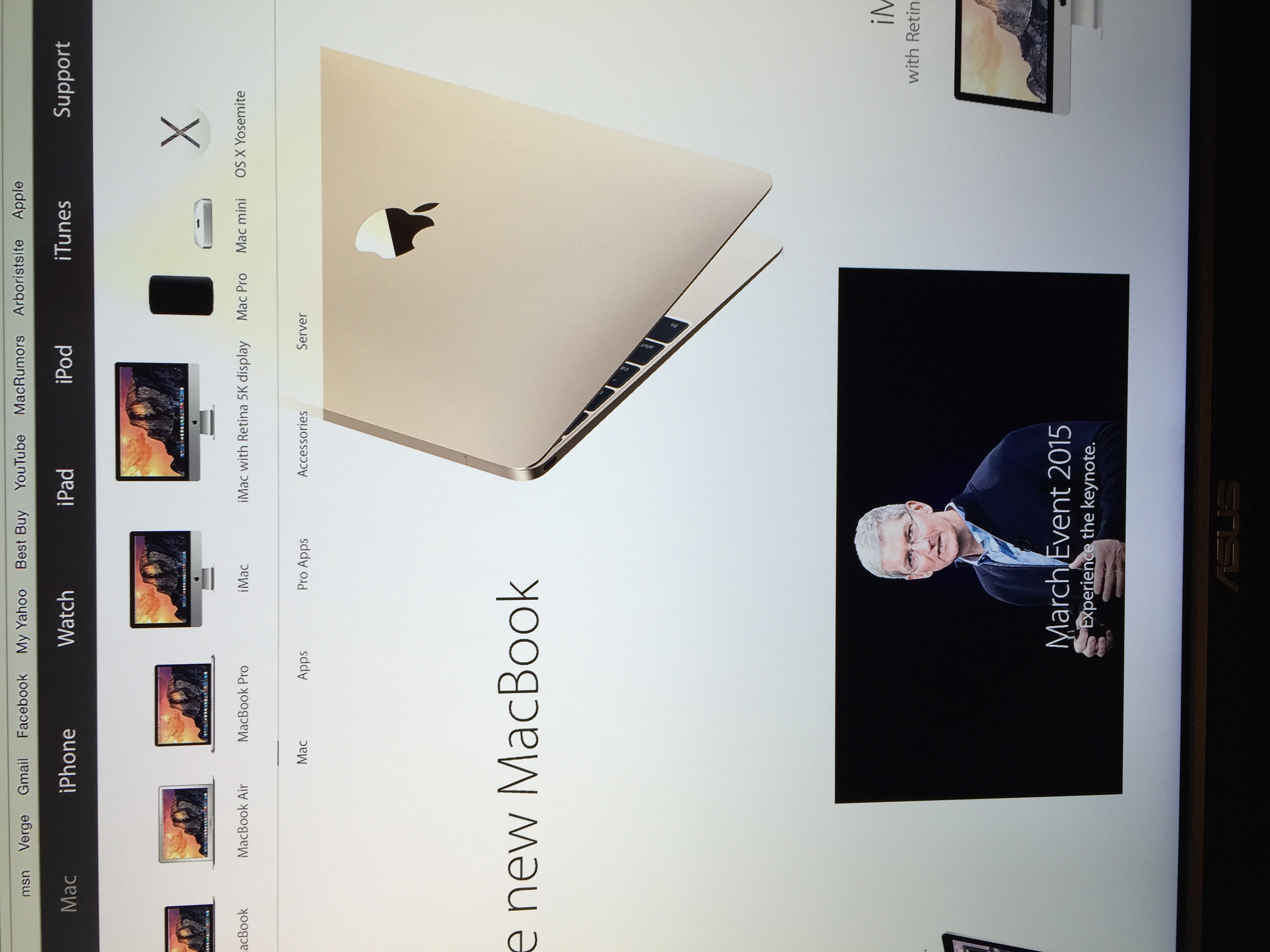

Looks great. I'm looking for a 4k display to have "retina" quality on a desktop. Where did you buy it ?
