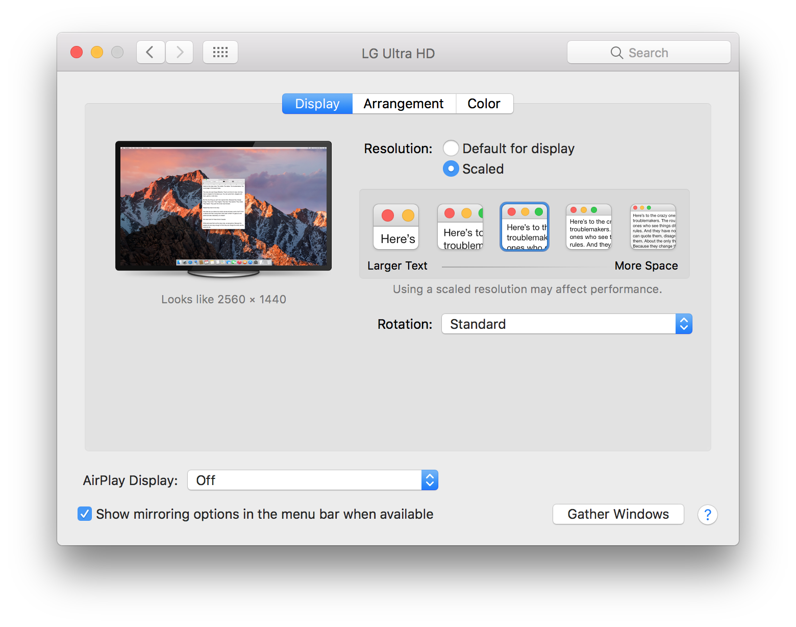

The sad part is that in Beta 3, a 2560x1440 hi res option appears after a fresh reboot, but goes away after a system sleep or if I reset the monitor. (LG 27UD88). I took a screenshot while it was enabled.
Also, I was never able to get this option to display with other 3rd party utilities either. The default 2560x1440 looks pretty terrible/pixelated.
Is your rMB 60Hz patched? Did you try option-clicking on the scaled option under display setting? I purchased the 27UD88 this weekend when it was on sale at Fry's and have been playing with it on both non-patched 2016 m7 rMB and 2015 13" MBP. I have the option to run 2560x1440 hi res on MBP, but only low res 2560 on rMB using USB-C connection. Also my monitor starts flickering when I use the 2560 @ 60Hz on low res on rMB, but not at 4K @ 30Hz 🙁

Yes, I installed the patch. Still not sure if it showing the hi-res (semi-retina 2560x1440 was a defect or feature). I'm updated to Beta 4 now to see if that option goes away completely, or maybe is consistently supported. 27 inches is pretty large for 1080p, retina or not. Big step down in real-estate from the Dell U3011 2560x1600 I stopped using because I couldn't find a charging + display port solution for under $200.
