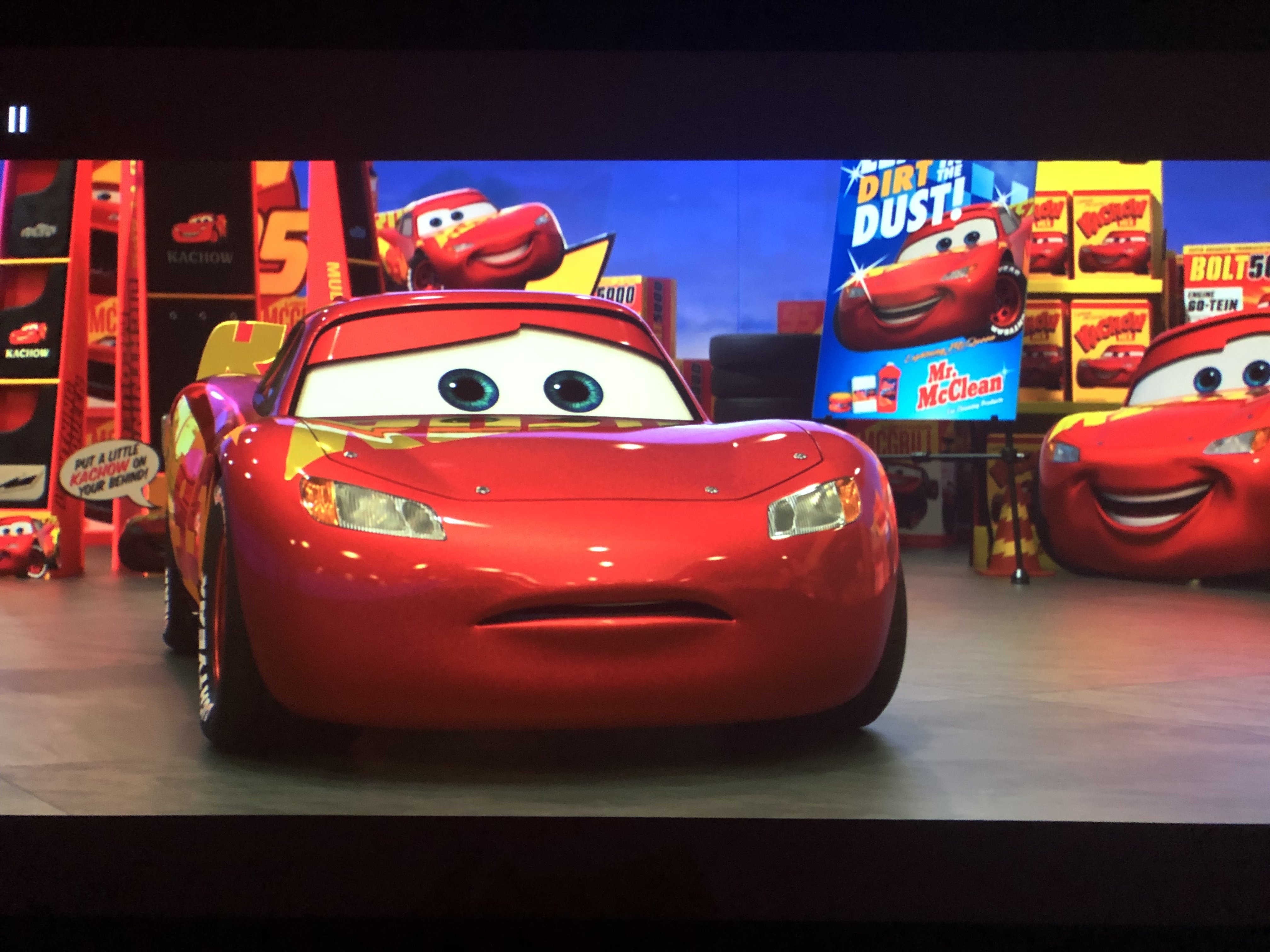

If you want the best possible picture you purchase a Lumagen video processor which actually produces an HDR image in an SDR container.
In addition to that, you can do the same with a HTPC as a source. And there's the upcoming madVR box. Don't get me wrong, Jim knows what he's doing with his processors. I've been Beta testing their stuff for ages, before they were actually released to the public (I think I still have one of their HDPs in the basement, which I ran with a Barco 9" CRT projector). But it's time for some competition.
Obviously you need a good calibrator to make all this happen. I did this with my Sony 4k projector/130" screen and at 12' the picture is stunning, absolutely stunning. The video processor (Radiance Pro) will run you about $10k and $1k for a decent calibration.
Calibration is something most people forget. They just buy, set it up and are done when a proper calibration can make a night and day difference. Also, unless prices have changed, the $10k is for the biggest 4446, the others are cheaper.
It's also well worth it to consider the use of an anamorphic lens. Which means you won't have a brightness drop when watching scope movies. Another option when projection + processor + lens is considered would be something like a cinemascope Barco projector, which comes with a scope format DMD and does everything a processor does in it's firmware. So no Lumages required in such a case. The other solution would be more modular though, so processor + lens can be kept and the projector swapped out for a new one. This is all a moot point when $1400 is the budget. A TV is the much better option in this price range it just comes with a really small display in comparison.
