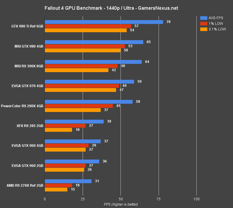

By the way, 980Ti should do better than that, at least 40FPS doesn't match the general a 980Ti / gaming review's report. Even the ref 980Ti can perform well above that, your hybird should do even better.

It's possibly lower because it can only run as pcie1.1 rather than 2, or limited by the 3.46Ghz CPU.

PCIe 1.1 doesn't affect much and it won't cause a 50% performance drop (in fact, even not 15% in general).
If CPU limiting, let 680 do the Phyx won't help anything. It's still CPU limiting.
That's why I think something wrong in your case.
