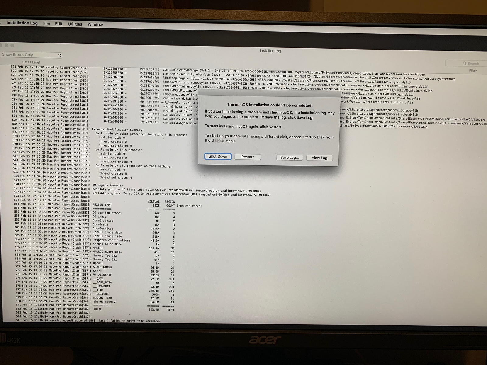

Hi, everyone I'm in complete meltdown here right now
I run a 5.1 with High Sierra. I wanted to upgrade to Mojave so went out and purchased a Graphics card that was recognised by Mojave, the AMD RX590. I took my existing Geoforce 980ti 6mb one out, all very carefully and installed the new card. Closed everything up and switched on, to my horror I now get this appear. I switched off re-installed the old card and switched on again but it's still here, I can't seem to boot into safe mode (not sure you can on a bluetooth keyboard) and I'm really freaking out right now about what to do. Please help!!

this is a failuremesssge of the last highsierra security update 2019-001
if you have a second computer than delete on the drive the osx install folder in root directory
or use the single mode for this
then use a fullinstaller of 10.13.6 in recovery mode from a stick
to install the system (no data will deleted)
after this, the downloadable securityupdate will run as it should

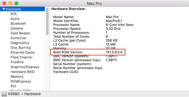

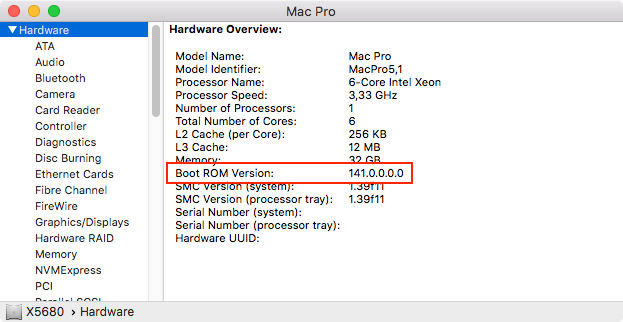

System Information / Hardware Overview / BootROM version

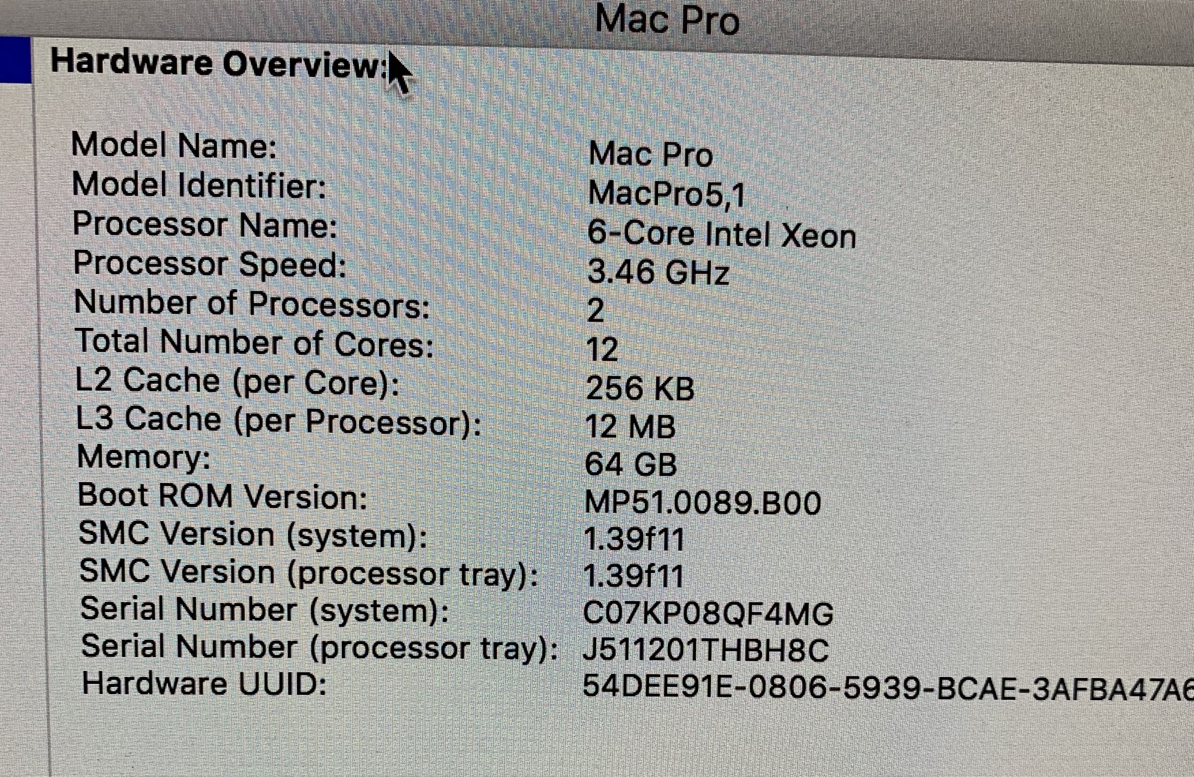

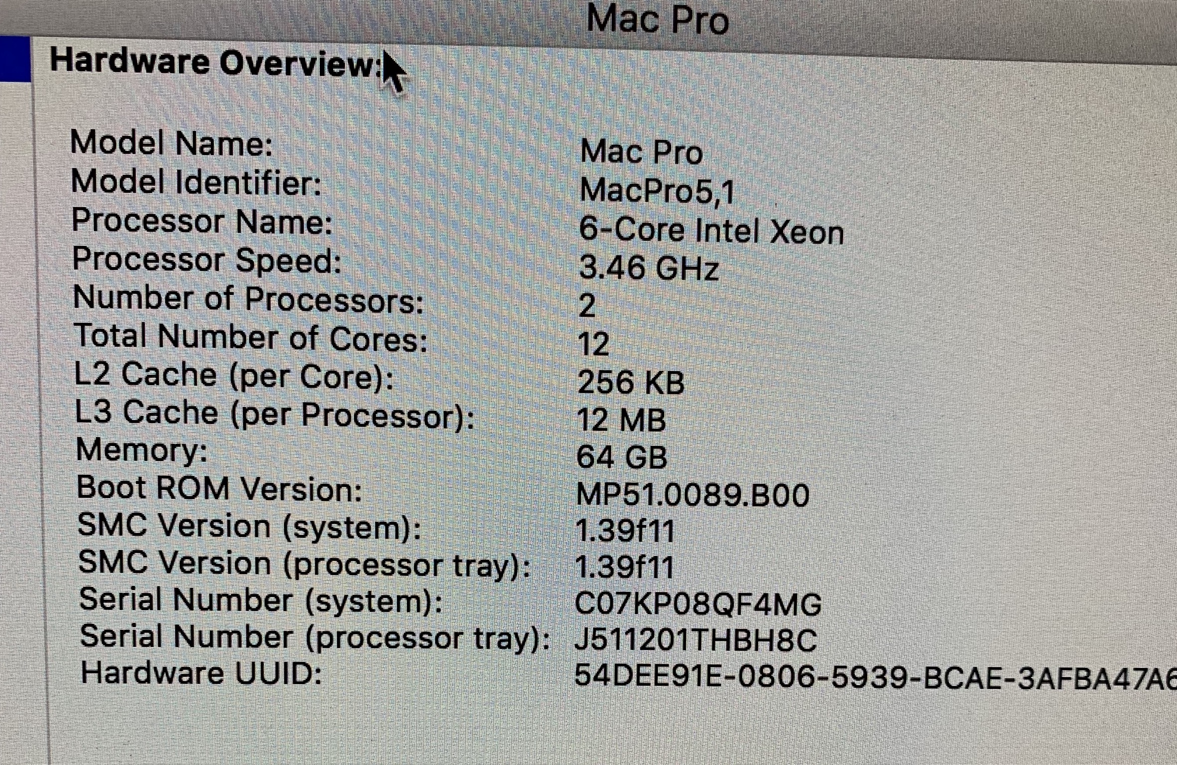

This is my current one:
Ok, you already have the first firmware upgrade, now you can install the RX 590 and do the second one.
