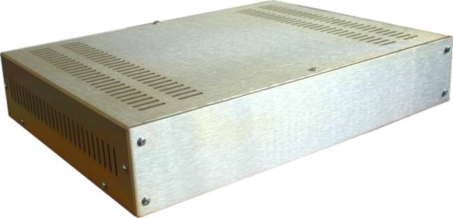

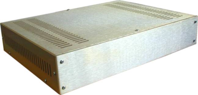

For the server I am thinking of a monster tinkering of some sort involving t-bolt ssds maybe a case expansion to this.
http://www.par-metal.com/product-ttp-20series.php
see thumbnail. Maybe a 2 by 12 by 12 size will work for my idea.
I do agree to tinker is to live. At least for me it is.
