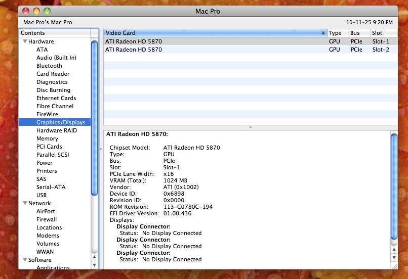

No problem neckarb I got it fixed seems the power connector for the odd was badly connected on the logic board. Now computer boots up with both 5870s 🙂 the only thing I would like to know is how you removed the bulky front cover from the modular power supply cuz it seems its not able to fully fit back into the odd compartment which will cause a problem as the top bluray drive won't be able to eject properly. Thanks for your help 🙂
Yeah I had to do the same thing, sorry should have mentioned.
Take a look 🙂

Ok guys so here's the issue. I have two Apple 5870s on hand, a modular power supply on order as well as a crossfire bridge connector. I am taking it upon myself to rearrange the mac pro with two 5870s and test whether or not crossfire will work under Windows 7.

UPDATE: CASE IS FULLY DISASSEMBLED 🙂
UPDATE 2: PCI POWER CABLES ROUTED PROPERLY. LOGIC BOARD REINSTALLED. RAM CAGE AWAITING REINSTALL ( HAVING SOME TROUBLE ) ... SHOULD BE FINISHED BY TONIGHT 🙂
UPDATE 3: CASE IS FULLY ASSEMBLED AND 5870s are running fine.... Still awaiting arrival of CF bridge 🙂
