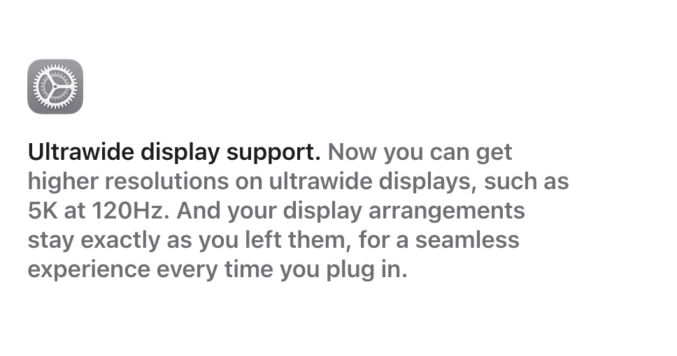

Maybe macOS 27 will fix this...? Fingers crossed.
Reactions: Riot Nrrrd

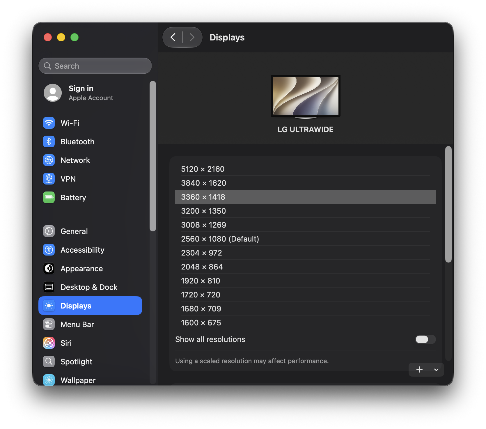

1780952082369-png.2636295
Indeed it seems fixed. This is from a M5 Air (not even a Pro). I can select all the resolutions in HiDPI.
Yet it is still capped at the same 3840x1620 HiDPI. I wanted to see resolutions above that because the 8K framebuffer limit is just dumb considering virtual displays can handle higher resolutions just fine.
