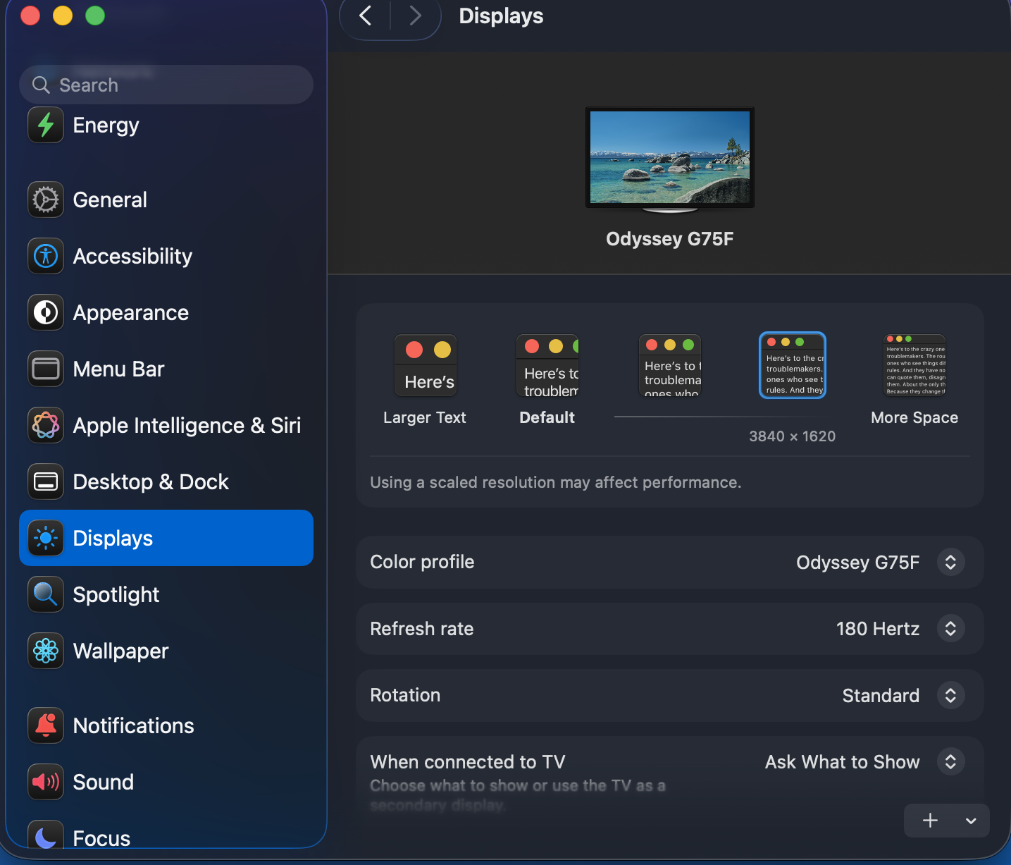

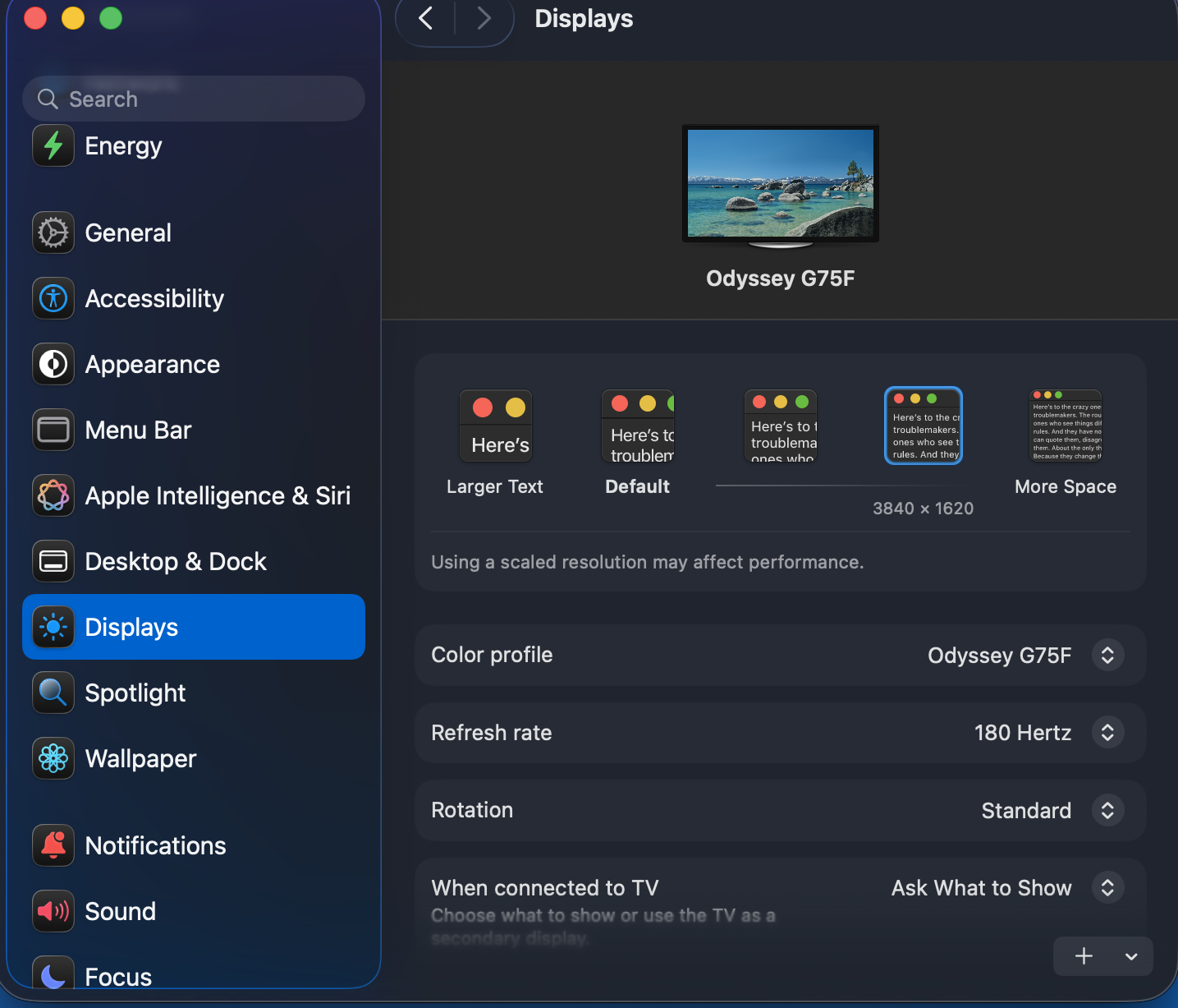

Really appreciate the information exchange here. I'm adding one more data point that I recently purchased a Samsung Odyssey G75F whose resolution is also 5k2k and I can confirm my Mac mini M4 base can support scaling to 3840x1620. Given this monitor has a refresh rate of 180Hz, it fits the theory that higher refresh rate can avoid this issue.
Reactions: T'hain Esh Kelch
Really appreciate the information exchange here. I'm adding one more data point that I recently purchased a Samsung Odyssey G75F whose resolution is also 5k2k and I can confirm my Mac mini M4 base can support scaling to 3840x1620. Given this monitor has a refresh rate of 180Hz, it fits the theory that higher refresh rate can avoid this issue. View attachment 2584495
I have been waiting for someone to confirm this before pulling the trigger on this monitor. Thanks!
