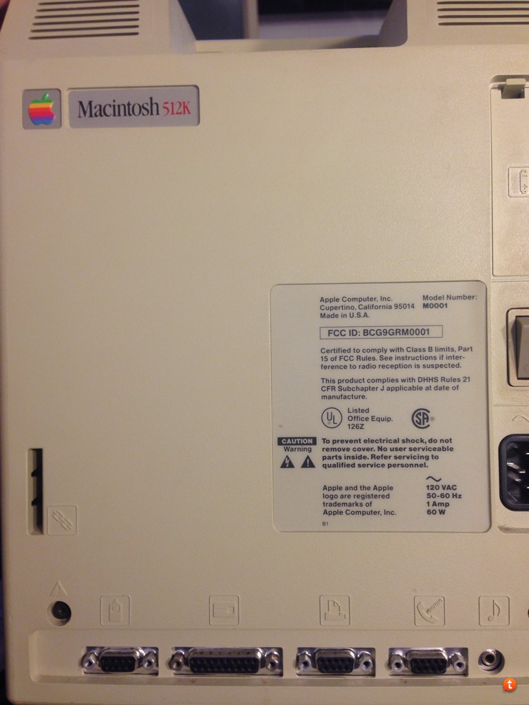

Well I'm about to leave for work but here is a pic from the back saying it's a 512k

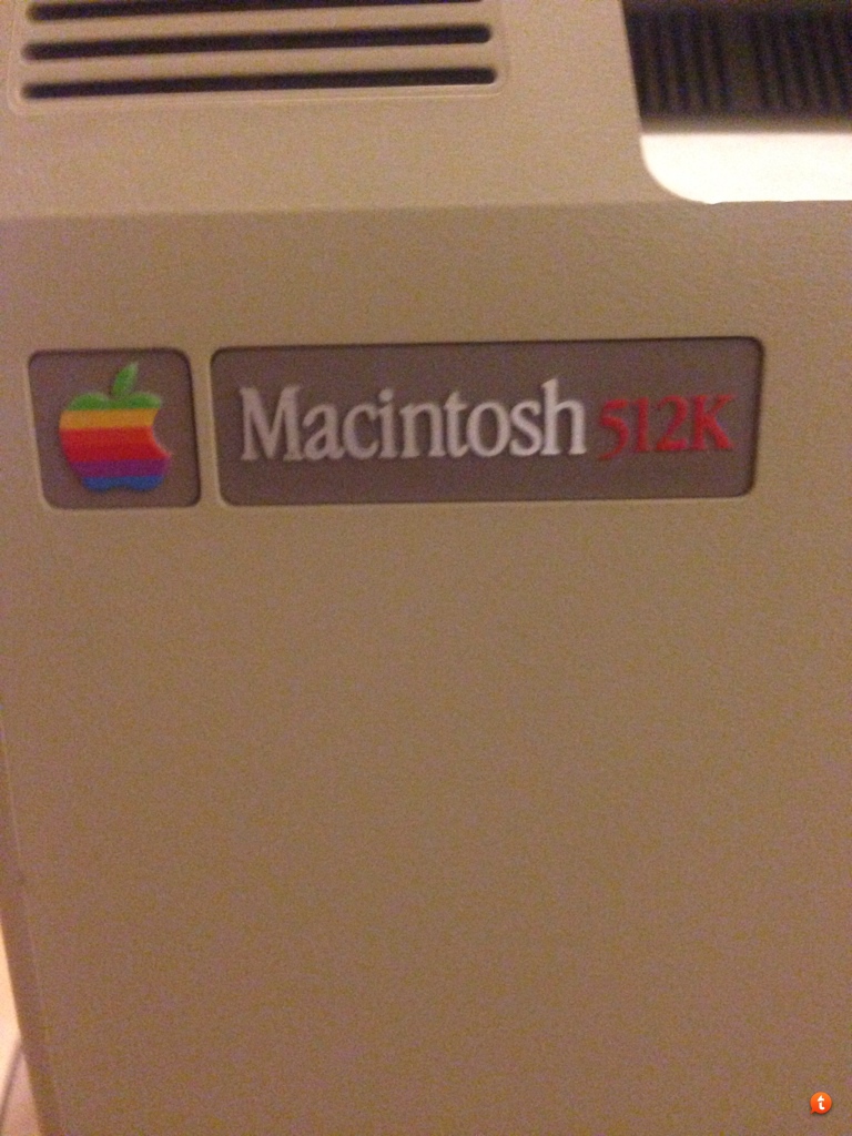

Is the "Macintosh" actually black, or is that the light doing weird things with the textured metal surface that is supposed to be there?

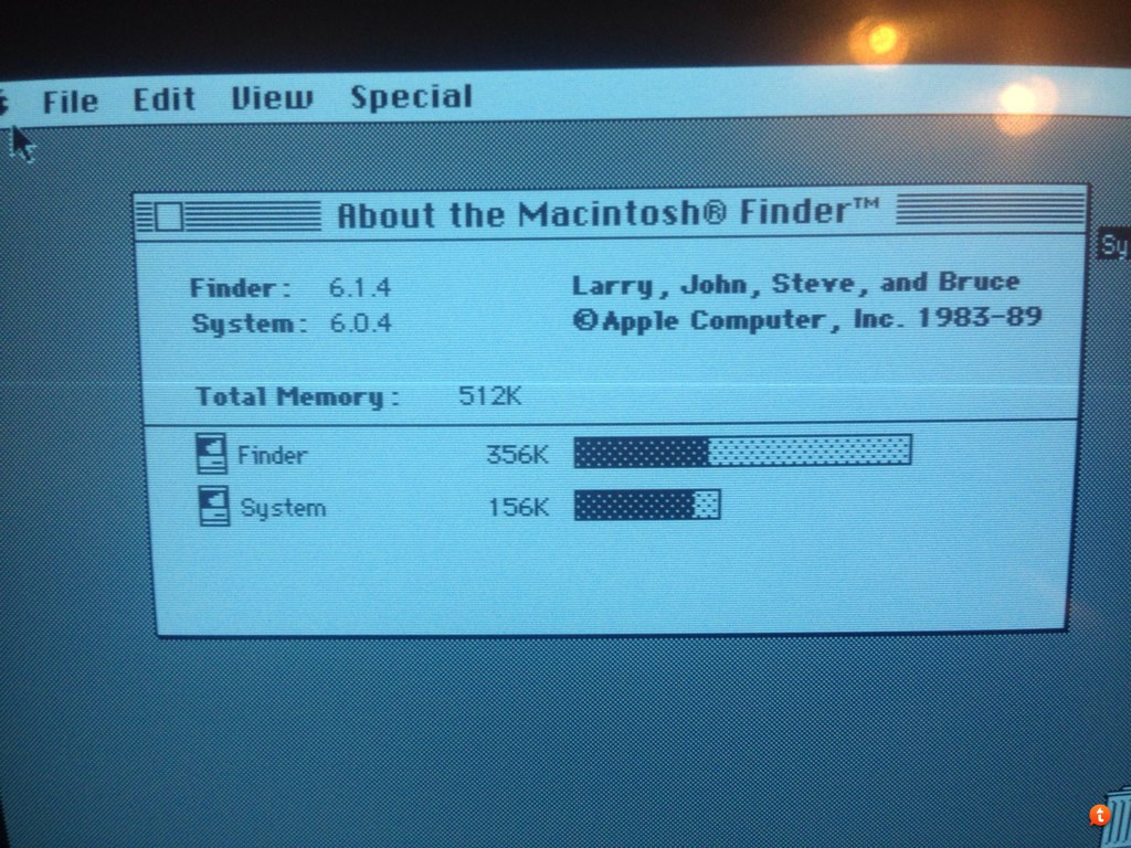

It's black, a sticker it seems. Here it is turned on with the SE system tool disk.
I'd say that it looks like you have yourself an original Macintosh (128k) that was later upgraded to a 512k by an Apple shop.
What's the serial number?
why do you need the serial? just curious? it ends with m0001. Also, I just looked it up on myoldmac.net and it shows it as a 128k macintosh.
The serial notes the manufacture date which could peg it solidly as an upgraded unit.
The first character notes the factory it was made, the second is the year and the third+fourth are the week of the year.

After looking my serial up it states this
"Your Macintosh 128 (M001) ....was the 5384th manufactured during the 29th week if 1984 in Freemont Ca"
So this is an apple upgraded unit? Like when you can order more ram for your mac today? Meaning this is an original Macintosh

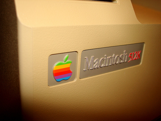

Your model number would not change, but it would sport the 512 badge on the back. I've just never, ever, seen a black one. Since those things are stamped aluminum with a painted surface, that's kind of interesting. If it' a flat sticker, then it's not an official Apple one, and likely the upgrade is some type of the others I described.
Functionally wise, they are -all- identical. Sure, a single piece board is probably more "reliable", statistically, since there is not a change of a connection going bad between things. But functionally, it's all the same.
Mine looks like it was made specifically for apple to use (the sticker) in upgrades. So is it more rare what I have?
The badge swap for the upgrade was the exact same kind. There is a pinhole on the inside that can used to pop the thing out. It's there for air pressure during installation, but serves nicely to get them out, too.

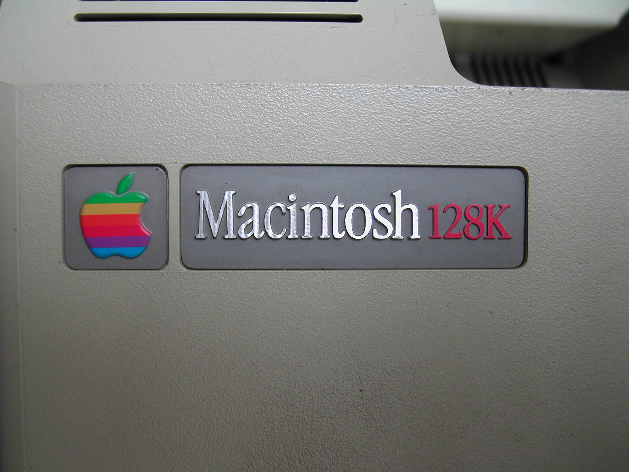

Here are some of the original badges, un-used (and an assortment of other Apple items) .. a "cheap" sticker never came from Apple.
In looking at your original image with closer scrutiny, it's evident that the sticker is smaller than the area it's inserted into, noticeably. That's not original/OEM at all.
Depending on when that was upgraded, it's most likely a third party upgrade, a non-Apple "authorized" shop using service parts, or a board modified by hand, and whoever propositioned some stickers so the work could be denoted "nicely" outside of the case. But from Apple, not like that.

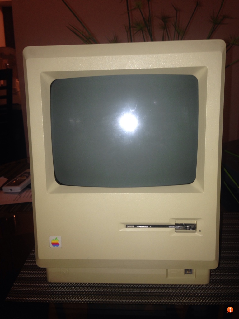

Really got a 512k today after all. $25 with original keyboard/mouse and an 800k apple drive. It unfortunately doesn't work and the drives (both) make a spinning then stopping sound and keep going in this pattern. Blank screen and nothing else.
