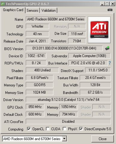

I just got my 6750's core on 850 and my memory on 1100 😎 i gave it 1.1v the temprature is max 80 degrees, and average was 76.
I tried to run the Heaven benchmark and it seems to work perfectly! With the standard settings i got 18.0 frames and with the new one 24.8 !!
I'm gonna test some games tomorrow, but i'm proud to have it this high and stable 🙂
Oke so the main reason for me to overclock was to make Far Cry 3 playable. As you can see 2 post's above this one i clocked it to 850/1100 on 1.1v.
First of all .. for one reason i can't give my GPU more then 1.1v, the ATT Tool just won't let me. And on this settings if i go any further then 850/1100 my system gets artifacts and/or crashes. So i think this is the limit for my system.
Oke now it's time to play games on the 850/1100/1.1. I ran far cry 3 for about one hour, and changed the GPU wile playing, Everytime a little bit more. To have a clear view i started restarted the mission every time so i can see the same FPS on every moment. After all the lower settings worked for 10 minutes i played on the 850/1100 settings for 40 minutes. My system accepted it and i didn't have lags or artifacts.So after 40 minutes of gaming and 30 minutes of benchmarking i think i can say .. IT WORKS 😀 and my core is still on average of 76 degrees. max on 82.
On the high settings of Far Cry 3 i got 15 FPS insted of 9 without clock.
On Medium settings i got 19 FPS , and before that it was 13.
I'm gonna try to get it even further, but as i said i think this is the limit for my system. Maybe someone has any tips or tricks? I hope this helped some of you! Feel free to ask me more 🙂
