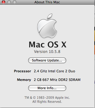

So if I'm understanding this correctly...I can upgrade to 6 GB of RAM with the current system that I am running? As long as its DDR2 it should work? :confused: (June 08' refurb)
