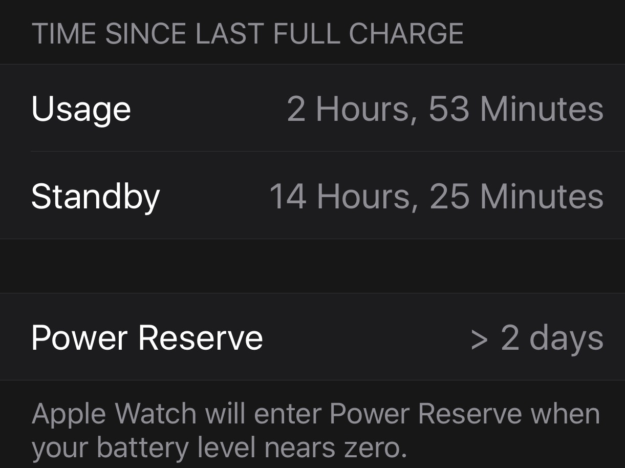

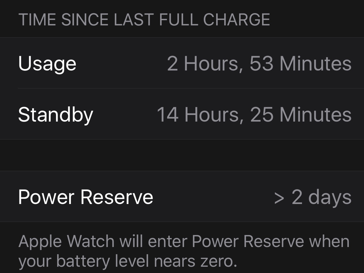

Here I am today, including over an hour workout, and currently at 43%:
