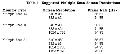

    According to this, the PF790 is capable of:
    1,600 x 1,200 @ 77Hz
    1,280 x 1,024 @ 90Hz
    1,024 x ,768 @ 118Hz
    ,800 x ,600 @ 149Hz
    The 7600 resolutions are
    512 x 384
    640 x 400
    800 x 600
    832 x 624
    1024 x 768
    1152 x 870
    1280 x 1024
    Unfortunately, the maximum refresh on the 7600 is 75Hz. See "Table 1" here.
    Snookered. Unless the ViewSonic or IBM can do 74-75Hz :(

    The G78 *should* be able to handle 1280*1024 out of that card... (IIRC 1280*1024 at 75Hz was one of the settings it took...)

    I have to apologize for not being too bright here. The way I read it, those monitors can handle more than the 7600 can do, but isn't it the nature of a multi-sync CRT that those specs are maximums, and these CRTs should simply display the lower output that's within the 7600's range?
    Here's the NEC specs while we're at it.
    http://www.necdisplay.com/documents/UserManuals/ms5790f.pdf
    And yes, 1280*1024 at 75Hz is listed for the 7600 on the Apple Multiple Scan 20" (albiet at 256 colours), but only for that one. Lesser resolutions are listed for the 17" and smaller.
    I've never had these monitors hesitate to display very old PCs with weak cards, so please forgive my expression of blank stupidity right now. What am I missing?

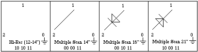

    Back at it. Did some reading, and found some things.
    I don't have the backup software, so it's a poor risk. It's unsatisfying to leave a good suggestion untried, but there it is.
    Searching further found more mentions of the same trick, so I've just cobbed togther a male-female DB15 avec diode to stick between the Apple and the SVGA adaptor. I get this on the G78:
    640x480 67mhz
    852x624 75mhz
    1024x768 74mhz
    I also get that if I reverse the diode, or remove the diode. I get nothing if I remove the cobbed DB15. Also when I do get display, I get it in pink.
    This is a pastime, so I suppose I am delighted at the expanding mystery.
    The cobbed cable is made from a gameport and a cord ripped off a discarded Apple 17". It was discarded for going pink.
    I did test that cord to be assured that each wire was only connected to one pin. However I did not test thoroughly enough to notice if there was any diode inside.
    Guess I'll check that next. I would have thought Apple would put the Sense Code tricks inside the monitor rather than the cable, but in hindsight there is no reason to presume that.
    And of course now I'm also wondering if the discarded 17" can just be fixed by a new cable.

    The AppleVision extension provided geometry adjustments via the ADB port on older "AppleVision" monitors and should be easily disabled without causing additional problems. However, if you're able to get up to 1024x768 then installing it seems unnecessary.
    Yup, which is essentially the sense code for a 16" Apple Multiscan monitor.
    [​IMG]
    [​IMG]
    Sense0= Pin4, Sense1= Pin7, Sense2= Pin10
    Note from the above "Table 1" that with the diode in one direction you get 16" Multiscan and 3 available resolutions. If you reverse the diode you get 21" Multiscan and 4 available resolutions. Note that you MUST reboot for the new sense code to be recognized.
    Yup, it's quite possible that the green pin (or green return) is open circuit. But it could be anything in the green path, all the way to the RGB amplifier and sometimes can be as simple as a dry/cracked solder joint. If you remove green, you'll get pink as can be seen in the additive properties of light:

    Yup, did do that.
    Had one. Picked up around 2002. Their reputation was so ghastly I wondered if it might be the only one still running. I got about two years out of it, before that it was in daily use at a university lab.
    This one's the M2494. The one that always has a broken control cover.
    http://www.everymac.com/monitors/apple/multiple_scan/specs/multiple_scan_17.html
    Splendid info, btw. Very helpful.
    Edit: Confirmed the Apple monitor cable a diode from 7 to 10 in the connector.
