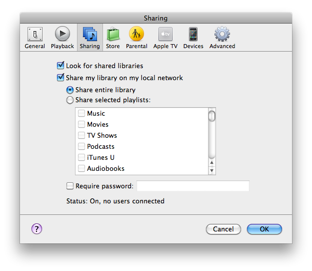

1. Activate Home Sharing on both Macs, using one Apple ID
2. The Home Sharing button on the left tab disappears.
3. On Mac A., open the Shared Library from Mac B.
4. Select and drag songs onto the Library of Mac A.
5. When desired, disable Home Sharing under the Advanced menu
This is assuming you have turned on Look for Shared Libraries and Share My Library in iTunes preferences of both Macs.
