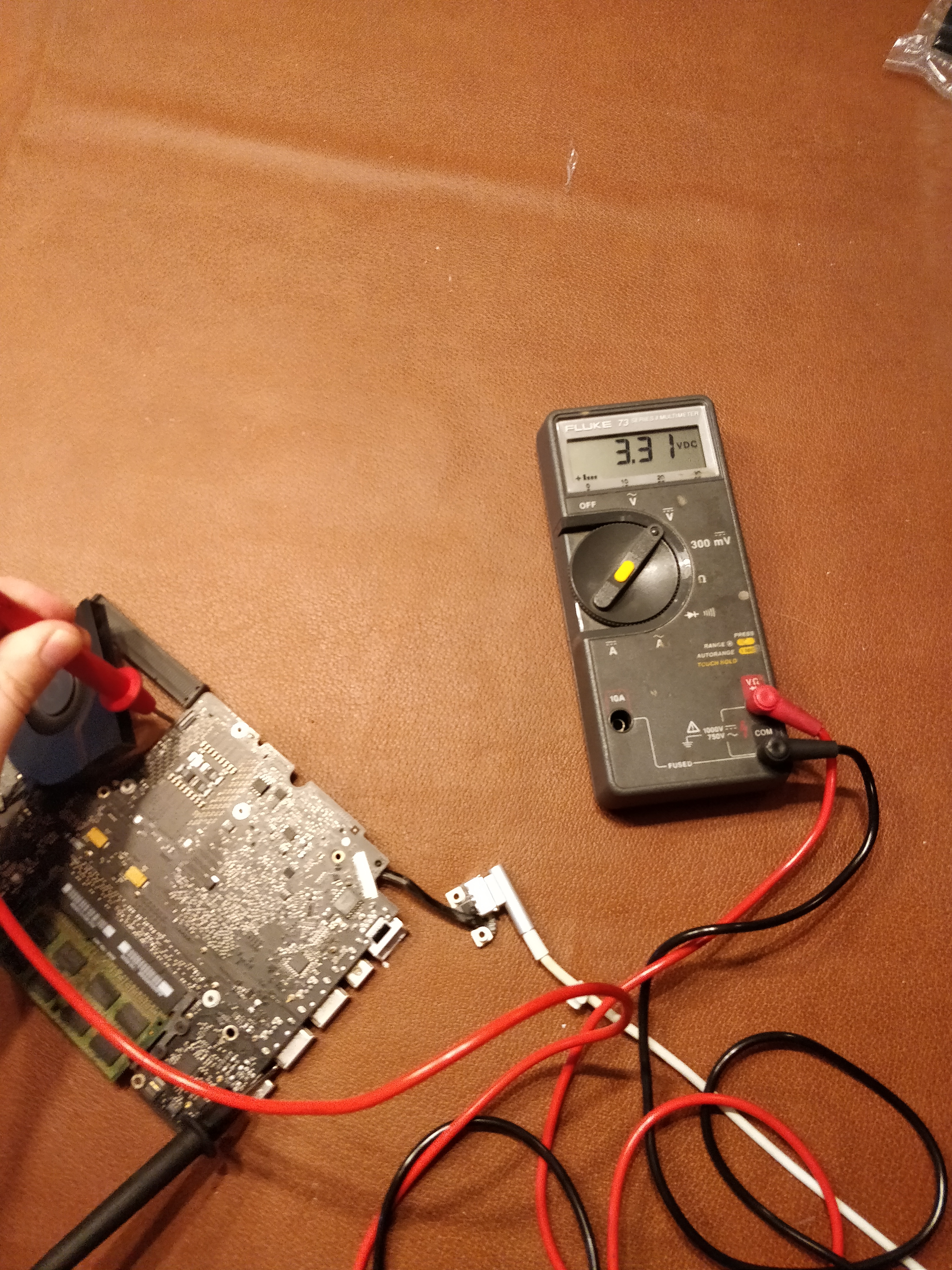

It was the A1342 MacBook schematic. To confirm that pins 33 and 34 are 3v3 should be pretty simple to do; can you check with a voltmeter?
Edit: this was on page 17 of our conversation where you said pins 31 and 32 are GND, and you assumed pins 33 and 34 are 3v3 but didn't check with a voltmeter?

Yes on the a1342 the corner anchor pads on the MLB side of the a1342 logic board are indeed 3.3v.

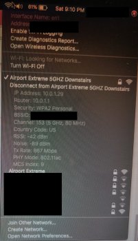

Hello everyone,

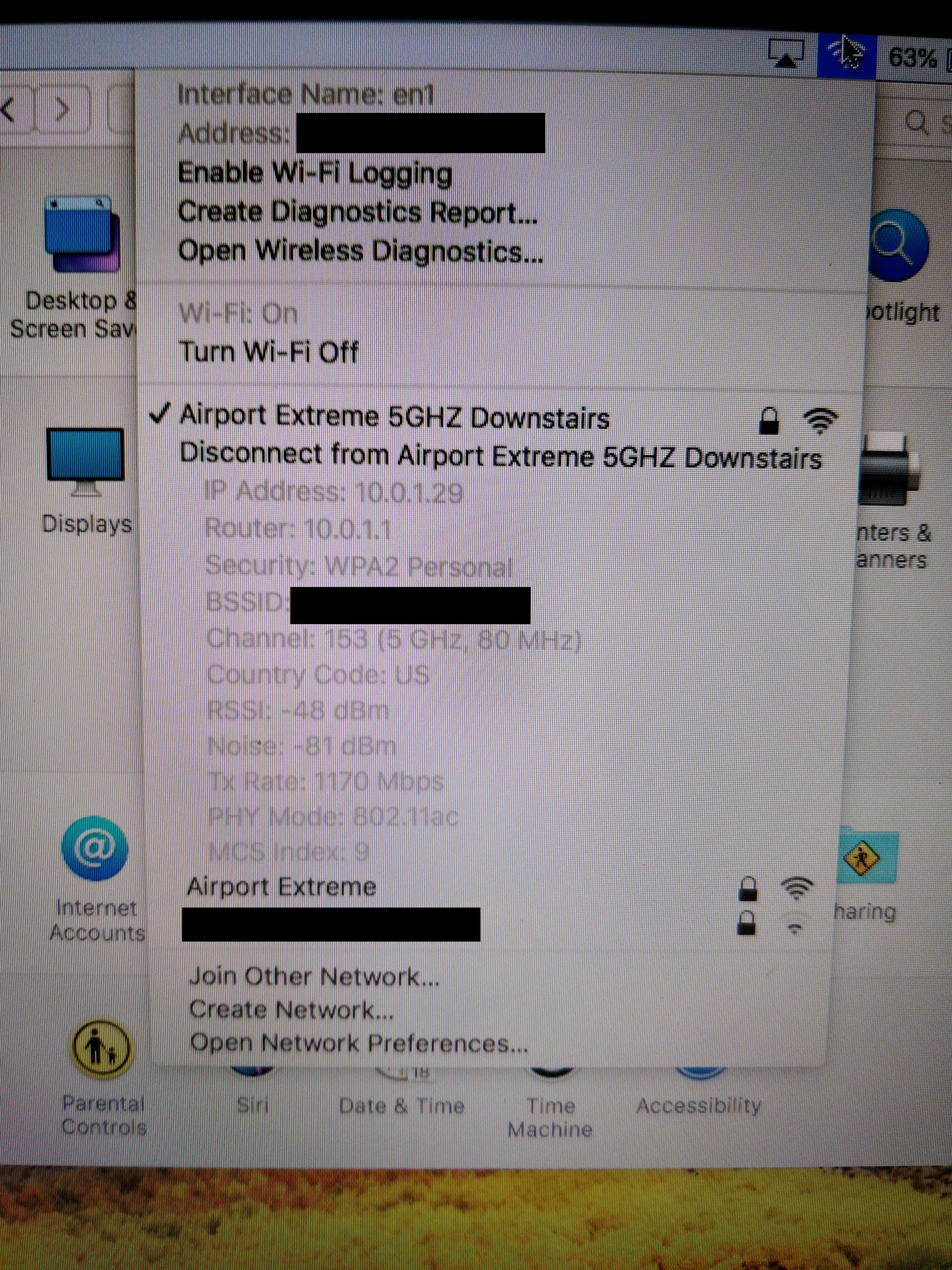

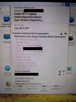

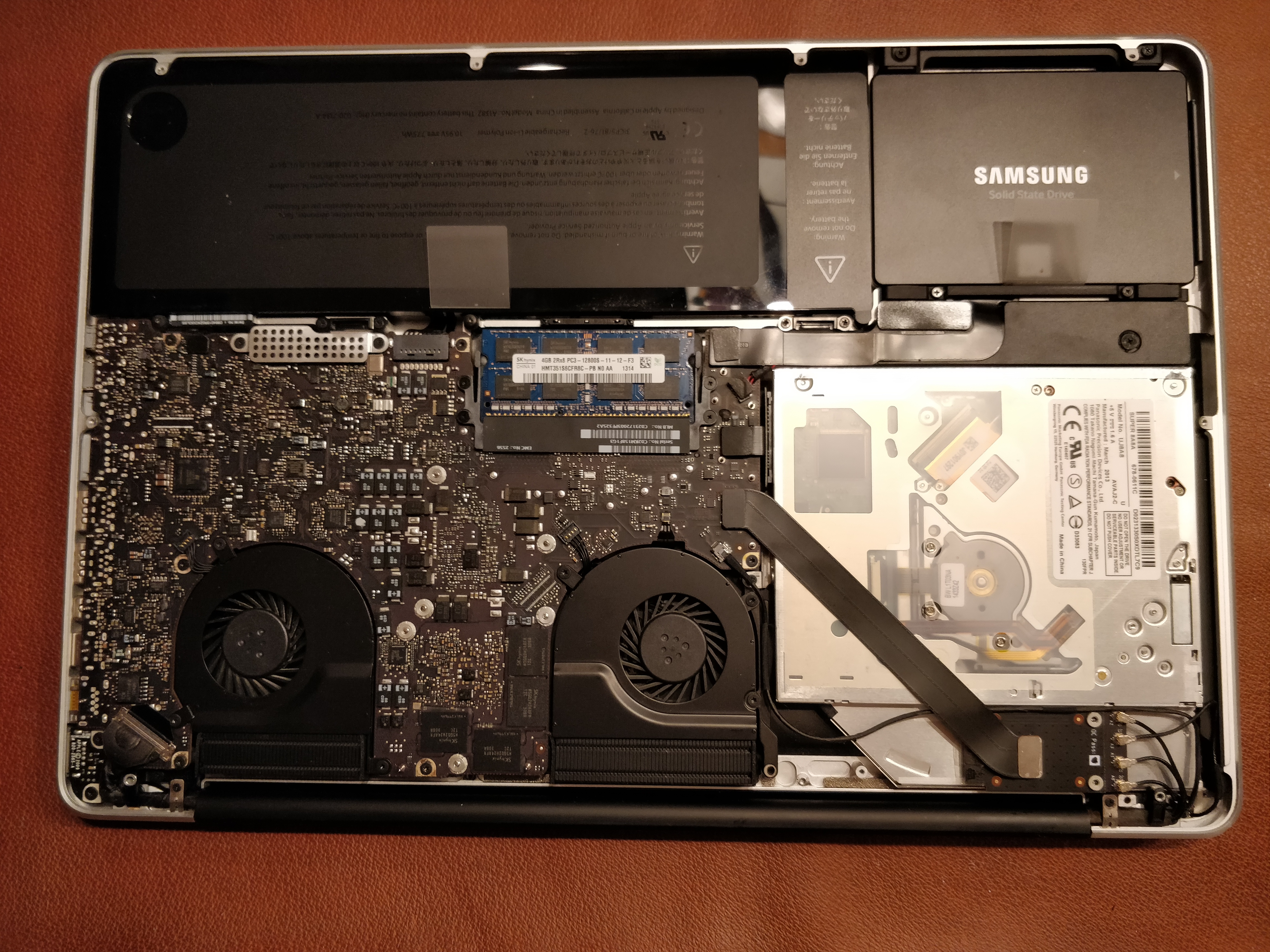

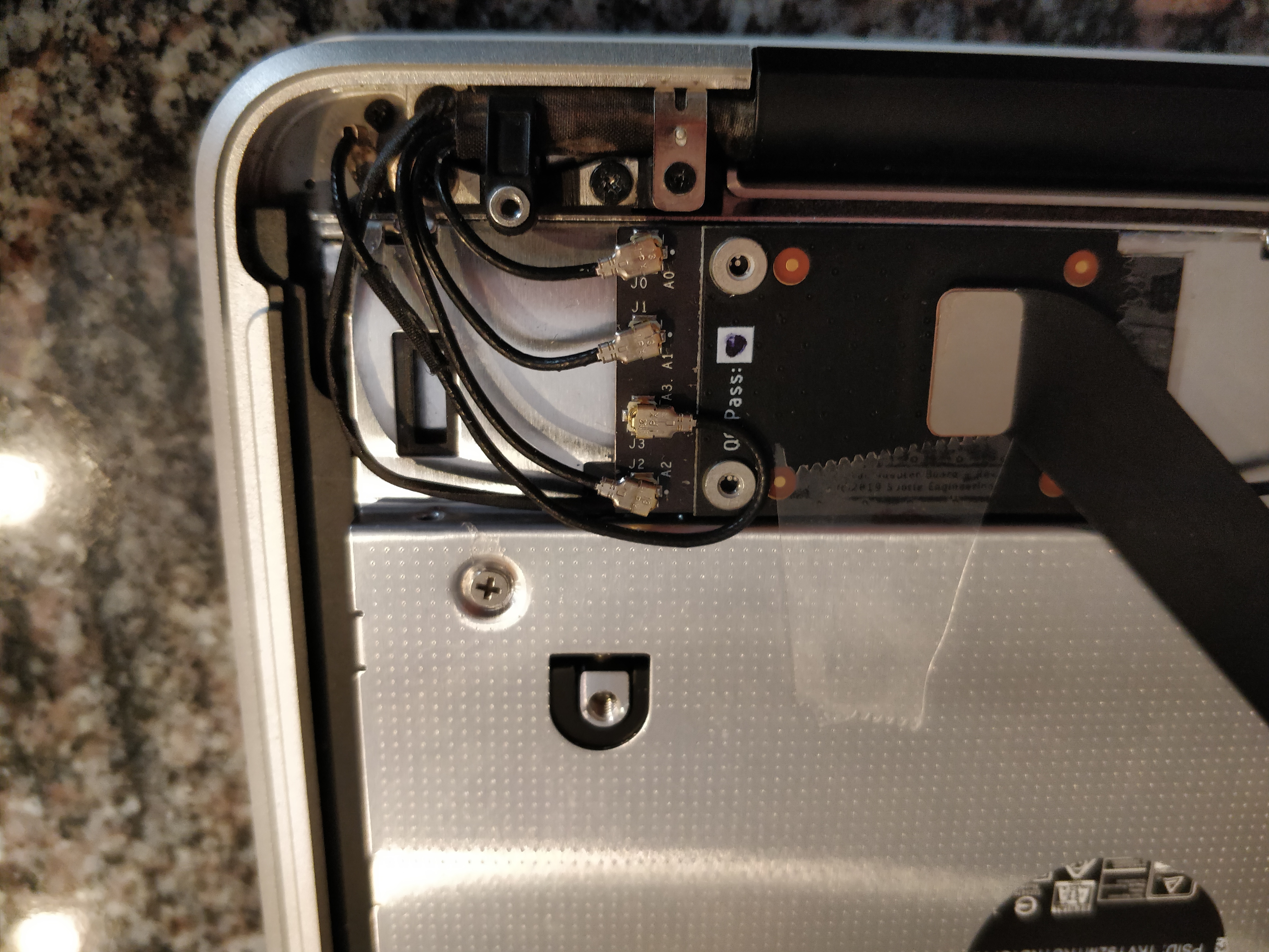

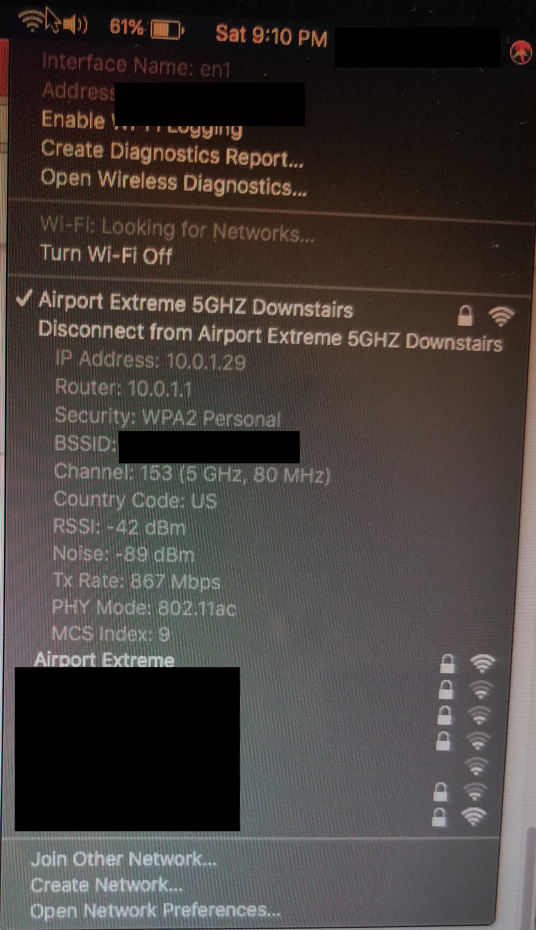

I have received my preproduction Wireless AC card today and I am impressed with how well this card this card works in the a1286 MacBook Pro. Let me start out with saying no modifications to the chassis are needed when installing this card into the a1286. First you need to remove your existing Airport card housing from your MacBook, pull up the tape over the flex connector and gently pull the cable off your airport card. From here you reattach your flex cable back to your logic board and line up the new cards connector with the flex cable and gently pull it back on. Once the appropriate position is determined you tape the top of the card, bridging it to the optical drive. When attaching the U.FL Wi-Fi antennas take note of the longest antennae (this is your Bluetooth cable) this needs to be in position 3 of the new card (j3) as this connector is specifically for Bluetooth. The cable needs to be tucked in the spare area above the optical drive slot. I recommend arranging the cables in a manner that prevents as little cross over as possible. See pictures for how I arranged my cables.
In terms of performance I'm noticing pages load much faster and comparing 2 identical 15” MacBook Pros 2012 2.6GHz, the a1286 with the AC card Loads 4k YouTube video 5 seconds faster than one with just wireless N. I am also seeing bursts 1170Mbps, which is more than double of what the N card can pull.
I’m impressed with how through @troop231 was with designing and manufacturing such an adapter that takes the 2015/2017 iMac Airport card and makes it work with Unibody MacBook Pros.

Hello everyone,
I have received my preproduction Wireless AC card today and I am impressed with how well this card this card works in the a1286 MacBook Pro. Let me start out with saying no modifications to the chassis are needed when installing this card into the a1286. First you need to remove your existing Airport card housing from your MacBook, pull up the tape over the flex connector and gently pull the cable off your airport card. From here you reattach your flex cable back to your logic board and line up the new cards connector with the flex cable and gently pull it back on. Once the appropriate position is determined you can pull the protective backing off the hook and loop, press the card firmly to the optical drive. When attaching the U.FL Wi-Fi antennas take note of the longest antennae (this is your Bluetooth cable) this needs to be in position 3 of the new card (j3) as this connector is specifically for Bluetooth. The cable needs to be tucked in the spare area above the optical drive slot. I recommend arranging the cables in a manner that prevents as little cross over as possible. See pictures for how I arranged my cables.
Nice work and clean install! No longer will 'old' MacBook Pros have to be left out from having fast, modern wireless :)
Hello everyone,
