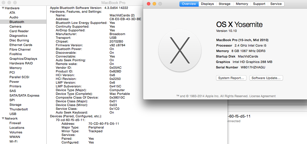

A 2010 MBP, shouldn't but can
Had to turn off and turn on BT to get USB dongle to override the internal, but it did
Had to turn off and turn on BT to get USB dongle to override the internal, but it did. We will be offering this setup shortly, very similar to the USB offering from China but assembled in California.
Will work in any Mac that can run Yosemite
