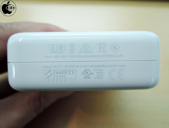

This photo from macotakara suggests the same 9V/3A output, which when regulated down to 2A by the cable would provide 18W:
Reactions: big samm and John.B

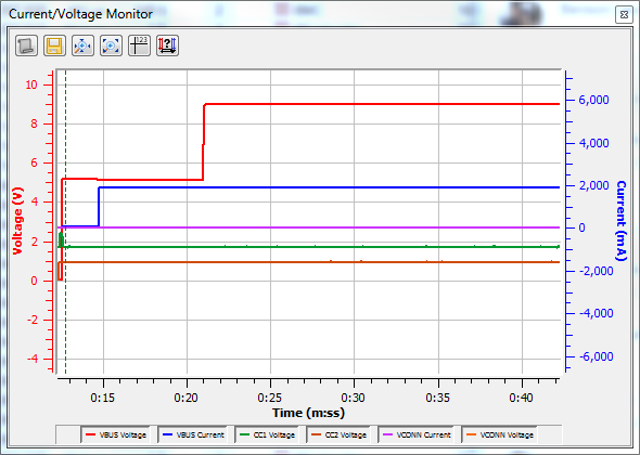

The Google+ post had some great info posted by "Brad Cox". The charts show how the 87W charger charges the 12.9" iPad Pro, and confirms the 18W charging rate:
It's interesting that it initially negotiates 5.2V/2A before stepping up to 9V/2A.

iPad Pro (as of today)
RSvOTFZG26322xLqCvPbkm9me4PueYbQvAGo9JPlRVwEcxc2J0t-DtoW5PpdO8aOqMuLhF4ZZNelPOQ=w1920-h1080-no
iPad Pro 12.9 on 87w with 9v profile only (as of today):
WU4wkXFxRVTwNJDY84E39mbM8RadrQcUZJMyZsiFJSOj03Sc8AWphxSe-3BCP6LG-YU0zB-WpS1Ka6s=w1920-h1080-no

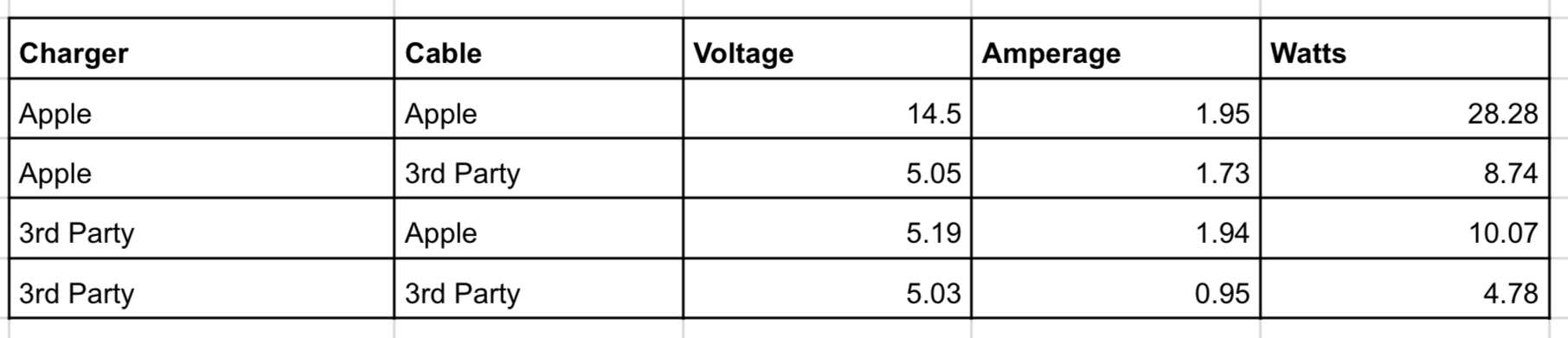

I tested my 12.9" iPad Pro with several combinations of USB-PD chargers and cables. I tried chargers and cables from both Apple and from 3rd parties. I used a Satechi USB-PD power meter to measure the power draw.
The iPad Pro was 25% charged. I took measurements with the display on and set to 100% brightness. The Apple cable was 2m and the 3rd party cable was 1m.
Both chargers were rated for 29w USB-PD. I purchased the 3rd party charger on ebay. The third party charger output ~29w when connected to a non-Apple laptop. I could not measure the 3rd party charger when connected to an Apple laptop since a compatible laptop was not available.
I'm trying to find a 87w Apple charger for additional Analysis. If I am able to do so, I will post the results.
For verification, I measured the chargers power draw with a Kill-a-watt meter. The wattage readings from the Kill-a-watt were consistent with the figures from the Satechi USB-PD power meter.
I have access to a USB-PD protocol analyzer at my job. If I have time, I may capture the USB-PD negotiation and try to figure out why the iPad Pro is not interoperable with standards compliant USB-PD chargers.
Thanks for taking the time to do the analysis @Brian Murray. Your data certainly supports the fact that the Apple cable is locked to 2A.

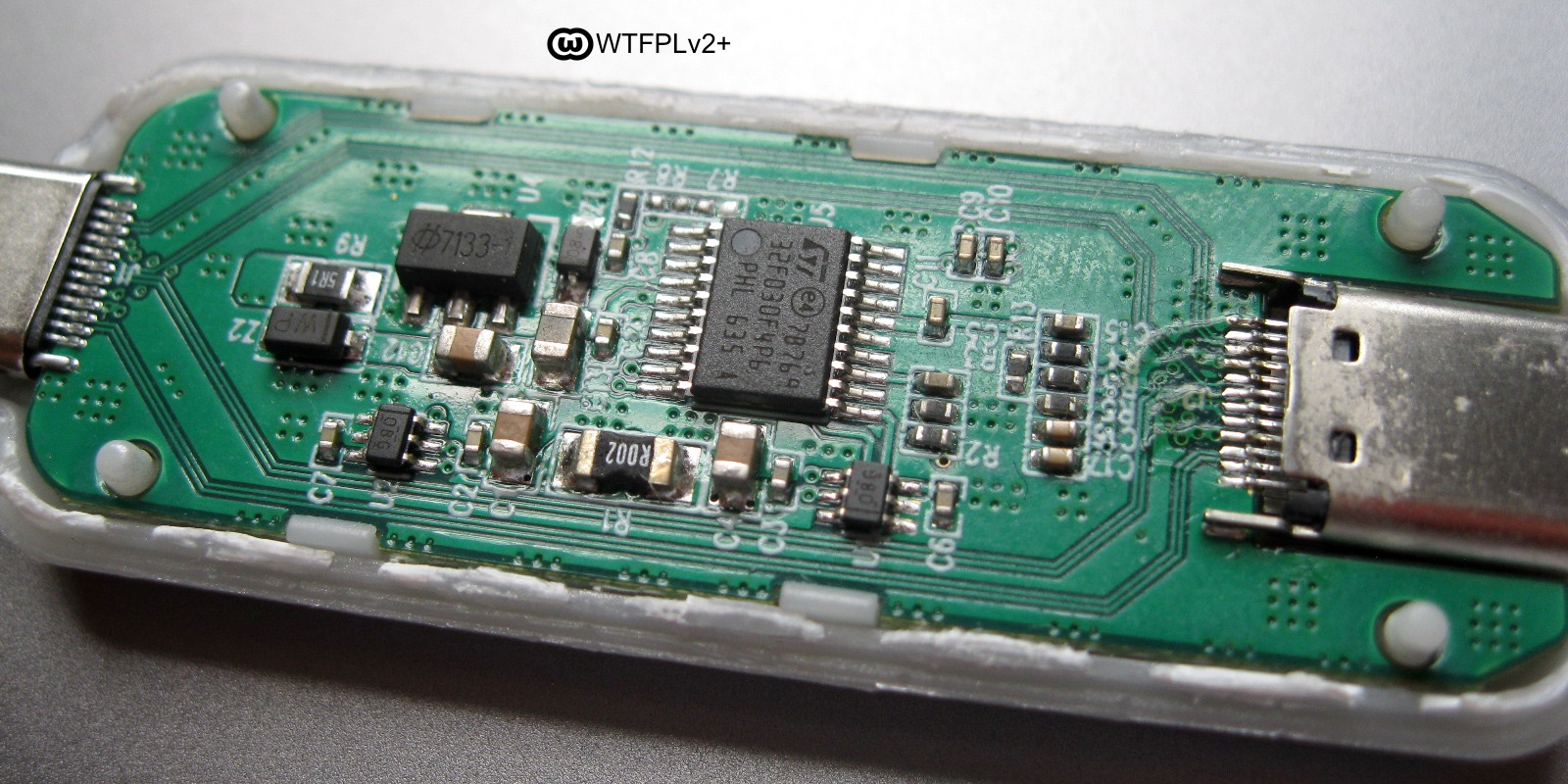

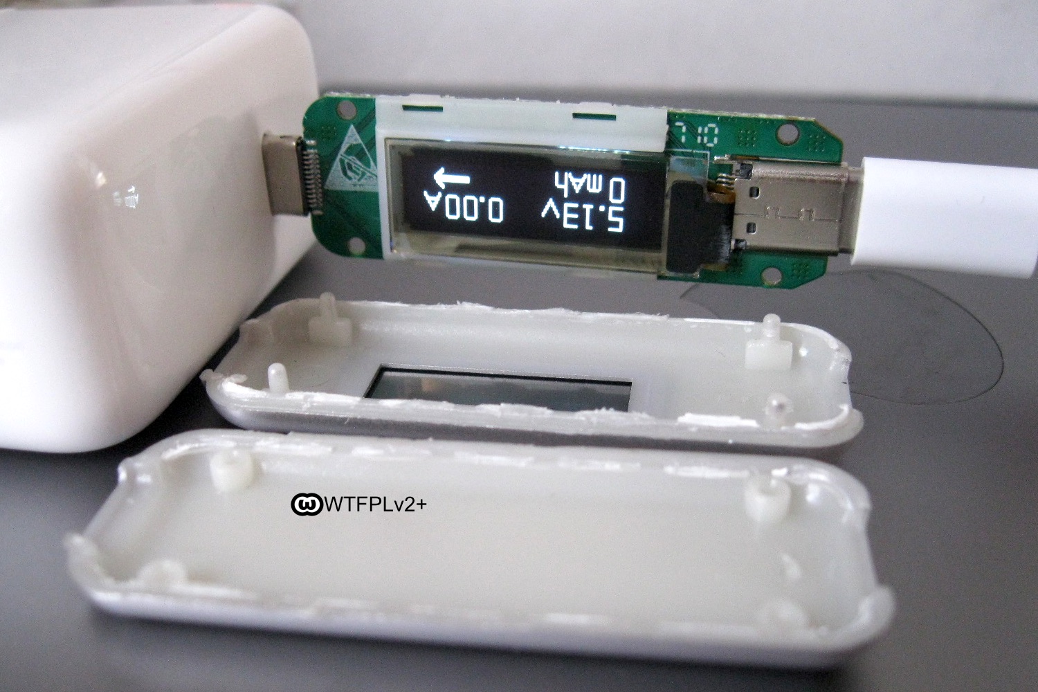

Hi all. I, too, bought a Satechi Type-C Power Meter. I am sorry I took so long to write this report. (I wanted to have it done two weekends ago.) I bought too Plugable USBC-VAMETER; I hope to post a report about it within a week. To readers who want to know which to buy, and do not want to wait until I complete my report, I tell you this during the meantime: they are very similar, only Satechi's is skinnier and Plugable's is cheaper. When I mention numbers measured by "my Keysight", I am referring to a Keysight U1232A which is within one year of calibration.
Voltage measurement accuracy:
My Satechi Type-C Power Meter agrees with my Keysight on measured voltage, though it measures slightly lower. Its measurement is noisy: readings continually vary from mode by ±2 counts, and infrequently by ±3. (Its count resolution is 0.01 V.) Its 0.01 V resolution is useful to compare qualitative test results. ("Which cable sags more? Which mobile power bank will give me a competitive edge in speed charging a current-limited iPad?" A one user may compare relative centivolts of devices.) However, I think it is not quantitatively significant. (It is not accurate enough for product reviews or to compare with others. If a user ninelives says "my deluxiPad charges at 9.09 V according to my Satechi" and a user ninetails says "my fanatiPad charges at 9.01 V according to my Satechi", then we should consider their measurements to be equal.)
My Keysight's accuracy around 5V is ±0.027 V, my Keysight's accuracy around 20V is ±0.12 V, and my Satechi jitters by ±0.03 V. I decided to round both of them to decivolts. Here are some samples to compare my Keysight to my Satechi:
Keysight 20.3 Satechi 20.1
Keysight 15.8 Satechi 15.6
Keysight 13.9 Satechi 13.8
Keysight 8.1 Satechi 8.3
Keysight 6.3 Satechi 6.2
Keysight 5.2 Satechi 5.1
Keysight 3.2 Satechi 3.5 V (18 mA draw per my Keysight)
Keysight 2.4 Satechi 3.5 V (17 mA draw per my Keysight)
Keysight 2.2 Satechi 3.5 V (15 mA draw per my Keysight)
Amperage measurement accuracy:
I did not try very hard to test my Satechi Type-C Power Meter. I only tested its amperage measurement with three Apple power levels "2W" (nominal 2.5W, System Information.app calls it 2W) 5W and 12W, not 10W. My Satechi Type-C Power Meter agrees with my Keysight on measured amperage. Its measurement is noisy: readings continually vary from mode by ±2 counts. (Its count resolution is 0.01 A.) Its 0.01 A resolution is useful to compare qualitative test results. ("Which mobile power bank / battery pack fills-up faster? Which colour of light-up widget is more wasteful?" A one user may compare relative centiamps of devices.) I think its centiampere resolution is not quantitatively significant, especially when users do not realise that this appliance does not compensate for its own 2 cA draw. (However I think, its reading rounded to the nearest twentieth ampere (0.05 A), has quantitative significance.)
My Keysight's accuracy around 0.5A is ±0.008 A and around 2.4A is ±0.027 A; I decided to round it to centiamps. My Satechi jitters by ±0.02 or +0.01-0.03 A, so I am taking the mode of its readings. Here are some samples to compare my Keysight to my Satechi:
"rated 0.5A": Keysight 0.48 Satechi 0.47
"rated 1.0A": Keysight 0.95 Satechi 0.94
"rated 2.4A": Keysight 2.28 Satechi 2.30
Satechi measurement ability:
Satechi Type-C Power Meter takes both its own power supply and voltage measurement toward plug side of shunt resistor. Shunt resistance is nominal two milliohm (2 mΩ, mark code R002). It is powered through a linear regulator which breaks-down somewhere below 4V (it is specified 'range is 4V-30V'). It draws 19–20 mA at any USB PD voltage. (As measured by my Keysight, current accuracy is ±3 mA.)
When my Satechi Type-C Power Meter is powered through its receptacle and NO load is attached to its plug, it measures 0.00 A, though it itself draws 19 mA across its shunt resistor. In a comparable reverse setup, Satechi meter is powered through its plug and a computer mouse which draws 14 mA through its receptacle, it measures 0.00 A. (It is specified 'range is 50mA-9.99A'.)
It does not compensate for its own draw. My MacBook draws a very steady 2277 mA from an Apple 12W supply, as measured by my Keysight (either alone or downstream of Satechi). My Satechi measures 2300 mA (mode; range 2280–2320) downstream of its own draw (its plug is connected to power supply and its receptacle is connected to power load). Upstream of its own draw, my Satechi measures 2330 mA (mode; range 2300–2340) and my Keysight measures 2296–2297 mA.
Because Satechi Type-C Power Meter does not negate measured electrical current drawn by itself, its user must be mindful of this, for accuracy, especially when comparing/evaluating cables/powersupplies for their conductivity. That being said, its own draw is only two measurement counts, which a user may decide is not significant.
comments:
It always displays a pointing arrow, even when it measures zero amperes. I consider this a (minor) bug, a flaw which can be fixed by not displaying an arrow when its readout is 0.00A. My specimen seems to have one dead pixel in its arrowtip.
My specimen's circuit board is marked (screen print) "1710" in seven segment style. (I assume this means circuitboard was manufactured at year 2017 week 10.) It is marked with reference designators and an ESD susceptibility symbol, but no meta information (such as model or file numbers, revision, person place or thing names). Its main controller is a STMicroelectronics STM32F030F4 (package marked 32F030F4P6). Its USB receptacle is not anchored well, but its plastic body/case should prevent receptacle from being bent/lifted/broken-off from circuit board. Its USB plug is not well braced at all.
Its (OLED) screen flickers. I HATE flickering PWMing LEDs, I cannot stand it. This is a dealbreaker for me: I want to not own this tool. It does emit a faint high-pitched squealing/screeching "electronics hum"/"coil noise"/"inductor whine", which is quiet enough to not bother me.
