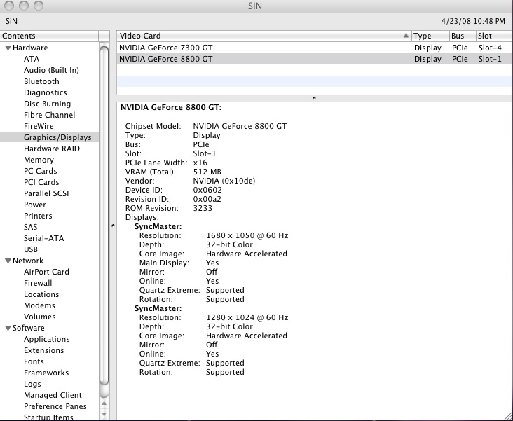

Can someone post a screenshot of their Graphics/Display settings under Apple System Profiler running this ROM? Thanks.
Here is the screenshot you wanted.
