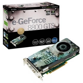

This does not work for the original 8800GTS with 640K RAM, does it?
S-
Sorry there is not enough memory on that card to do so: The x86 portion of the code fits on there because it uses roughly 58880 bytes. You need to the 128k flash instead of a 64k flash card so that the EFI portion will fit too (126464 bytes)
EVGA 8800GTS 512-P3-N841-A3
Hope this helps!

Thanks logicdisaster for posting the P/N (and the edited ROMs too!) - picked one off eBay for cheap and got it flashed and working in my Mac Pro now. Works perfectly in Leopard and under Windows 7 Beta as well.
