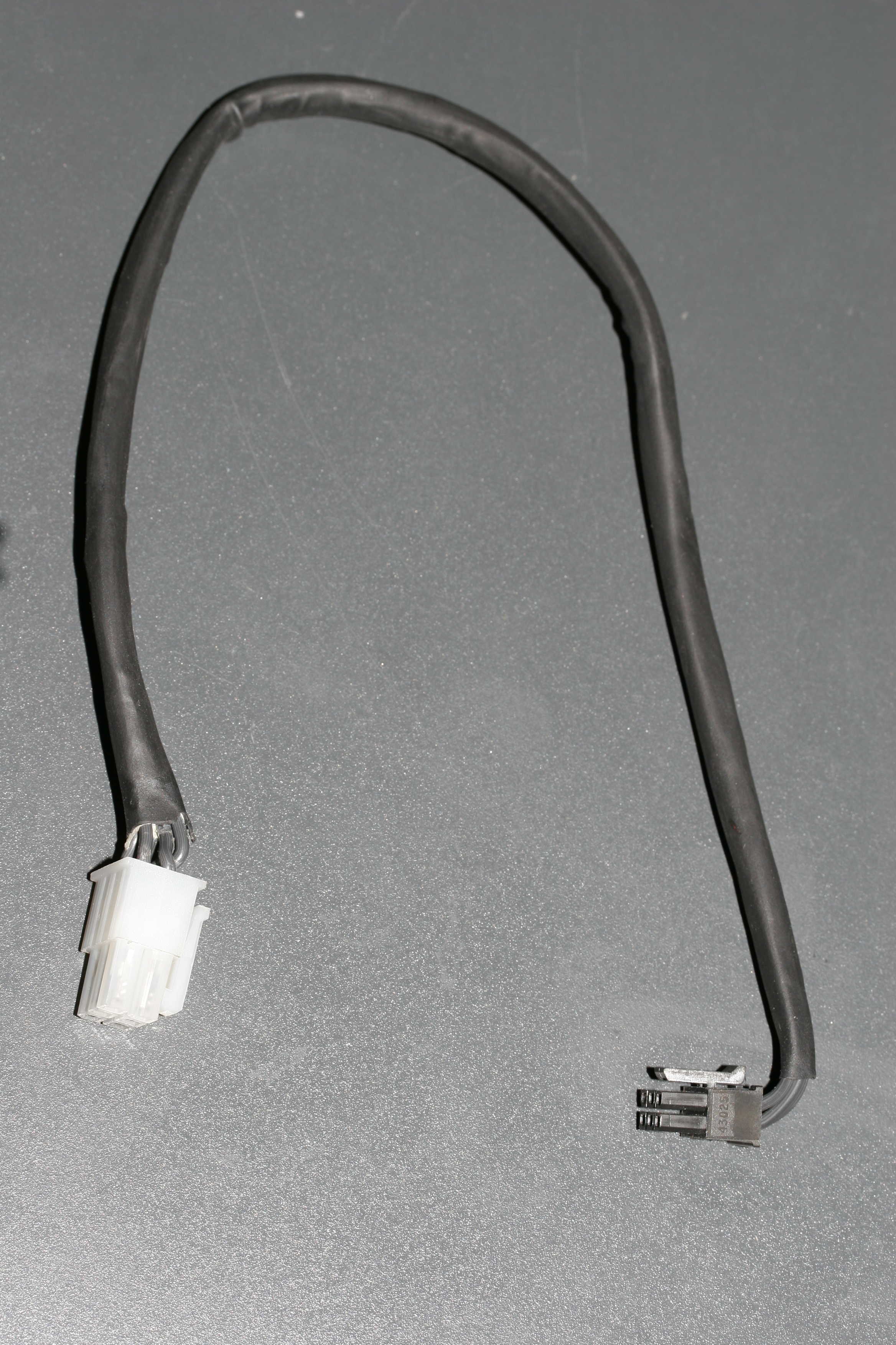

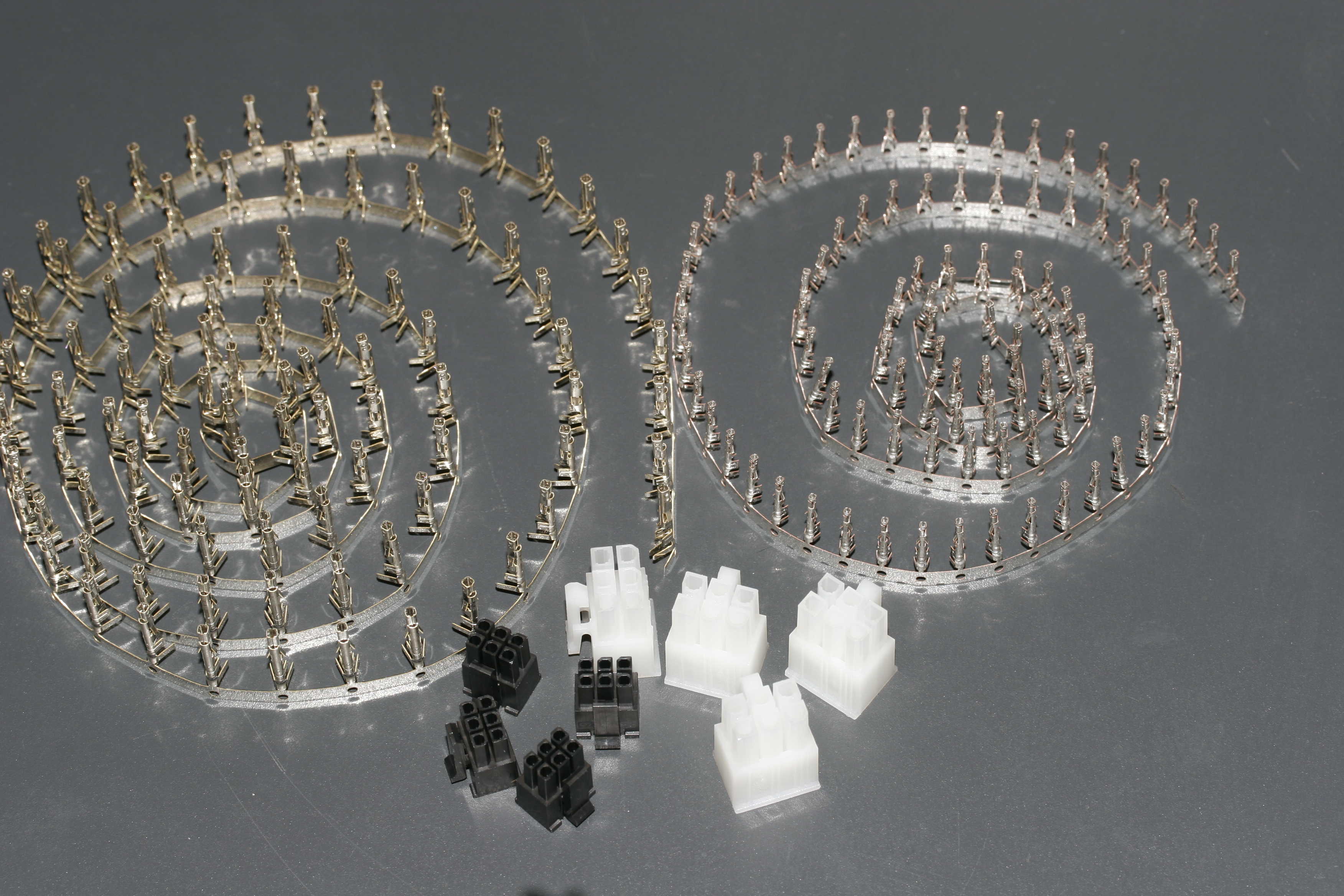

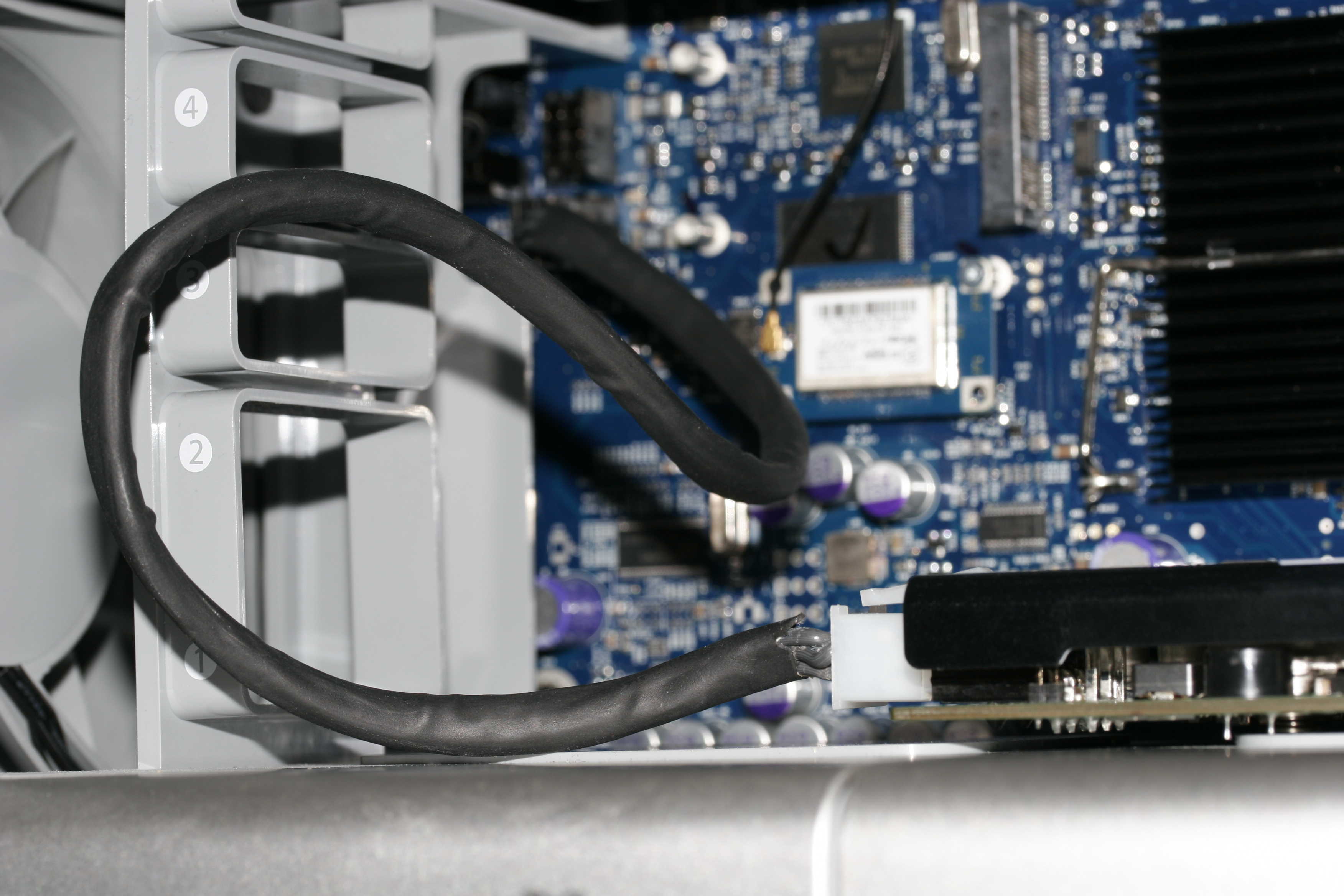

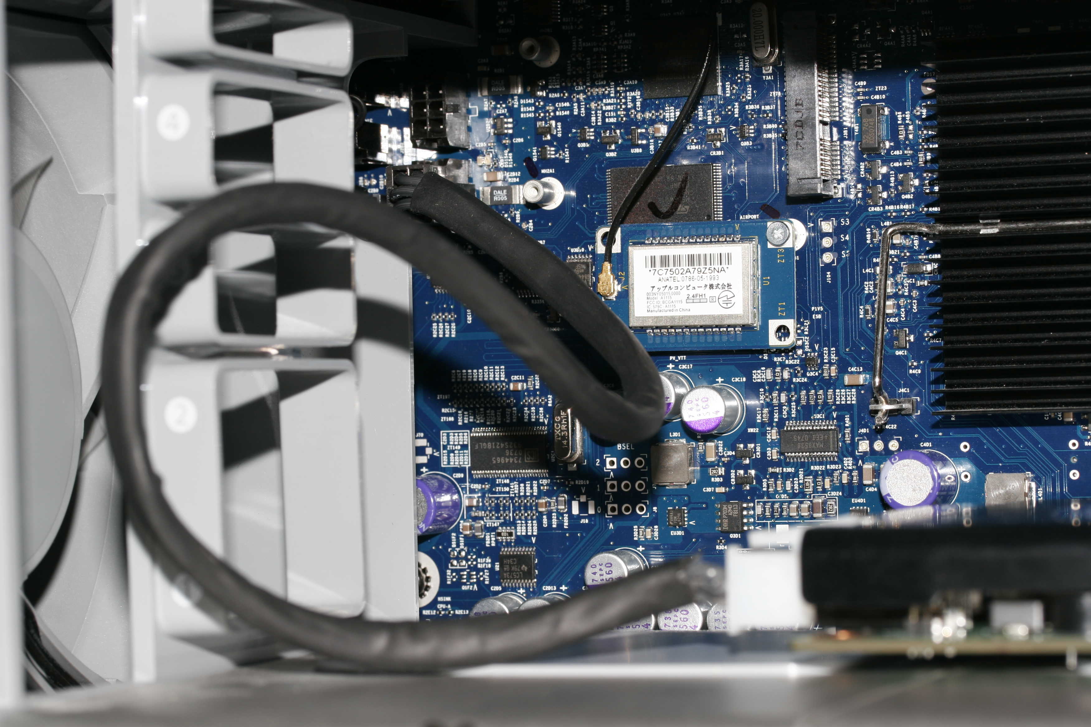

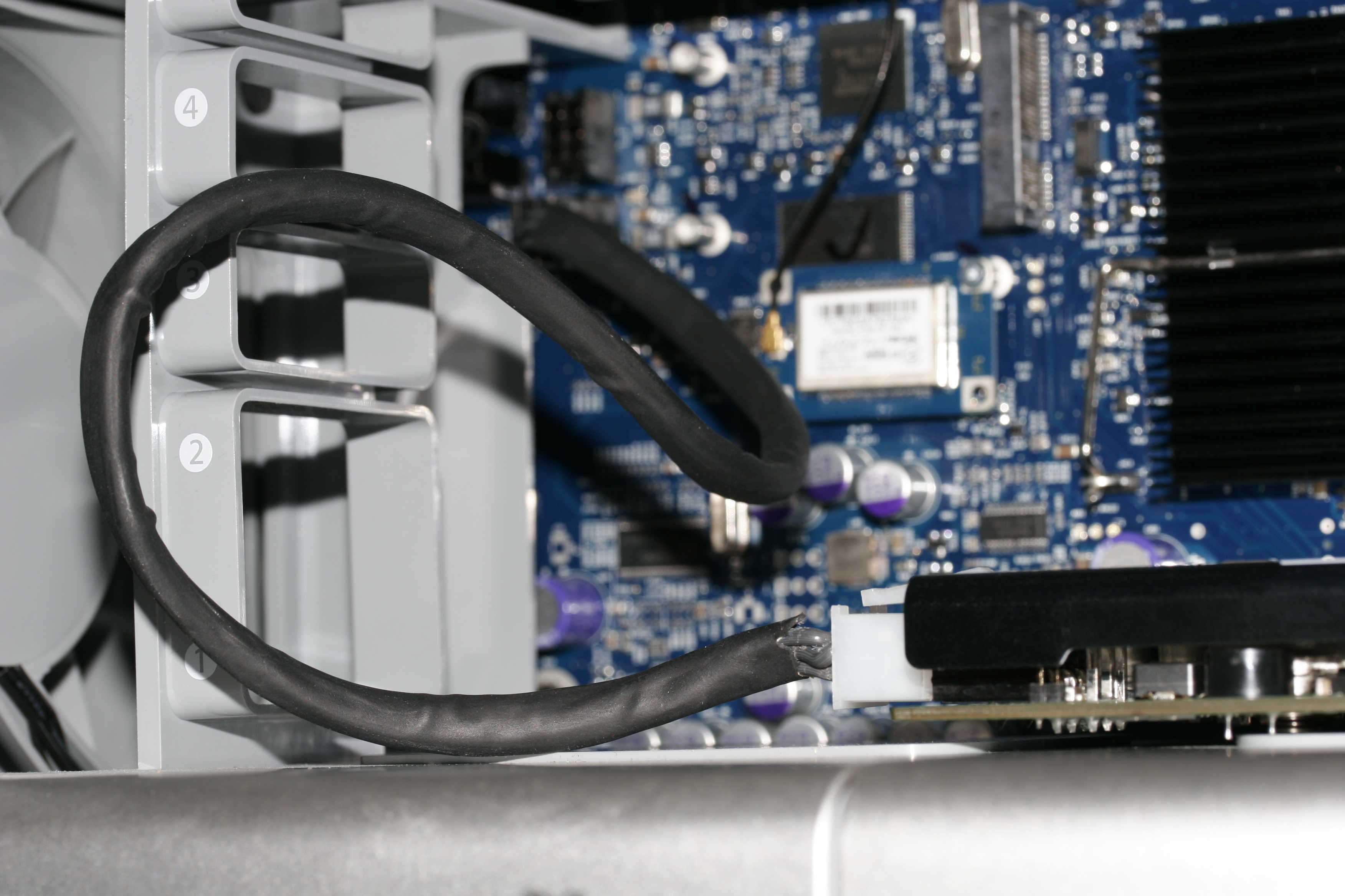

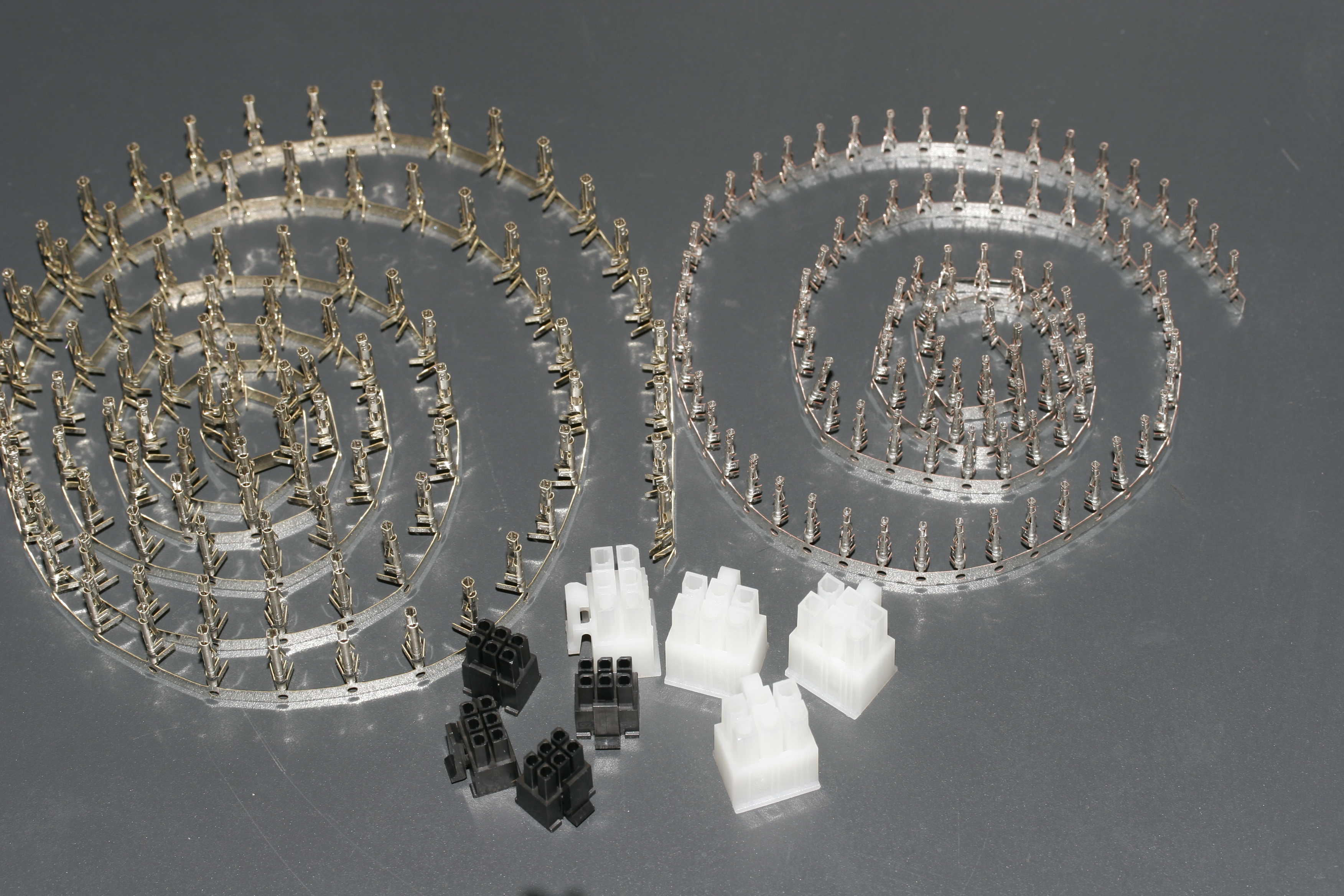

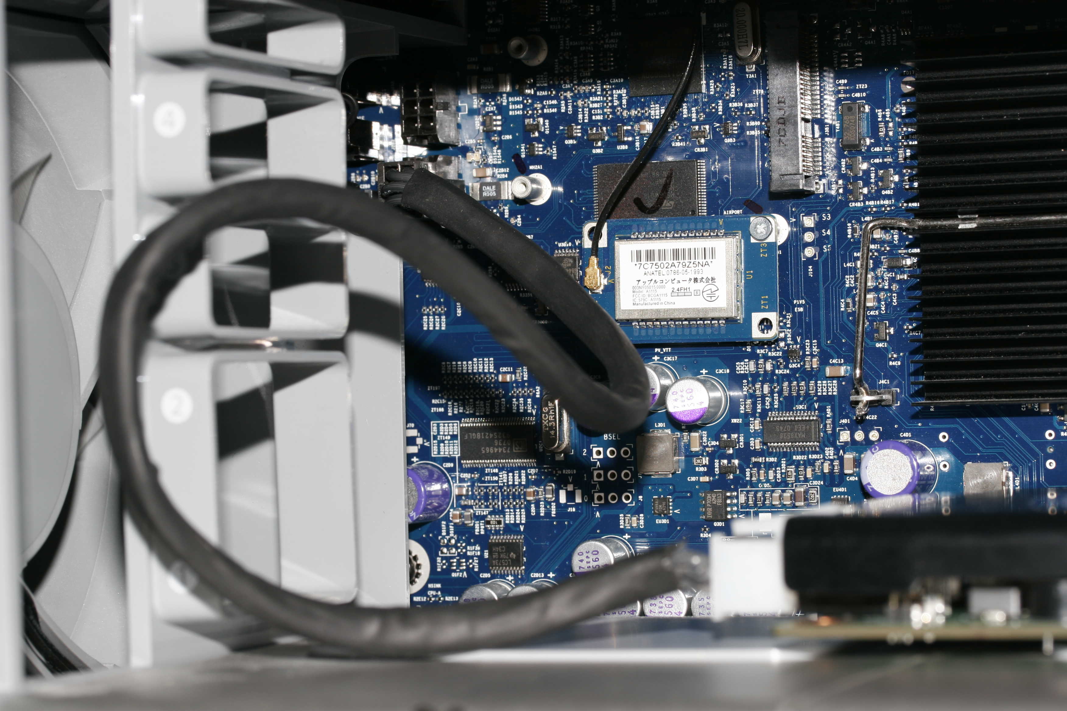

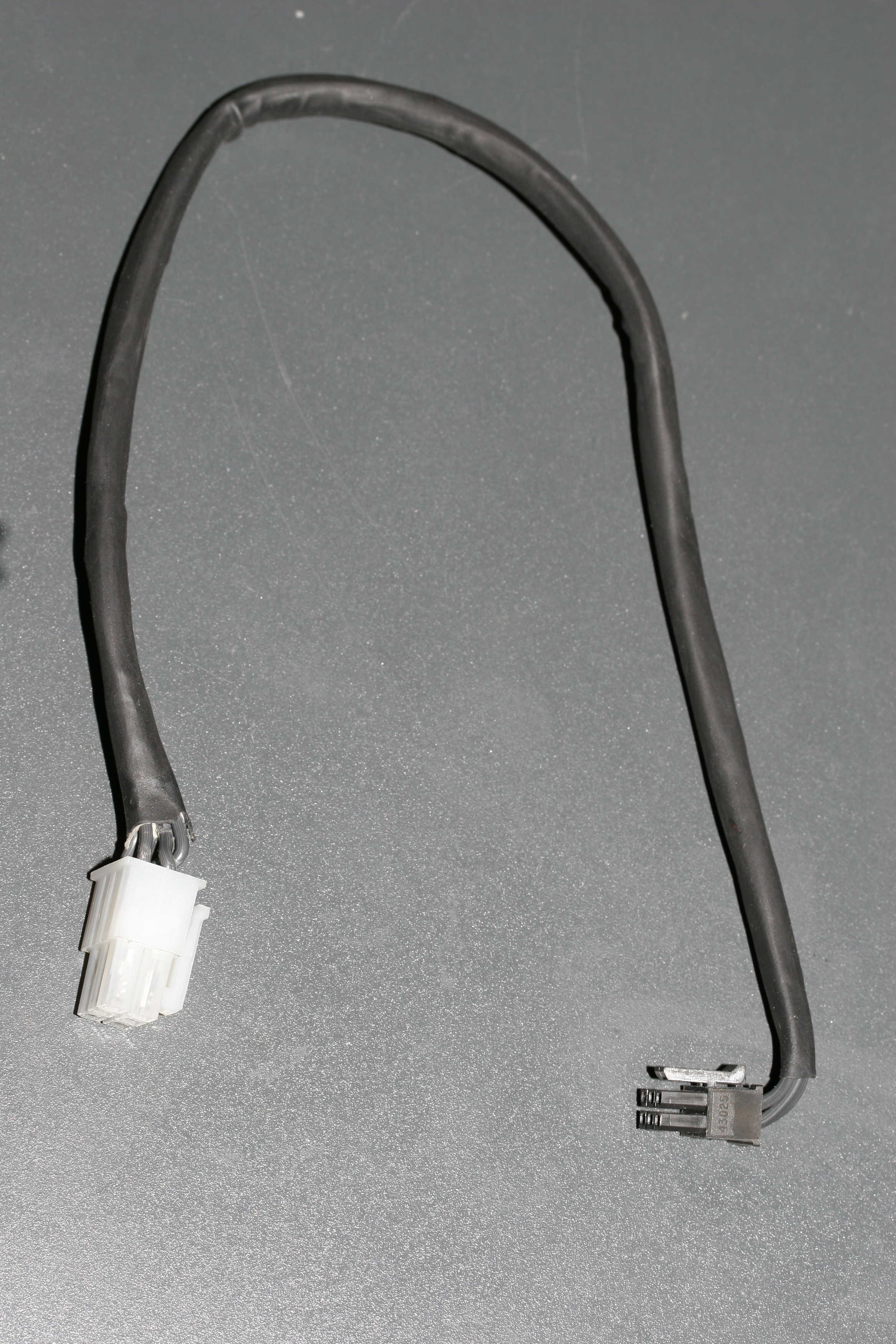

Home built cable
I ordered the parts to make a power cable yesterday afternoon, and today at noon they showed up at my door! Amazing service.
Took about 1.5 hours to put it together, photos attached. The connector for the 8800 end isn't exactly the right one and needed a quick 'adjustment' with a sharp knife.
I ordered quantities of ten to get a price break (and in case I needed a second try🙂), so I have parts left over for nine more. PM if interested.
