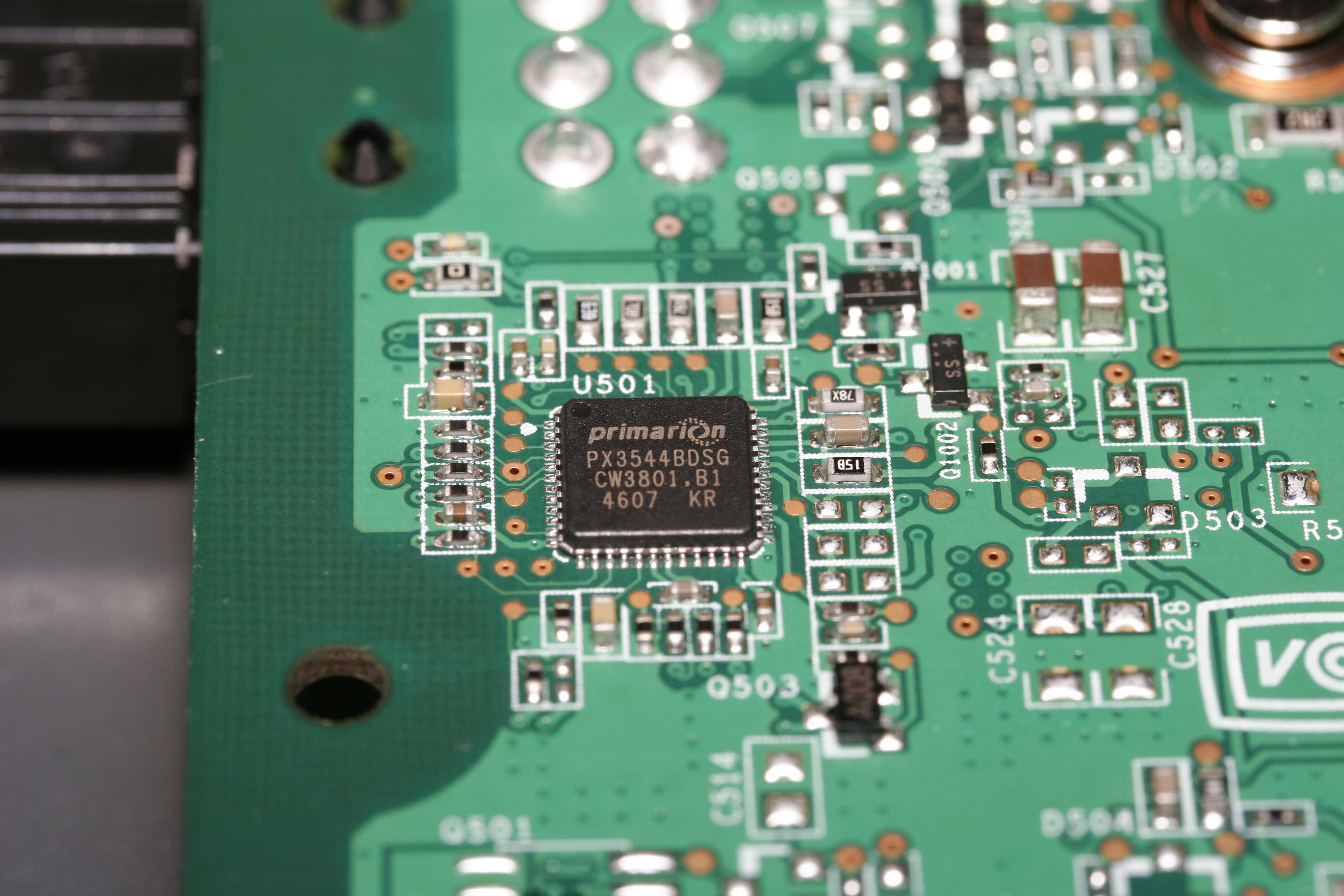

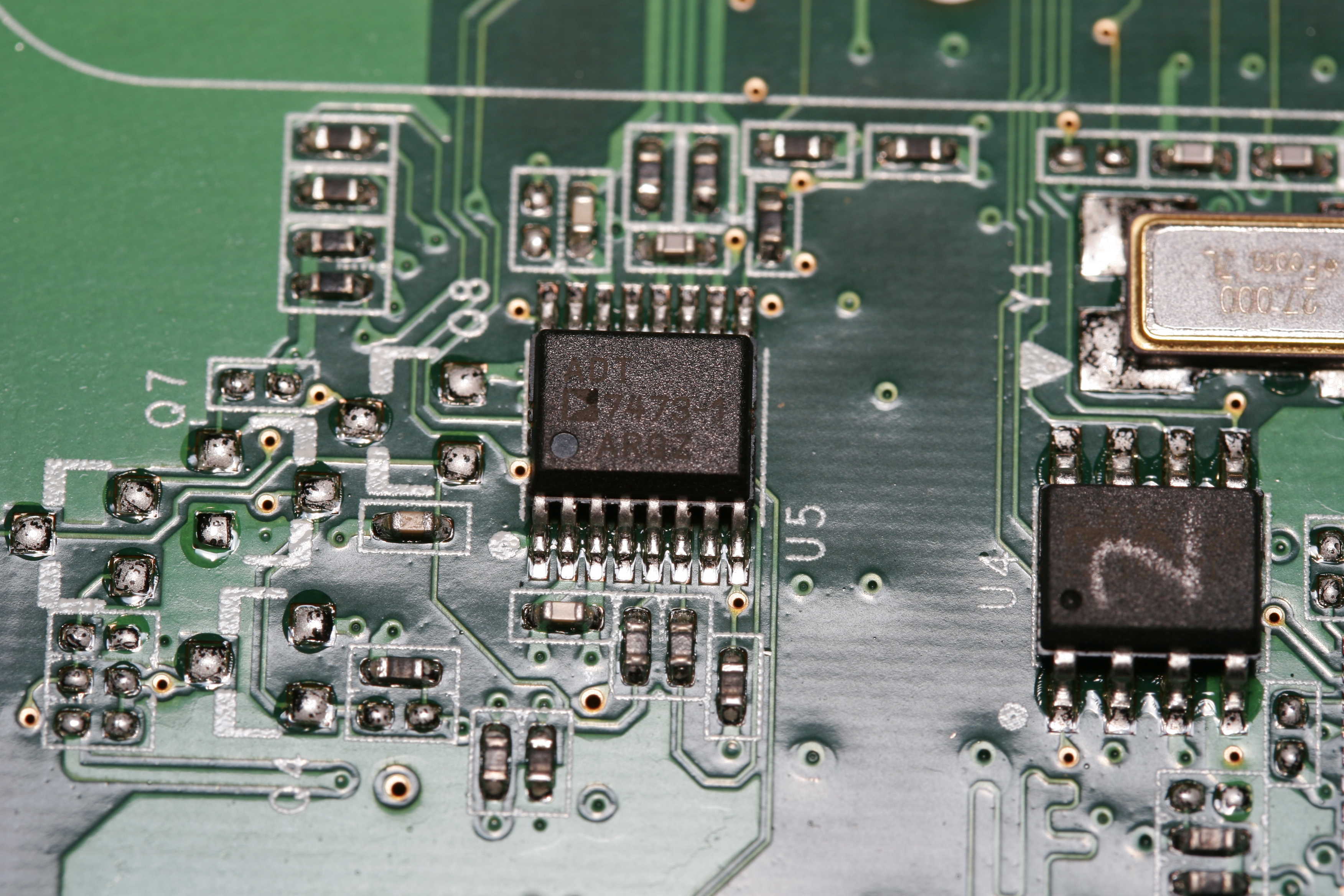

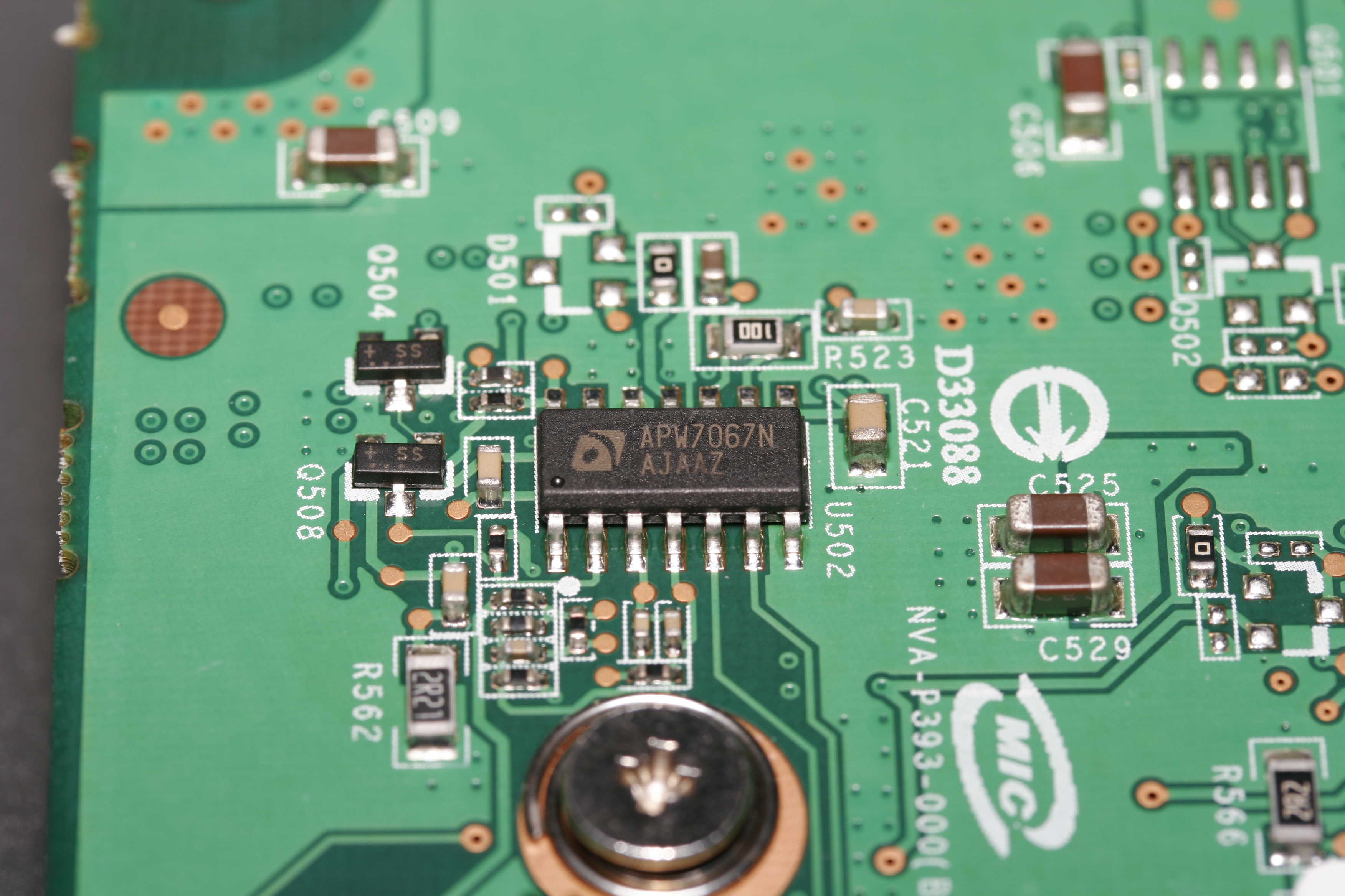

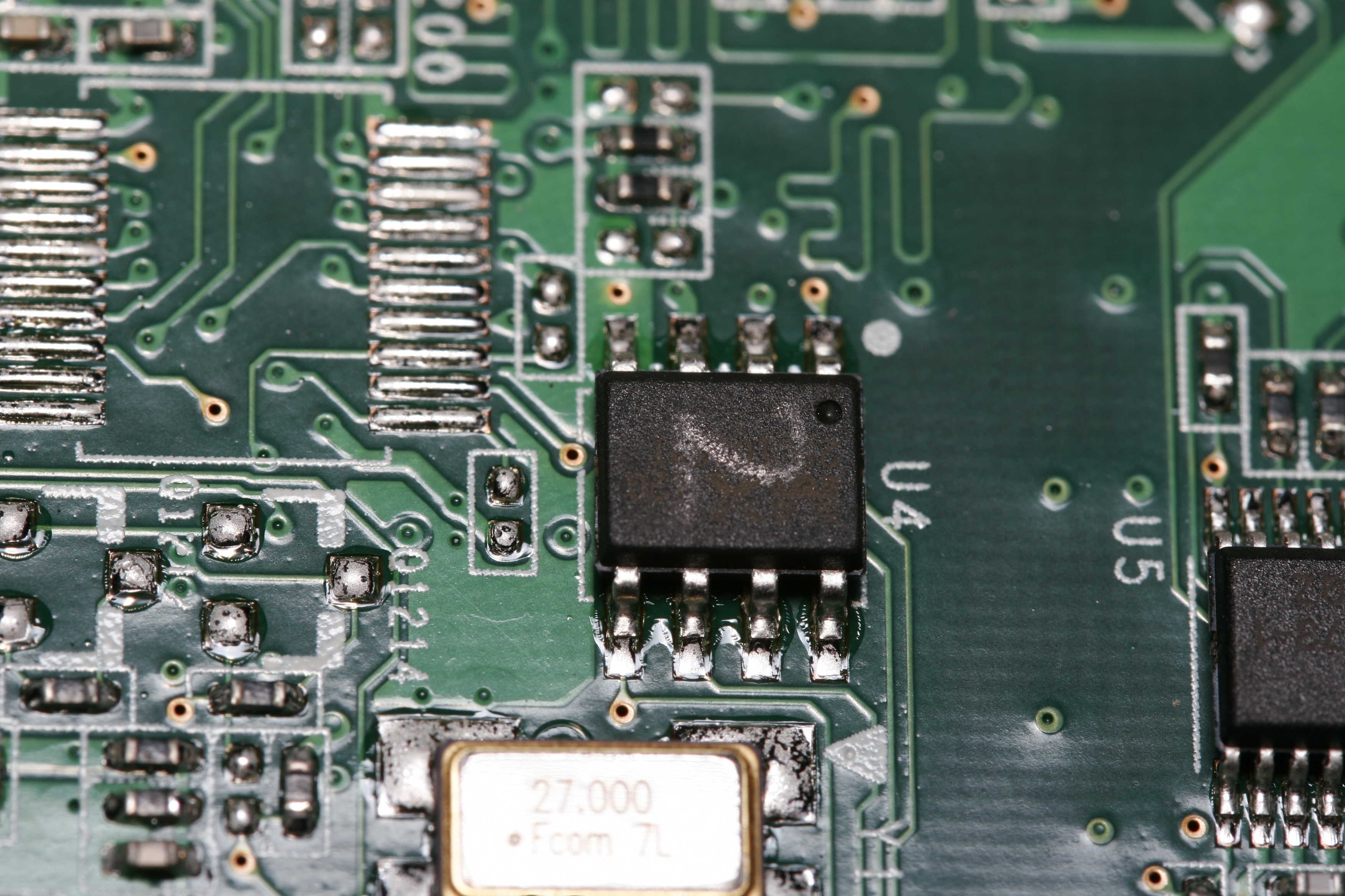

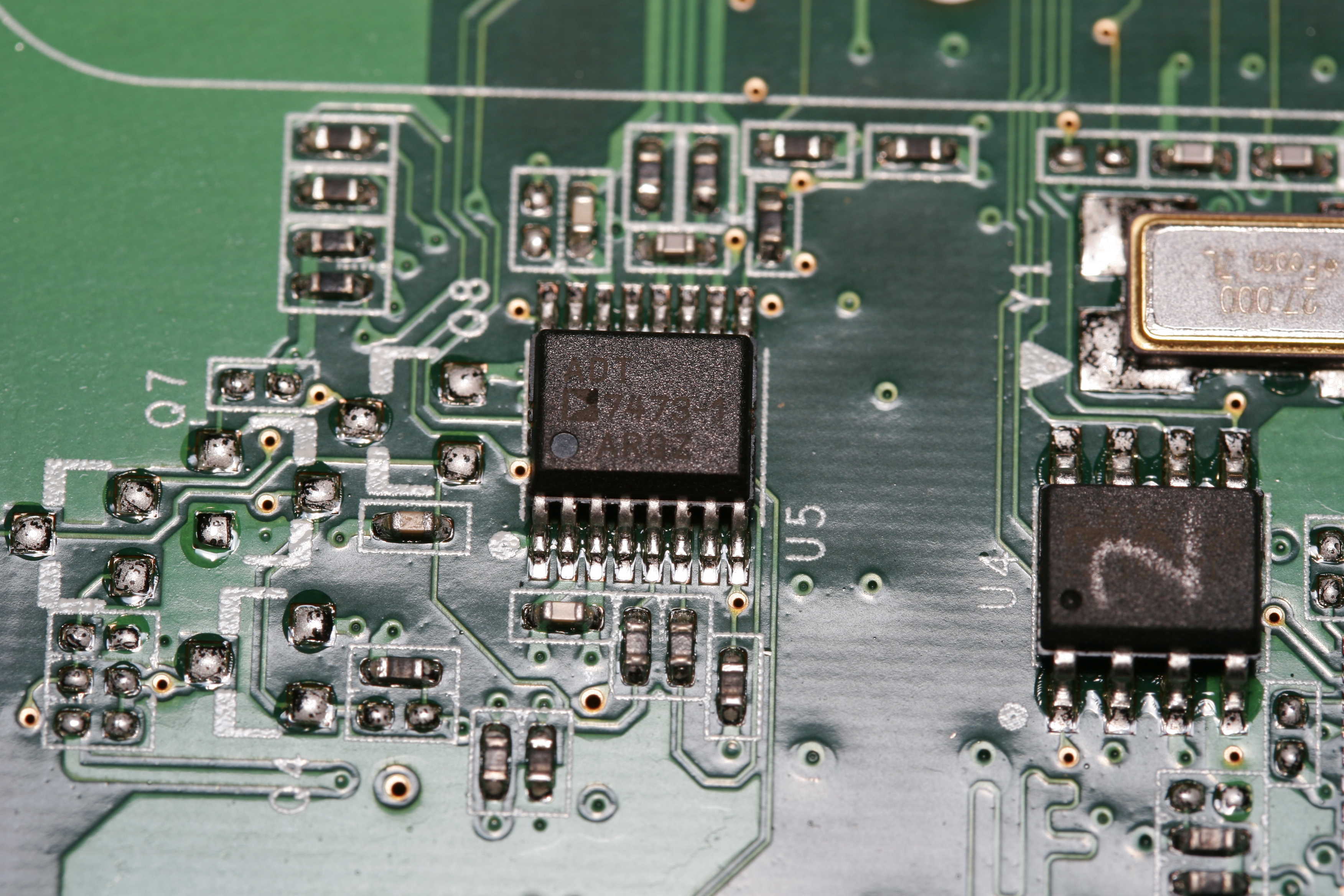

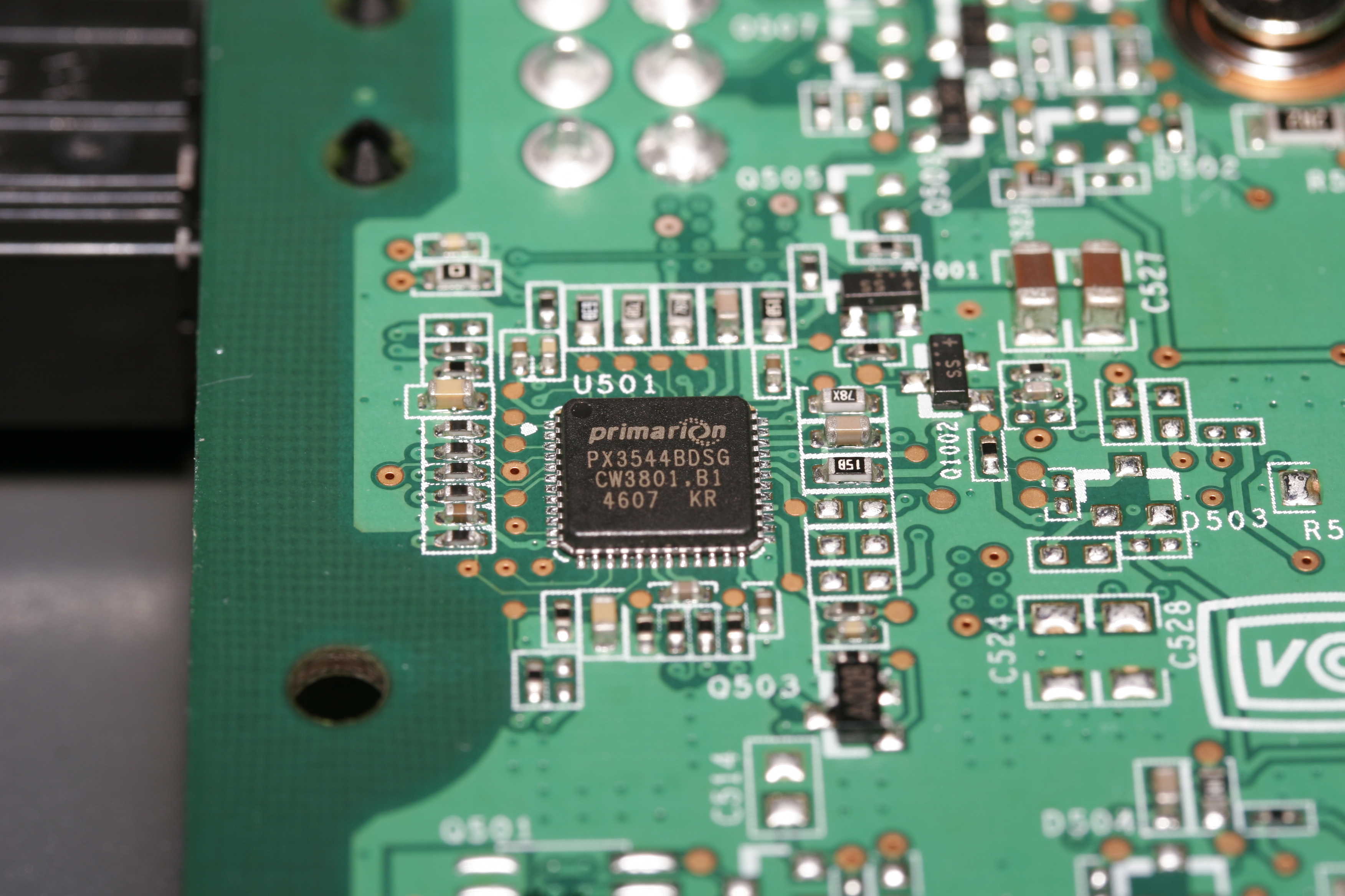

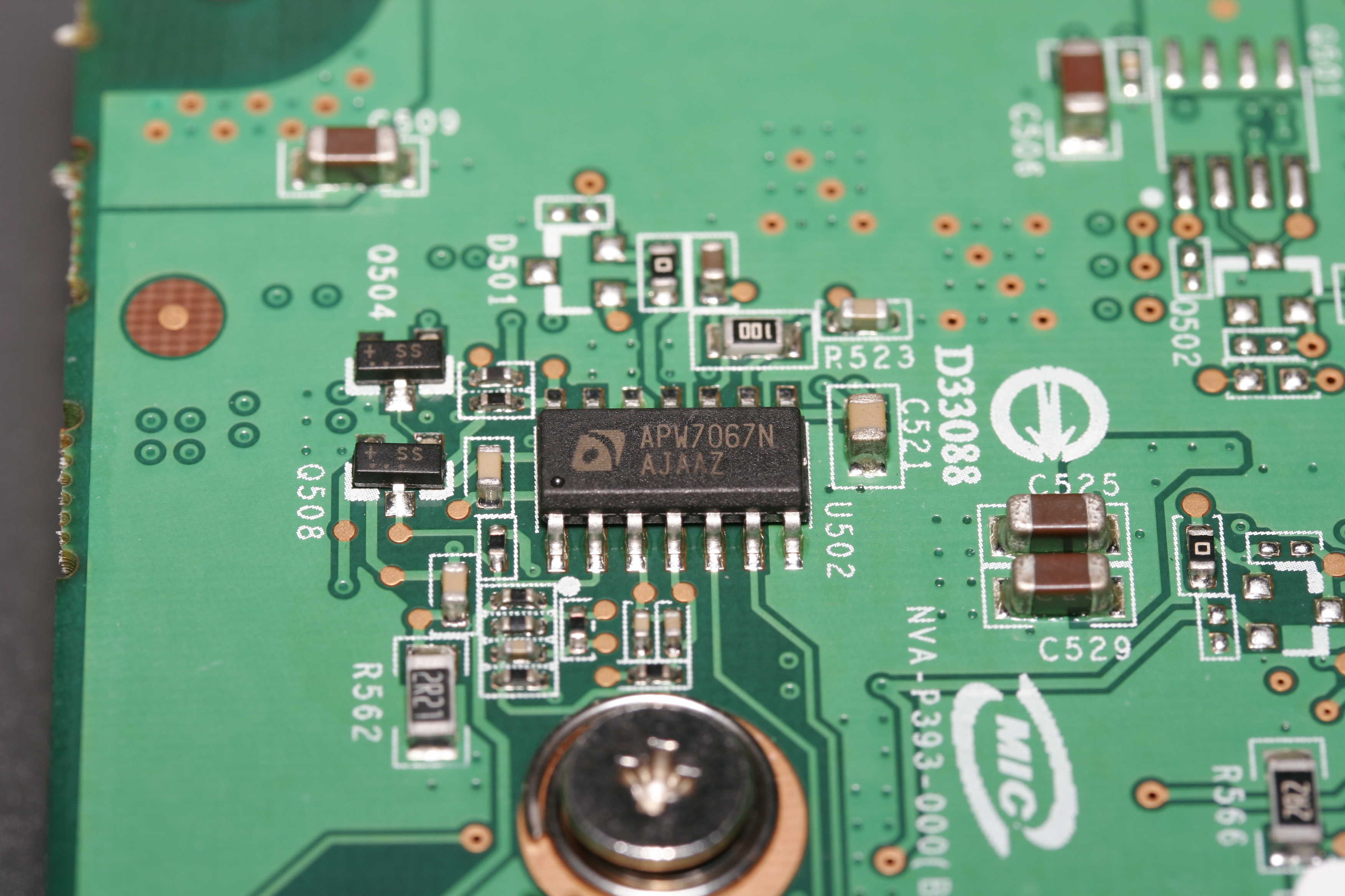

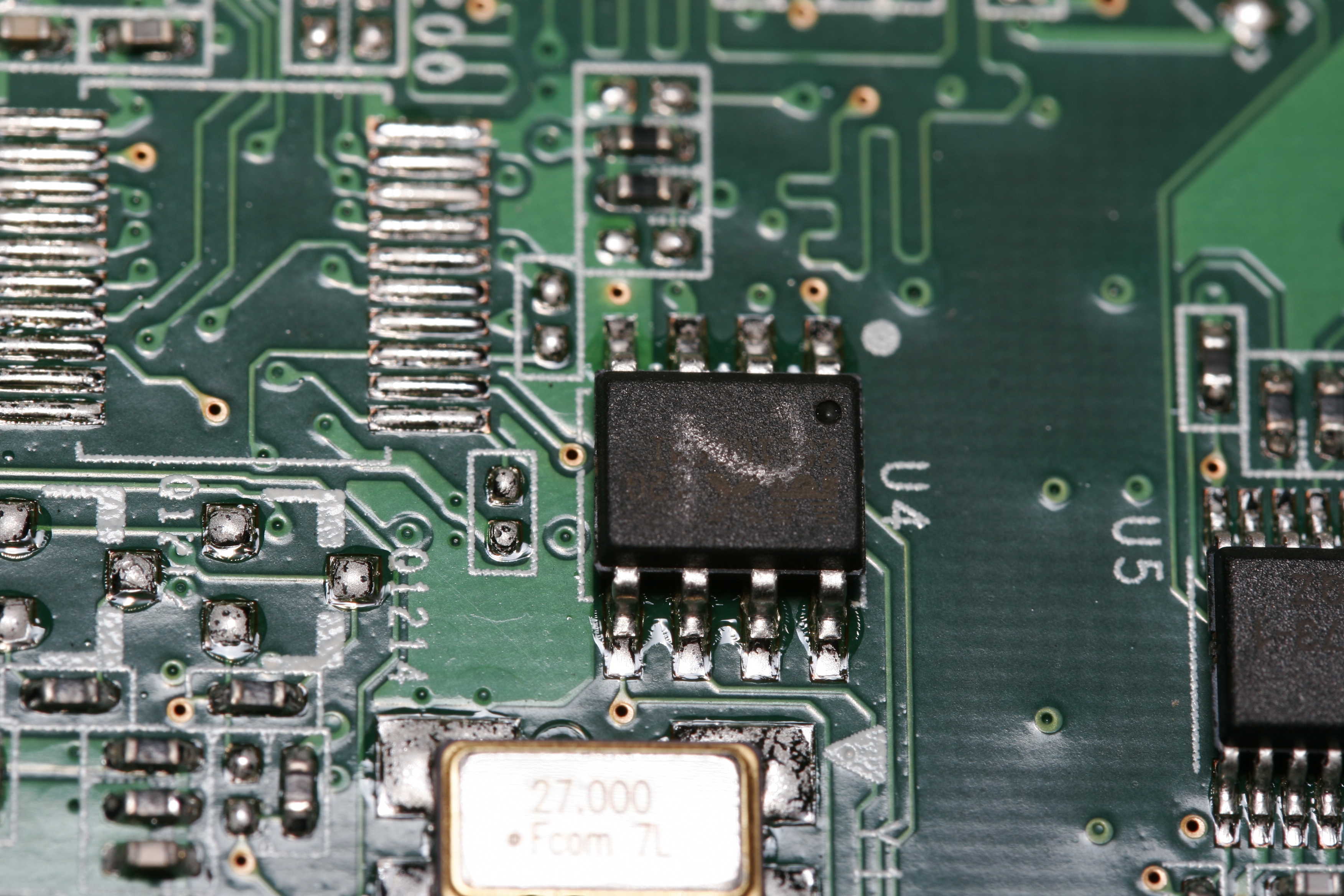

Pictures as requested, not sure what you'll tell by looking at the PCB layout, but I included closeups of each chip that might be the flash...
Second set of pics...

Please Help. could you run freedos , and type in NVFLASH --list
it tells what kind of EEPROM CHIP you have on the E-vga card !
Did a nvflash --check and got back:
EEPROM ID (C2,10) : MX 25L1005 2.7-3.6V 1024Kx1S, page
1024Kx1 = 128Kx8, so looks like I got a 128K flash. I preserved the original flash image, and it was only ~55k. eVGA didn't need the 128K, but I'm happy🙂
