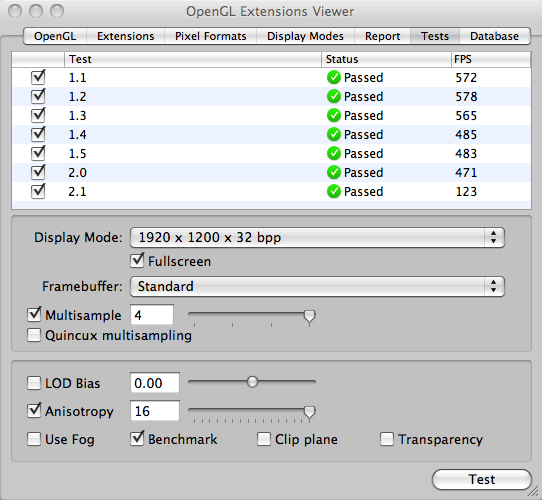

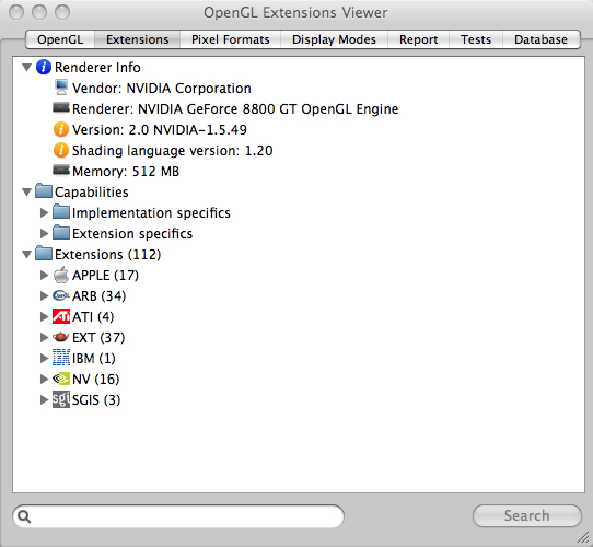

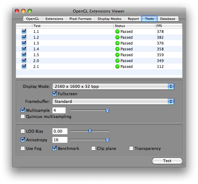

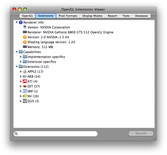

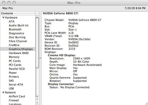

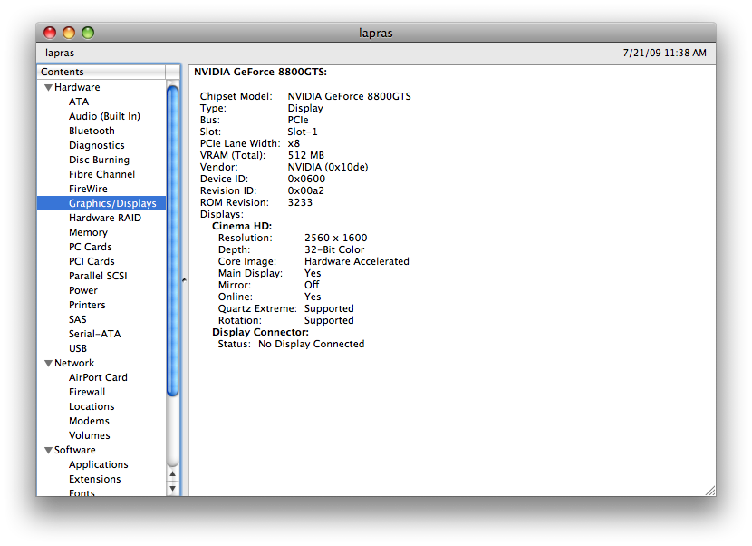

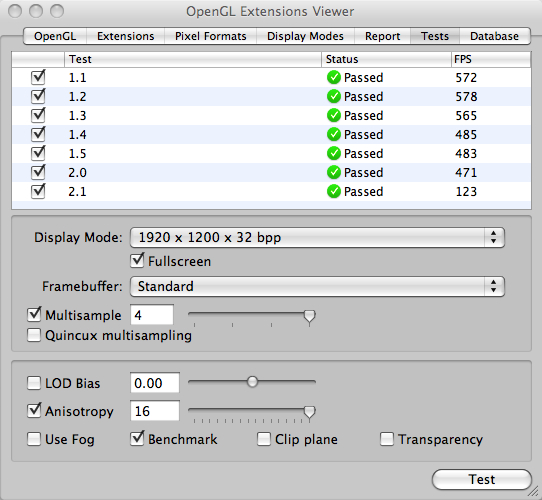

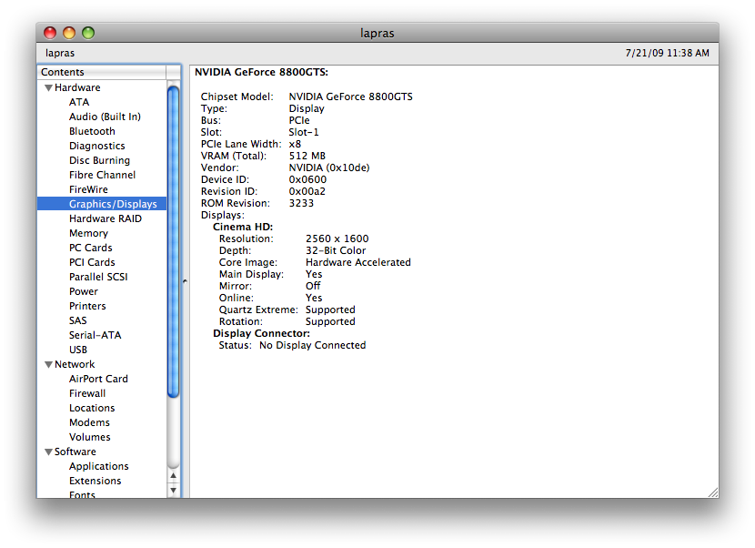

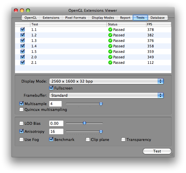

Can you post the following screenshots to verify that the new device id "took" and the card is properly id'd. (Can also grab a Rivatuner screen that shows pipes, etc. I'll grab one and add here)
Glad it worked and thanks !!
I've attached the screenshots from OS X - I don't have a Windows install on this machine. This is a Macpro 1,1 with Dual 2.66 Xeons, 4GB ram.
Regarding the PCIe issue, It doesn't seem to matter which configuration I choose in the Expansion Slot Utility. The GTS always runs at 8x, and OS X always gives it a status of "Running at Maximum Speed".
Collected some more information on this:
As I mentioned before, this same card flashed with the EFI32 GT ROM, runs at 8x in this Mac Pro.
This same GTS, flashed with the EFI64 GT ROM, runs also at 8x in a Mac Pro 3,1
Looks like there's something up with the card?
